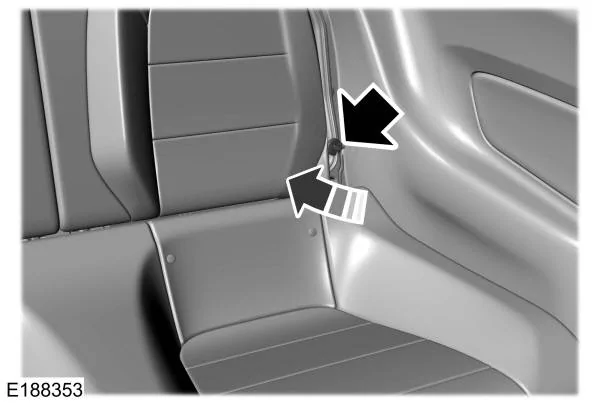

I'm assuming there must be something wrong with the electronics, a fuse maybe? There is a manual release for the convertible.
Unlocking the Luggage Compartment (Convertible Only)
If the power decklid release does not operate because of a discharged battery, pull the rear seat left-hand side seatback cushion aside, insert the mechanical key blade into the key slot and turn the key to release the decklid latch

Are you guys talking about the trunk? If you are I didn’t know the manual release from inside the car operates through a fuse. I would’ve thought it’s a cable. It would be nice if the trunk had a keyhole for these situations.
Cpl0313
Feb 1, 2020
Dallas GA
Jason
2019 eco boost convertible
The convertible has a keyhole. It’s beside the drivers side rear seat.
