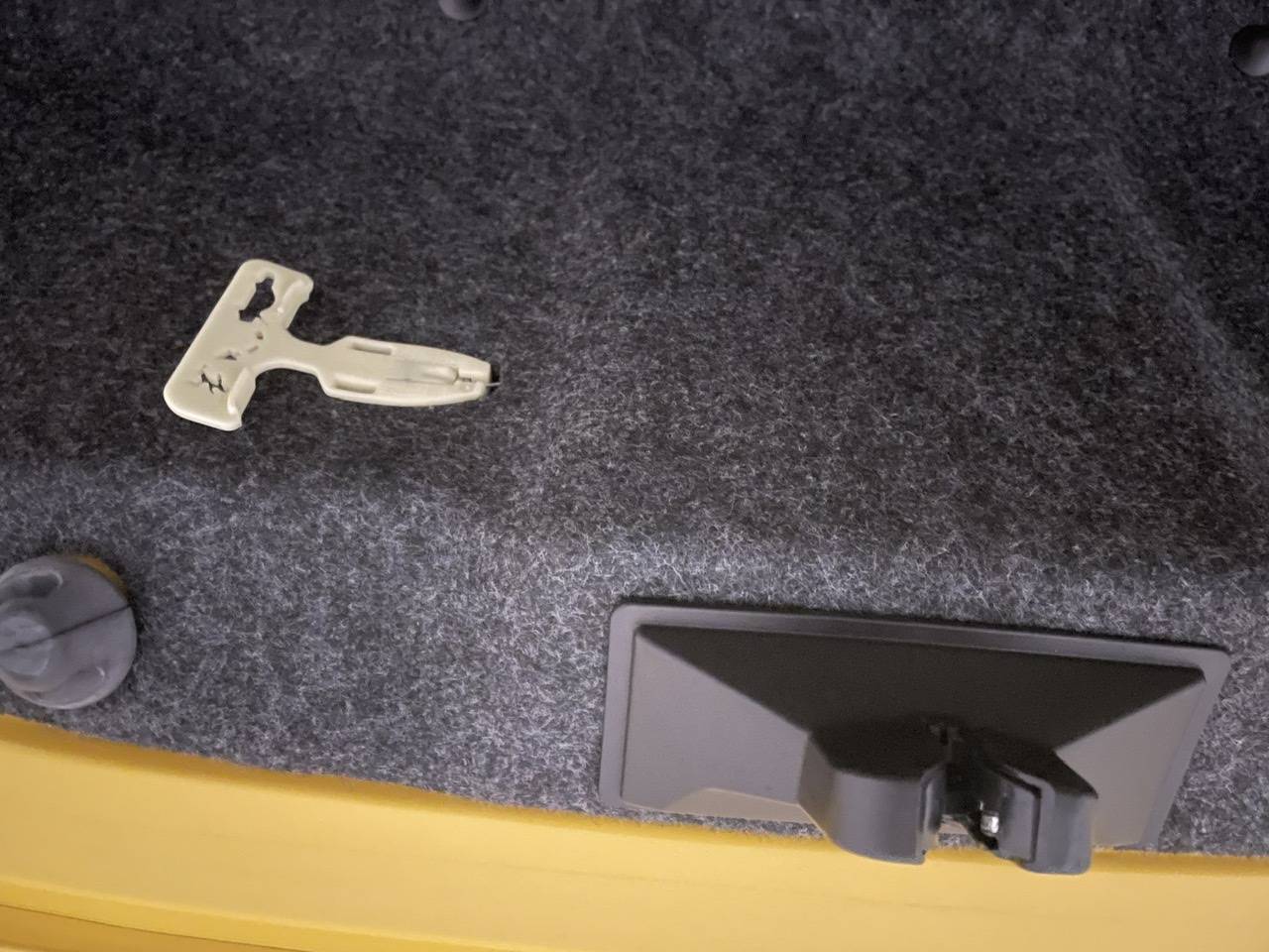

For reference: here is the location of the release handle on my '16. It's on the passenger side. If that's broken off and the cable has pulled in behind the liner you should be able to pop the plastic clips out of the liner and bend it down to find the release cable.
