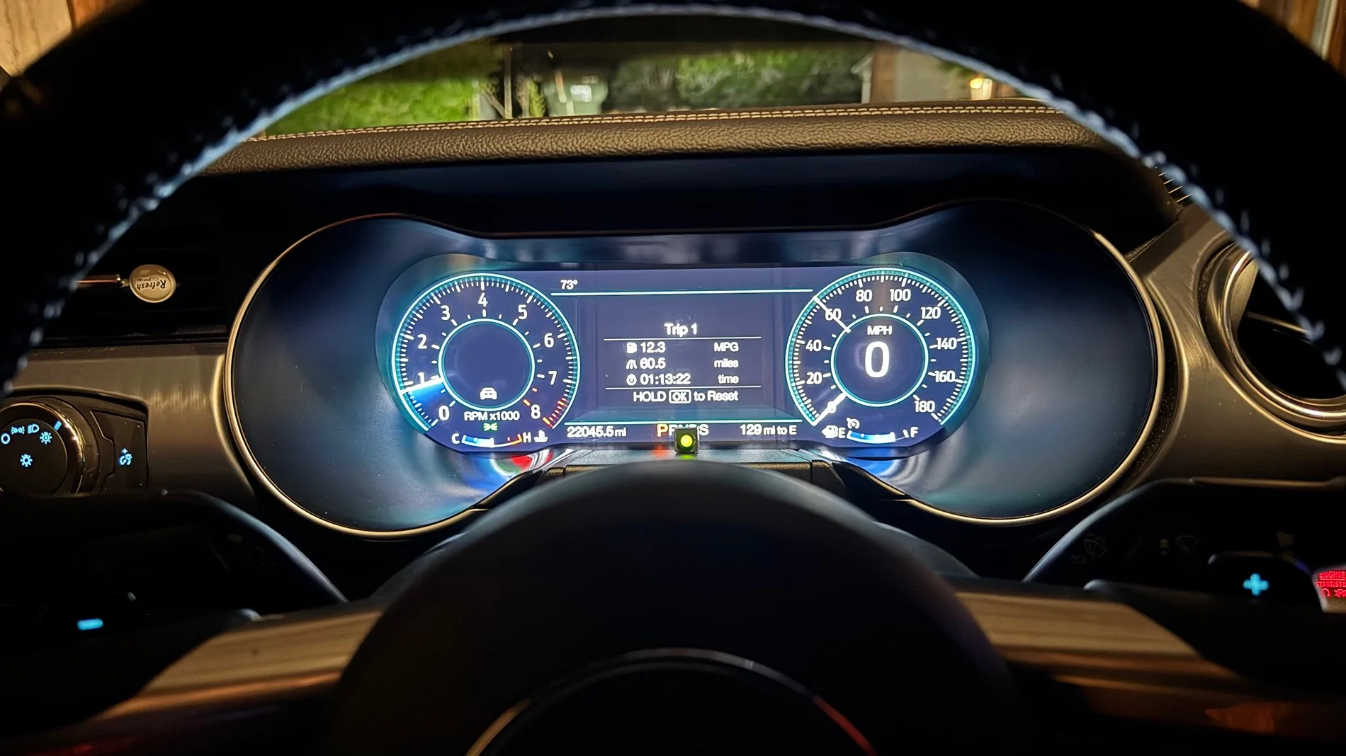

...So how bad is your fuel mileage? My NA Mach 1 w/ Tremec is at 10 mpg and my son's NA 2022 GT w/10R80 was at 15 mpg. (Both Wengerd E85 Tunes) I'm hoping to get my car on the track, soon, so I suspect I'll need plenty of refills.
Just did ruff calculation of the MPG. After filling up and driving 60 miles and using nearly a 1/4 tank of gas (4 gallons).
This was with spirited driving (90mph) on the highway and a little city driving.
You can’t really trust the Miles to Empty because it seems to calculate the worst case scenario but when it says zero, you better within a half mile of the gas station down hill.

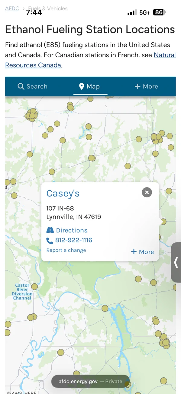

You mentioned you live in the Midwest. Which part? I’m in Indiana and E85 is plentiful around me. I forget sometimes other states don’t have it so readily available.
The only minor difficulty that may arise is driving out of town to visit family, but I have stations saved along the way. My fill ups are about 230 for a full tank.

Scott AFB in Illinois on Hwy 64, there is only 1 E85 gas station near Hwy 64. If you’re driving to Indiana, you have about 170 miles to get to the next one. If you have to hit a detour driving that way, this could be unfortunate.
If you don’t live near either because your in the middle, you better have jugs. If you run a Flex you wouldn’t have any problems.

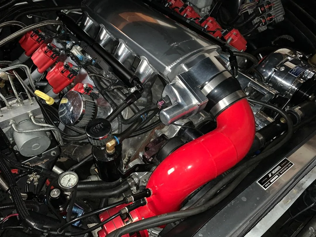

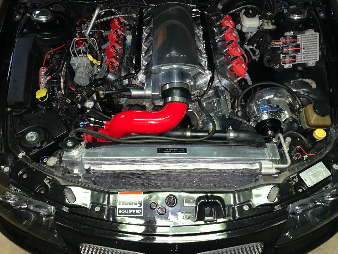

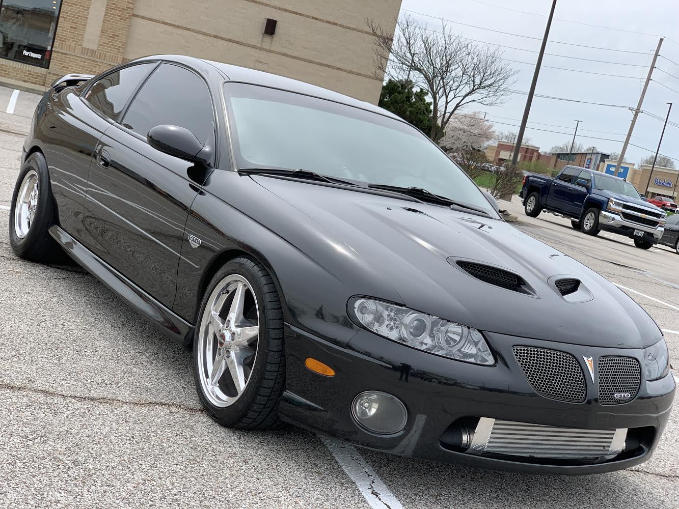

My old Pontiac GTO had a 447 LSX (7.3 liter, 10:1 compressionwith a F1A-94 Procharger making 1000rwhp on pump 93 and two 1000cc nozzles of methanol on a map. Full power all the time on a RPM Transmission fully built T-56 and RXT Twin disc.
Twin AEM 1000cc Nozzles above the Big Red Blow-Off Valve on the left. All custom piping.
Most didn’t know what hit them when I’m riding thru your city from out of town and you try the GTO thinking shit is sweet. Those were the best times around 2009-13. Drive all the way to Bourbon Street from the Midwest tune on kill!
