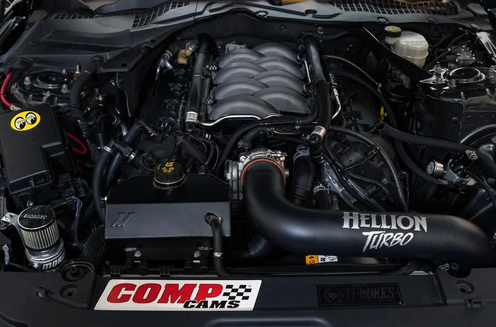

First procharger
Now turbo

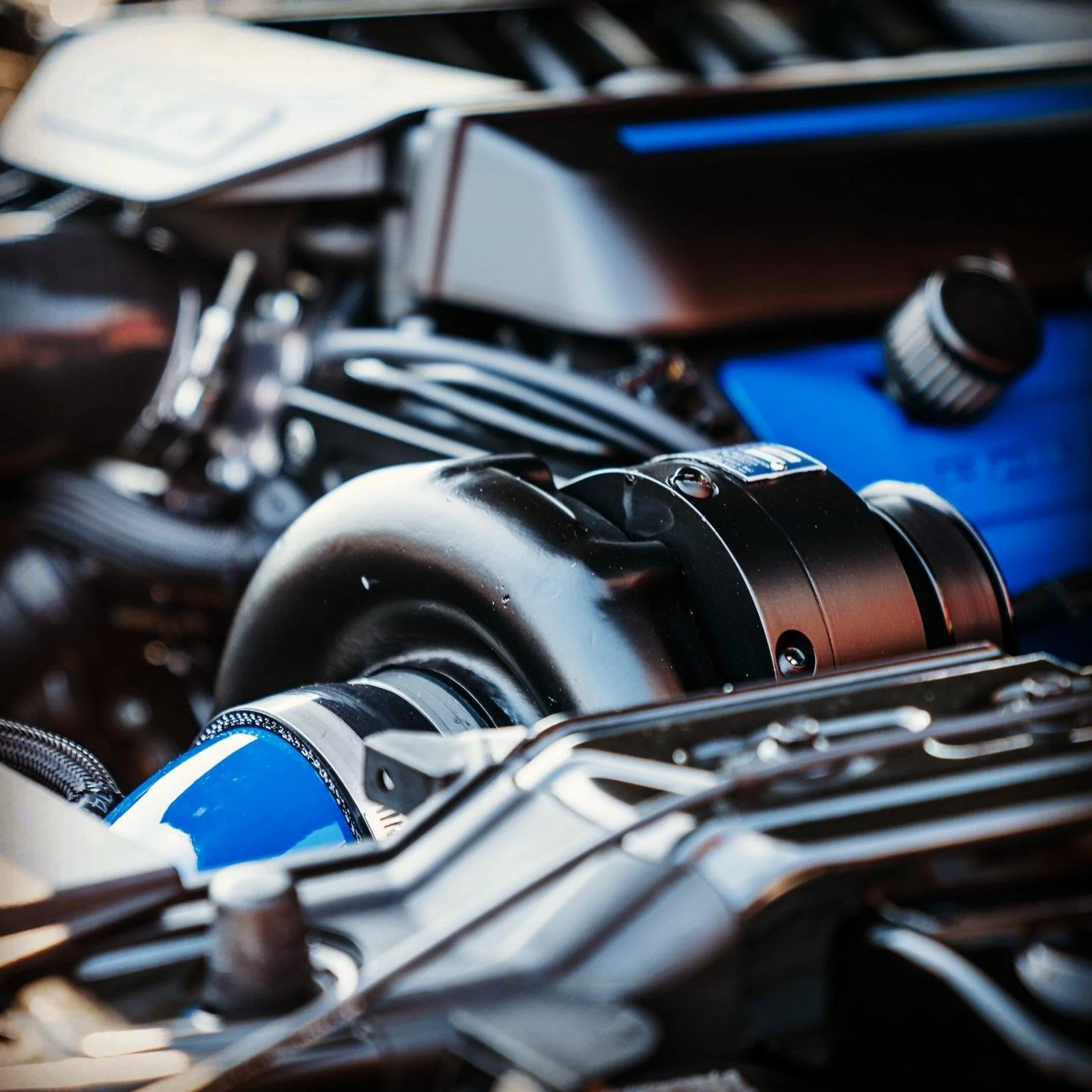

Screamer covers. They make the spool sound way louder and slightly increase spool speed (unconfirmed).
You can hear the difference in Chase's (VRP) video. My car (white car) has screamer covers and his has the standard compressor covers.
damn they sound sick!! looks like im ordering. what webpage did you get them from? or did you just email hellion and purchased from them

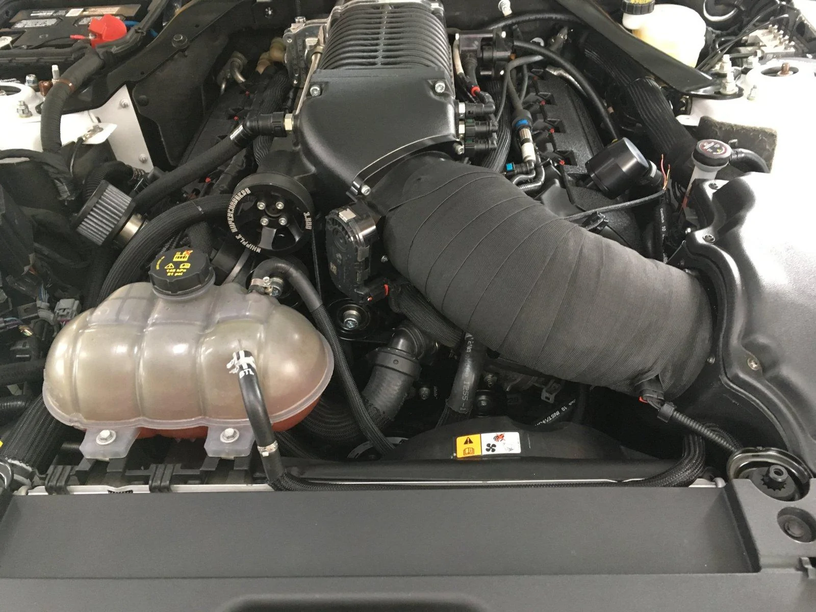

Gen 3 Rotors in a Gen 2 case. 10 Rib and E85. 15psi.

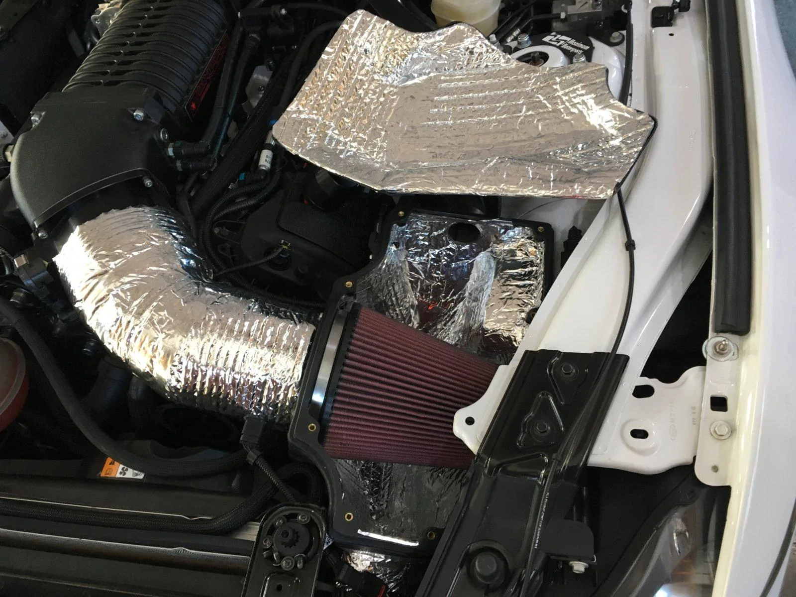

Custom made closed and insulated airbox inlet with Ram air setup.

Does it make a difference to your IAT2 temps?
Huge difference when driving under 30 MPH and at idle. My inlet temps take 15 minutes at idle to rise 10 degrees now compared to 60-70 degrees above ambient before. Sucking in engine heat well just plain sucks.

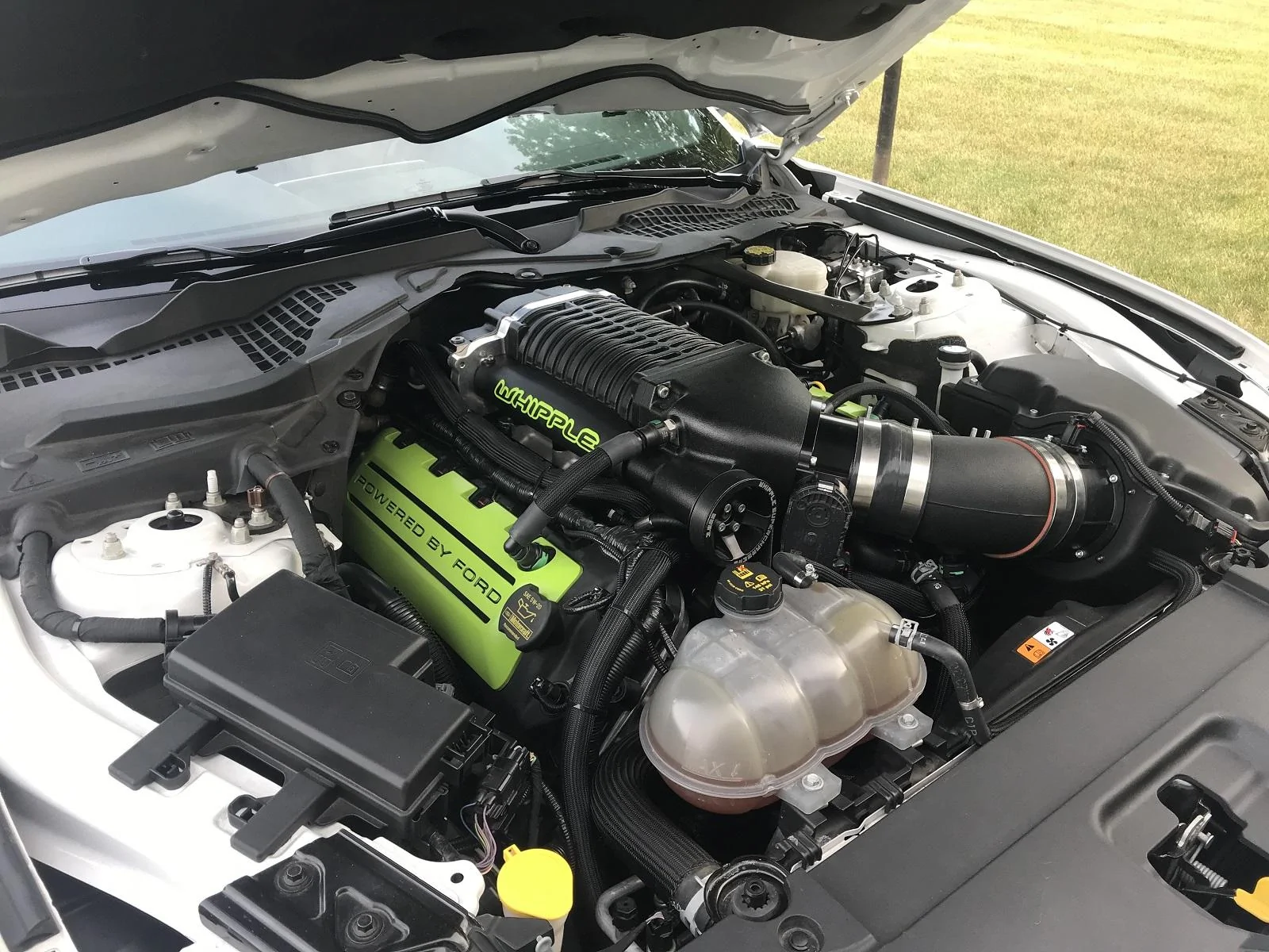

Just finished this evening.
Just need to install the BAP.

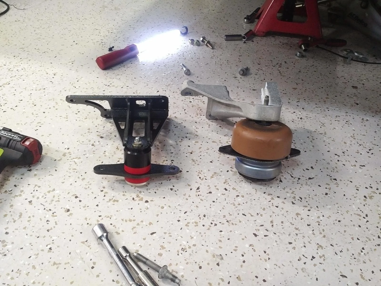

I believe BMR makes everything you need to do this now. I used a motor mount bushing kit from Steeda to I believe.
