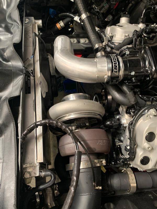

Hey guys!
Finally got my car back together and running. I am waiting on a track day to take it out and start pitting some power into it.
I am having 1 issue.
I have an aftermarket expansion tank and when the car is running the upper radiator hose feels normal, however once I shut the car off it continues to build pressure. The hose will literally start to expand until it finds a weak spot to leak fluid. I replaced the radiator cap thinking it was defective but the upper hose never get soft after the car is off, even after the car is completely cool. If I start the car, the hose just gets harder and harder. If I leave the cap off, the hose NEVER gets hard. The car maintains between 185 and 195 when running so its not overheating. Yesterday about 4 hours after I shut the car off it started puking antifreeze out of my top hose at the clamp because so much pressure had built up. Any thoughts? It's pissing me off!!!! I am thinking if it was a head gasket it would build pressure in the system pretty quickly.

Looking at your pictures , I would look at your vapor lines . The line from the radiator I would think should run back to the expansion tank . I wouldn't think they should be tee together at the upper radiator hose housing on the left head .

Yes . I had it running to the water outlet. Both run back to the expansion tank. Anyways... ordered another fitting, and I'm going to run it straight to the degas. I also had the passenger head running to the degas and I think that might have been bad idea.
