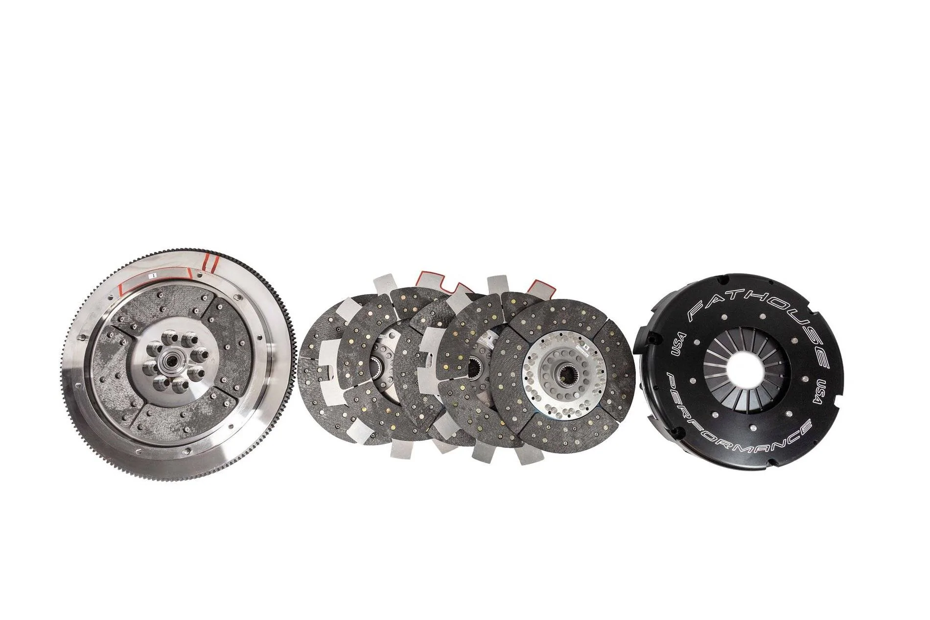

For all of you boosted GT350 owners who are looking to upgrade your clutch! TODAY ONLY save $500 on the RPS Triple Disc Carbon clutch for the GT350!
