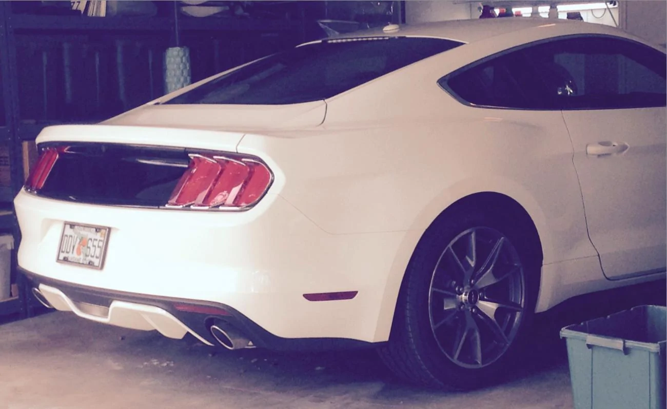

Got the plastic trunk panel to align by removing the mounting tabs on the top half of the inner panel. Unfortunately, there is so much glue holding these together that I cracked the outer panel. Decided to use it as an experimental panel after that. Shaved off the upper lip that snugs up against the trunk. Went to the Fantasy of Flight "Mustangs and Mustangs" meet last weekend
and needed a new panel. Ford wanted between $900 and $1060 for the various versions. Bought a blank panel from Ford Racing for $139. May try to design my own LE Badge, due to the Appearance Package being the same badge. Will decide later whether or not to drill the panel for the original one.
Because the new panel is not shaved and modified, it sticks out and down further, so I had to go back and shim the tail lights to match the panel. Not like I want, but from a couple feet back, it's about as good as any. Don't want to cut up the new panel just yet. The trunk lid aligns with the fenders, but because of the assembly and stamping problems, it will always be higher than the fender on the flat on the left, and lower on the right. Will have to bend the left and right edges to match the fenders. Probably will wait to get a new trunk lid to do that on, and weld-in tabs over the lights at the time.
Tried to do something about the doors. Although you can fix some of the problems with the front fender, the door is out of alignment with the rear quarter and upper. Loosened the black nuts holding the door on and tried to shove it outward. Took out about half of the problem. Also moved the striker plate as far as it would go and got the elevation and rear alignment pretty good. However, the door is still rotated on the lower hinge and the window does not line up with the quarter glass. Bottom of door needs to come out more and glass needs to go in. Tried to shim under the two-bolt hinge bracket, but that just ended up rotating the bracket and pushing the door into the fender. Just not enough room to work on the thing, so will have to pull the fender to get access to the hinge where I can remove it and shim properly. Will also give me a chance to align the hood, bumper and fenders.
