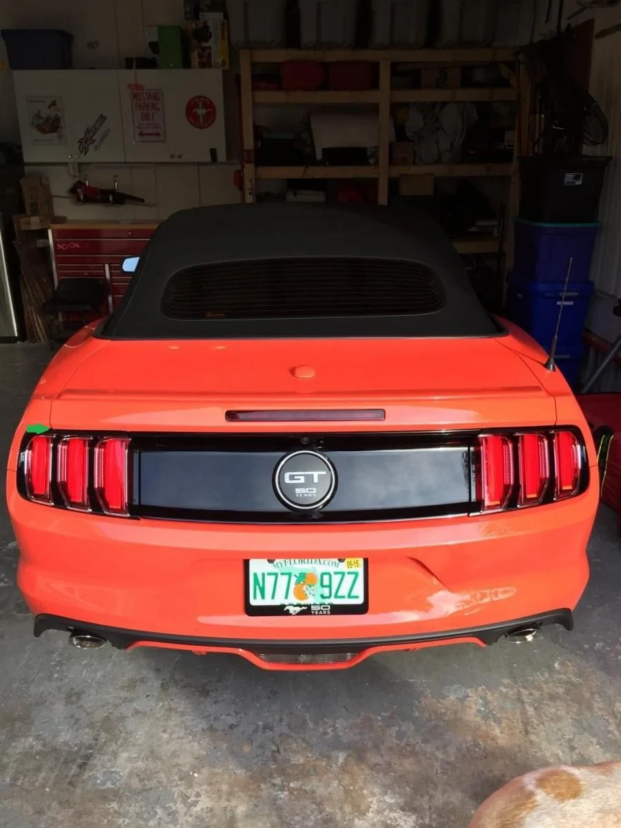

Plastic alignment on the trunk lid is pretty good, about the best I've seen. The left Trunk over the lights looks a little low. May be the lip of the trunk, because the reflections on the bends look aligned. Trunk may still be a little low on the left up by the window.
Bumper on right is aligned on the outside, where it should be aligned with the quarter panel on the inside, like the left side, as the bumper is designed narrower than the quarter panels at the lights.

I did turn the picture for you and point out the left corner of your trunk lit. I am not pointing at the poor quality of the roof installation at all. :doh:

I opened a case with Ford Motor Company and have an appointment on Friday at the body shop for them to take a look at the issues with the automobile. This morning when I was taking my garbage out I noticed that the top and back window are again crooked, after being repaired at the body shop last week. I'll post a photograph for everybody to take a look if you look at the bottom of the back window and the top of the roof you'll see that both dip on the left-hand side.
So after the fix, the window looked level to you. Then several days later the left side dropped to it's original (low) position? I'd be very curious if they are willing to say what they did to 'fix' it the first time. And the plan for the second.:frusty:

Most of the Fast Backs have a left side window drop and the Vert just didn't want to miss out on the action!

Holy crap, that is awful. What did they do, build & ship the car with the top down?? How do you miss that in QA? :doh:

No kidding. That is disgusting, its like a clown car with that window.
I just got my car back from Ford bodyshop. The dealer fixed the passenger fender out of alignment issue to my satisfaction - this was the worst part. There is still a moderate gap in the left side of the trunk lid (but its more even now) where it meets the rear haunches/rear quarter panel and not sure if they forgot to fix the gas cap protruding slightly.
My hood still has that slight raised right and left side (center is aligned) but its much better after I tweaked the knobs under the hood - def nothing that stands out and not much can be done anymore other than major surgery (which the body shop and I dont want to do) as the stoppers are at their min settings. I'm also lucky my rear window/backup light is fine and the doors are pretty much fine (VERY slight differences in gap between right and left).
According to my dealer Ford regional engineering rep (they work with him) is dealing with a crises here in the Pacific NW on the Mustangs - they have had a FLOOD of complaints from clients about body alignment issues and a ton of missed sales because of that. They said out of ALL the Mustangs they've received, only one (a Vert) was perfectly aligned. Apparently the dealers are pissed and Ford is aware of that - but the tooling is not upto snuff as the S550 is way more complex from a design perspective than the S197 (which had the same issues but it just didnt show as it was more slab-sided) and their robots/hand assembled parts cannot maintain the correct tolerances. I dont know what their solution is.
