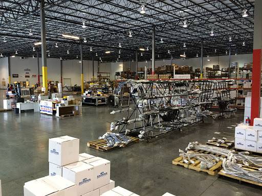

We have had great success with the Steeda Rear Braces - validated on the track & at the strip, you won't be disappointed.
Also, they are made right here in the U.S.A. in Valdosta, GA & backed by a lifetime warranty - win / win!
A good amount of customer testimonials & feedback on 6G - you can't go wrong :)
