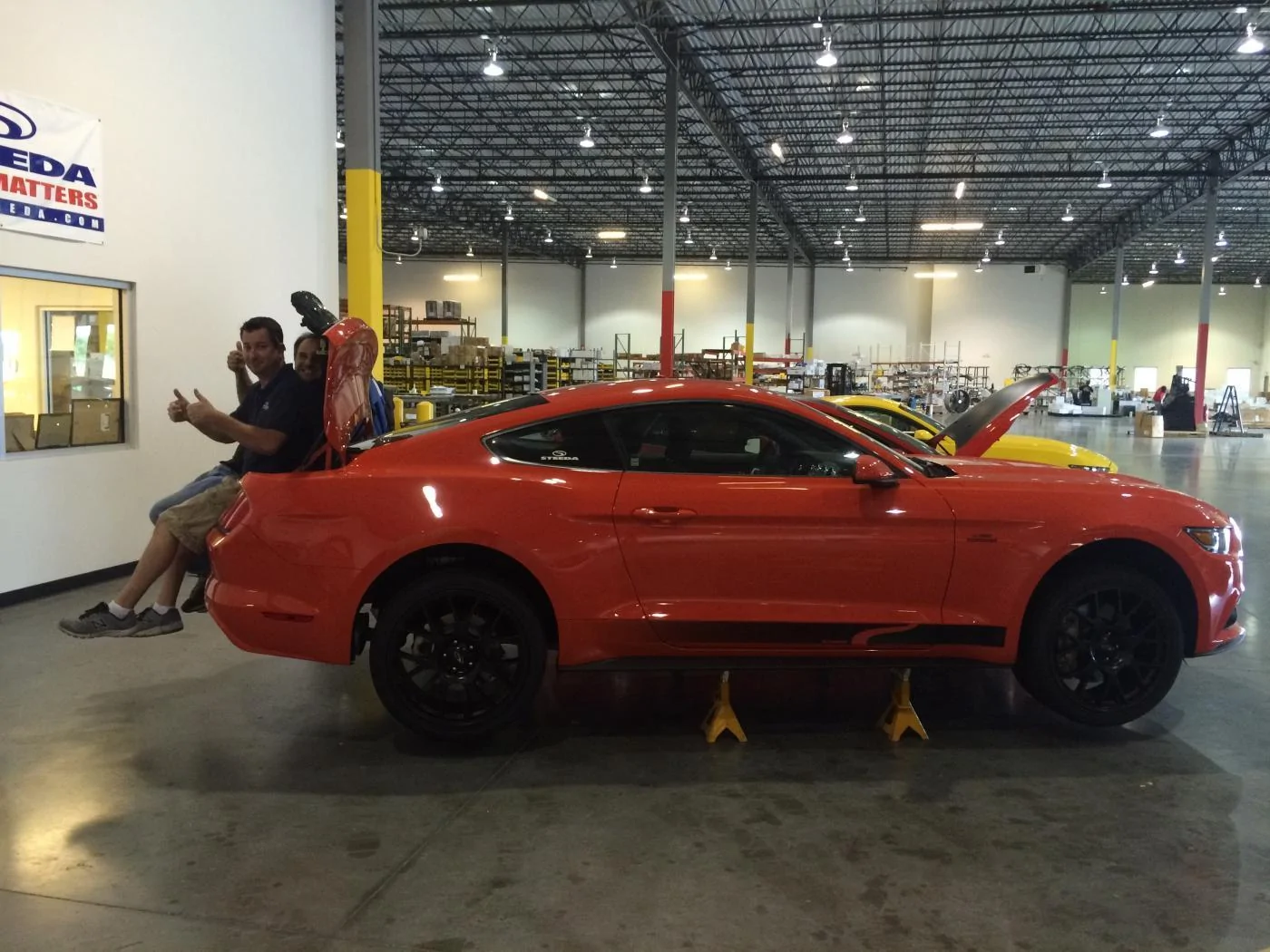

We found that right length needed to support the vehicle safely, as proved by our image in the instructions with two people sitting in the trunk of the car.

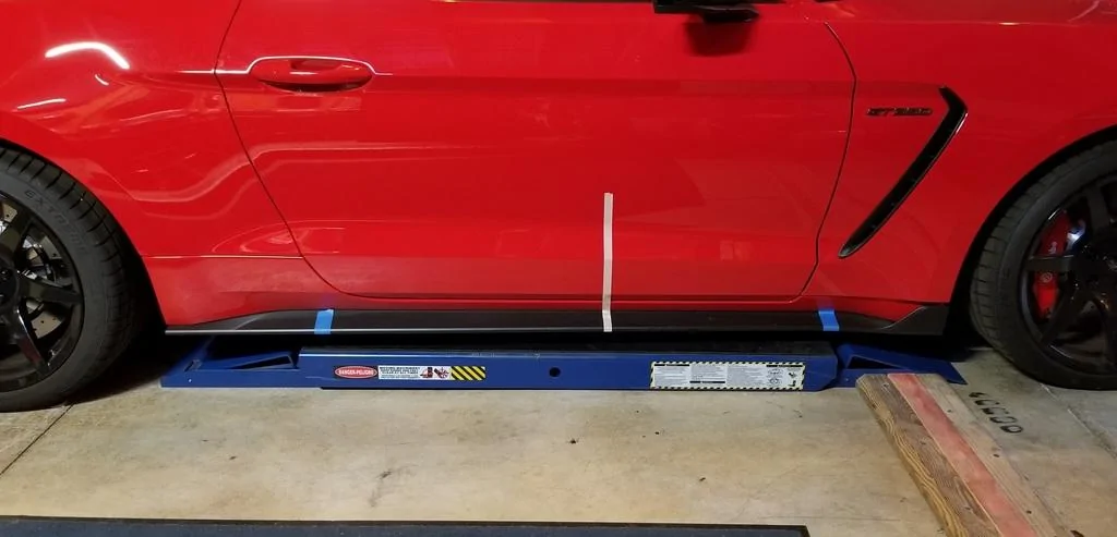

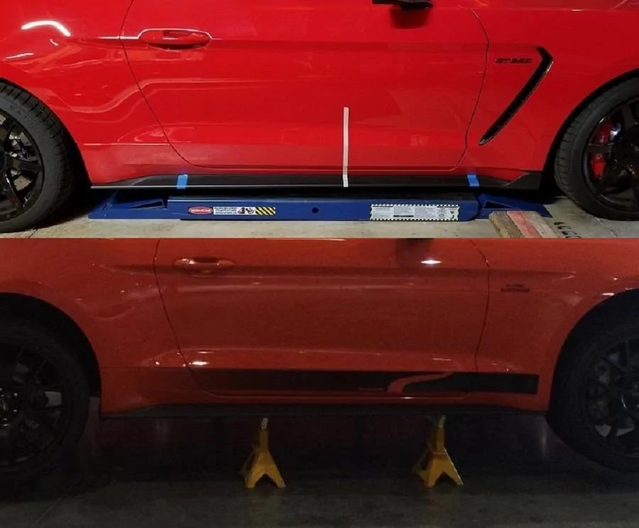

First, some math to determine the Center of Balance of a typical S550 GT350. I pulled some real world, scaled weight numbers from Terry at Vorshlag. He weighed in a barren GT350 (with a full tank of gas) at 3,798lbs. He weighed each corner simultaneously. Front axle weight came in at 2,040lbs and the rear axle at 1,758lbs. I then went out and took some dimensions from my own GT350. Front of the vehicle to the front axle centerline comes in at ~34". Front of the vehicle to the rear axle centerline comes in at 141.1" (S550 wheelbase is 107.1").
Total Moment calculation from the above data:
(2040 x 34) + (1758 x 141.1) = TM
(69,360) + (248,053.8) = 317,413.8
Moment divided by Gross Weight = CB
317,413.8/3798 = 83.57"
Measuring from the front of the car towards the rear, 83.5" gives you the center of balance on a GT350 with a tank of gas. I did just that on my own car and used masking tape to indicate as such. I also added blue painter's tape to show where the rails I have on my own car (BMR lightweight units) start and stop. The tape edge closest to the front of the car is where the rails begin and the tape edge closest to the rear of the car is where they terminate.
I then pulled the photo from Steeda showing jackstand locations on Steeda's rails and placed one photo atop the other for comparison.
The stands are placed pretty accurately with respect to the center of balance. That is not a point of contention. What I have issue with is the spacing relative to that center of balance and how the load, in this case a car, is distributed or stabilized. The higher the center of gravity of the load (or vehicle) over the plane it rests on the wider and more stable the base of support is needed to maintain static equilibrium. In the case of a typical Mustang and in the context of what I'm talking about it is probably safe to say they aren't overly tall. But if the vehicle is supported near its center of balance the vehicle will be easier to rotate the about that point. The stands can become a pivot or fulcrum point and therein lies a potentially dangerous scenario. In a perfect would where everything is always static you should have little to worry about. In reality, it isn't always so perfect. So a major shift in weight distribution such as if driveline or engine components are removed, wheels/tires are on/off in the front or back, could indeed be a problem. A moment of force on the more cantilevered end could indeed knock the car off it's respected stands. The closer the stands are to one another the greater the leverage gain at either end of the car, particularly the rear in this example.
A manufacturer cannot control these dynamic, real world variables. And sadly, typical litigation would raise the question...what did the manufacturer do to minimize risk and how well did they understand the potential for failure?

In the image that you posted, we showed two gentlemen with a combined weight of approximately 400 lbs. (although, I think Scott said he was lighter, lol). So it begs the question: How much weight can be added to the front/rear of the vehicle before it is unsafe?
Well the answer to that is simple to calculate. Expanding upon your moment calculations, we solve for an unknown force at the front/rear using the corresponding jack stand as the fulcrum. Using all of the same values you used (to stay consistent), adding in a few other measurements and assumptions (additional lengths and jack stand positions), and crunching the numbers, you get that you would have to add 1168 lbs. to the front or 684 lbs. to the rear in order for your S550 Mustang to begin to pivot.
So where we sat the gentlemen that weighed 400 lbs. you could almost add 300 lbs. more and still be good. For reference, the Coyote engine weighs 421 lbs. and the Voodoo engine weighs 408 lbs. Speaking of which, you raised the concern of a shift in weight distribution leading to a problem. We took the liberty of putting your mind at ease.
If the engine were to be removed, you would have to add 1370 lbs. to the front or 351 lbs. to the rear in order for it to pivot. And these weights are assumed to be at the farthest point either fore (for the front of the vehicle) or aft (for the rear of the vehicle) from your fulcrum, giving the longest lever arm which results in the largest moment.

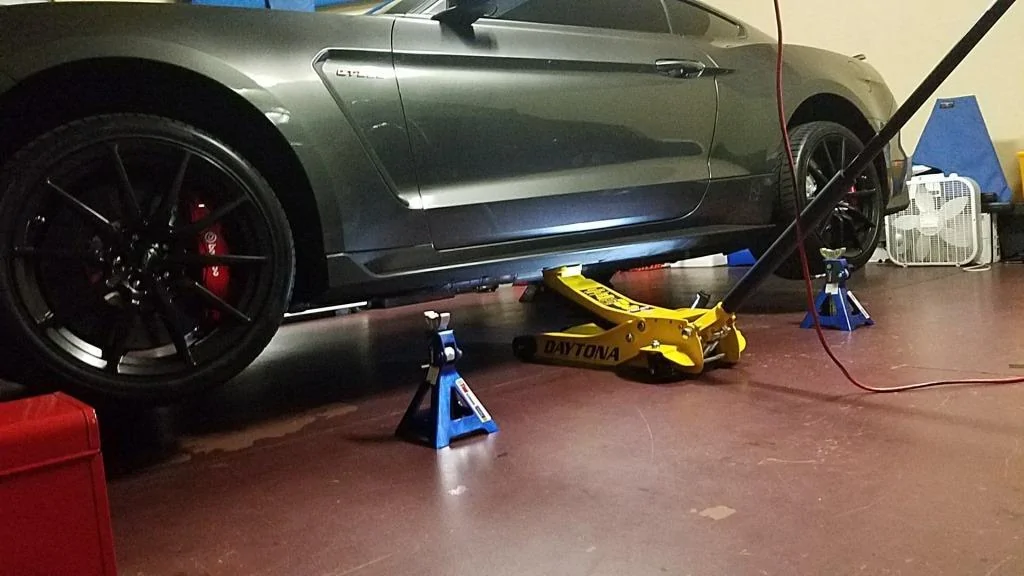

Ok I got the BMR low profile rails in and my only complaint is why the hell didn't I do this earlier. It is so much easier and so much SAFER to jack up the S550, especially b/c my car is lowered and on 30 series rubber.
Jacking up the car on the stock pinch weld is sketchy at best especially b/c if your jack slips you are gonna rip off your rocker trim.
These things are fantastic and the build quality is excellent. Life is sooo much easier.
Thanks BMR :cheers:
...The jacking rails are just that - JACKING rails. In most cases, people do not put the jack stands along the rails and instead elect to position them along the subframes both front and rear, as well as on our patented Steeda IRS Support Braces which conveniently comes with a jack standpoint that actually sits further back than any jacking rail.
TJ, what were the pivot (or stand) dimensions that you used in your math? And how far apart from each other? My guess would be that your calcs assume the widest stance possible with your rails.
I hear what you are saying about what people use the them for - generally. Yet plenty of people put their cars up on four stands that use the extreme rail ends as it closely mimics the factory recommended support and lift locations. Liability, as much as I hate that word and the implied baggage it brings with it, is always the concern and any recommendation which deviates from the manufacturers recommendation can make things very costly.
