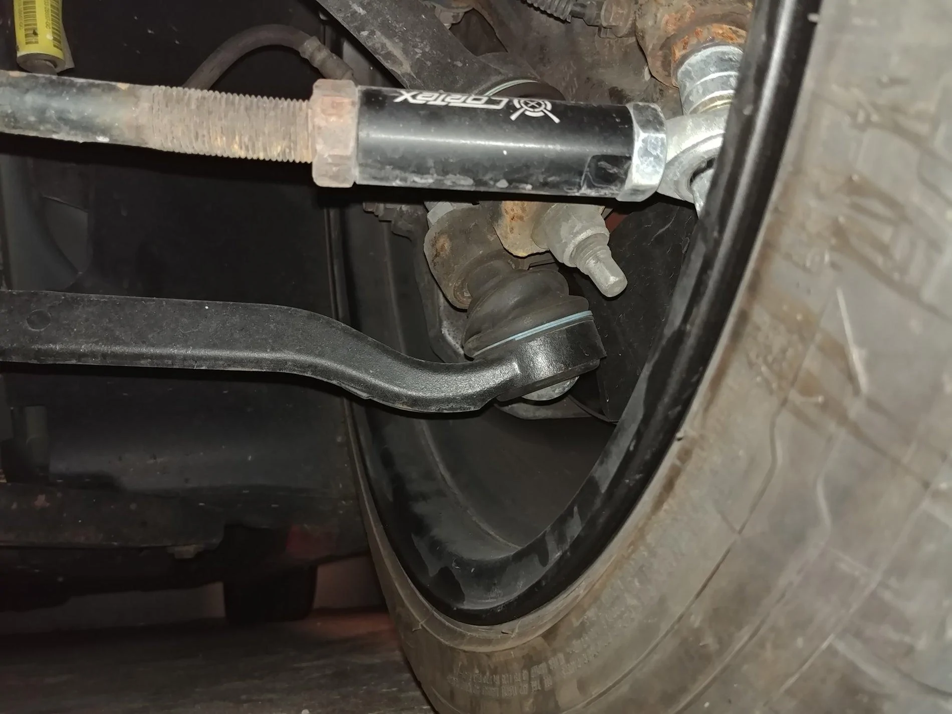

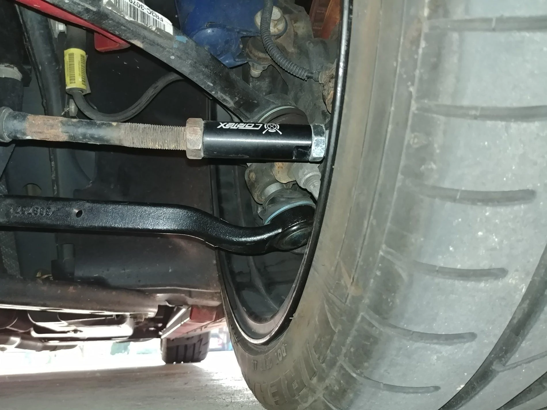

Well, embarrassingly I have to admit that I need to fire my chief mechanic (<----). It dawned on me after a few separate things all clicked together that I wasn't sure if I had installed the roll center correction lateral arm on the correct sides. They are L and R handed but not so significantly that it is completely standout or prevents one from installing on the wrong side. I went and checked the other night and confirmed my suspicions. The good news is: ball joints are still in good health only being like this for a couple months. The handling of the car is improved, particularly steering consistency and feedback. The front suspension also feels like it's working more properly, not surprising considering the lower ball joint isn't bound up (see pic). First pic before. Second pic after. You can see where the ball joint is that the angle is quite different.
