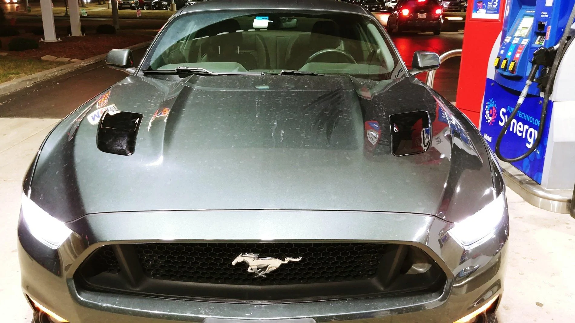

A friend went to Roush heat extractors, so I got his black ones! Yeah, yeah she needs a bath, I know.

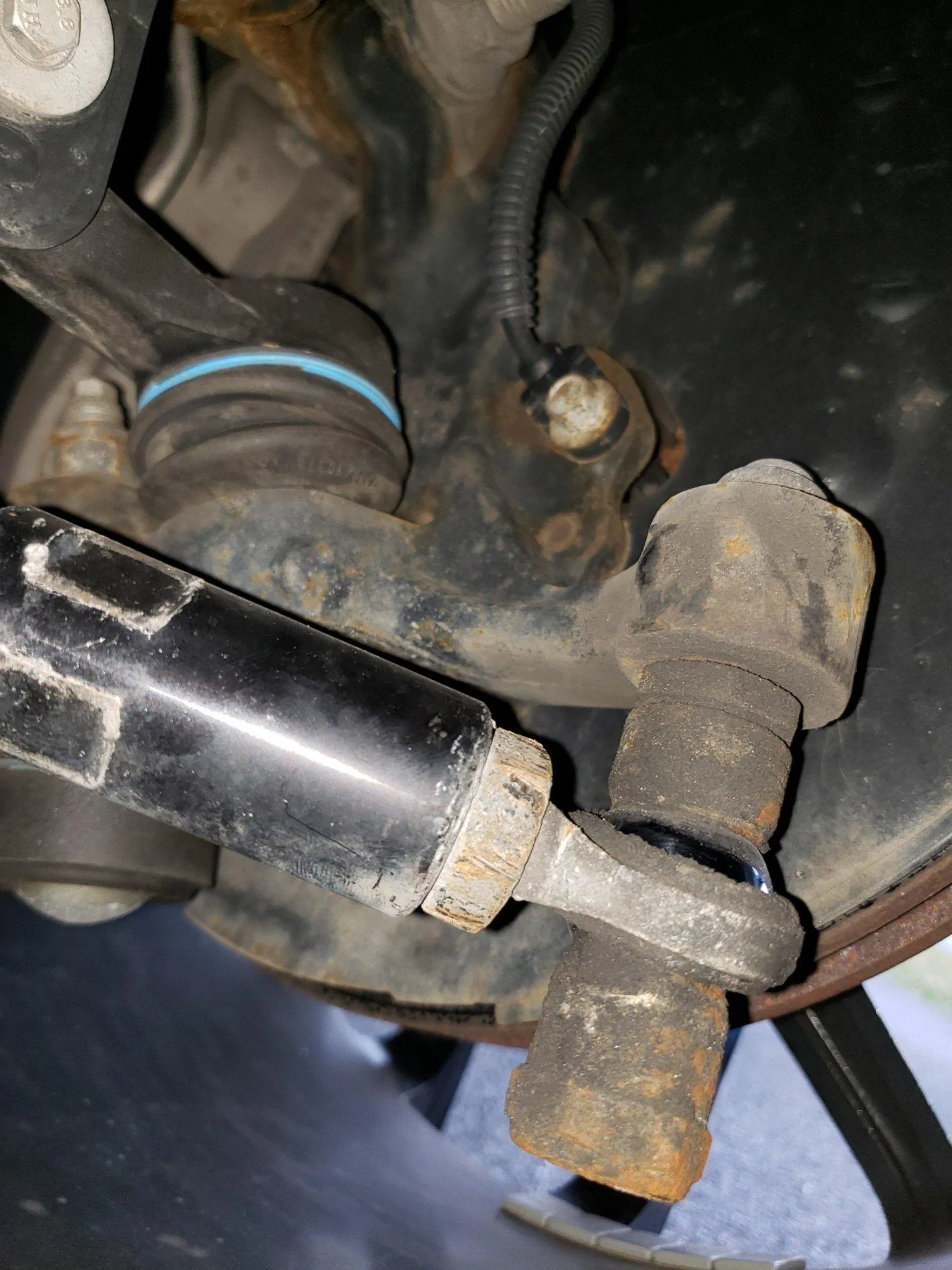

Thanks. You probably havent had time to share detailed impressions. Did it remove bumpsteer? How did it change feel and response.
Interesting you went with the max adjustment given you are on low drop springs?
I'll now say that I probably need to dial it back from max adjustment. Probably move all the small washers to the bottom. It still has some mild bumpsteer but it's not the same as it was, and I'm thinking it's overshot and now doing the opposite but much less magnitude. @Bluemustang has the same wheels and setup but has less shims above the joint (second pic).

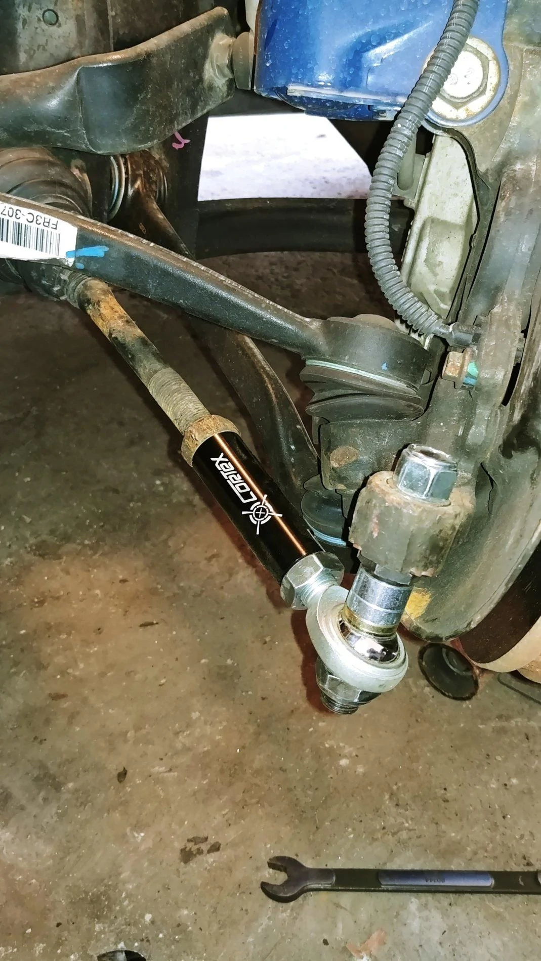

Second pic is how I was initially instructed/recommended to space them, and I have similar spring/setup as you, and it feels great (which is why I recently asked you about yours). Also... I feel much better about how dirty and beat up looking mine look after a summer and winter of driving :)

FWIW @Bluemustang didn't need any adjustment for his, but I think they hadn't gotten it right before.
Thanks. Is there a way to test this in one shot at the shop (example, turn wheel side to side)? I'm in a place in life where I dont have time to work on my car anymore and shop time is $$$. Going back to dial something like this in could get expensive quickly.

A shop with a hunter alignment system has a bumpsteer program. It'll ask for a jounce and extension of the suspension and will measure the toe change. We ran out of time to do it and it was close on the drive over so I wasn't worried.
I will say after a few more days of driving, it's mostly tramlining that I'm feeling. The car doesn't move around with bumps so it's very minimal. Small adjustment would be good but it's not urgent.
