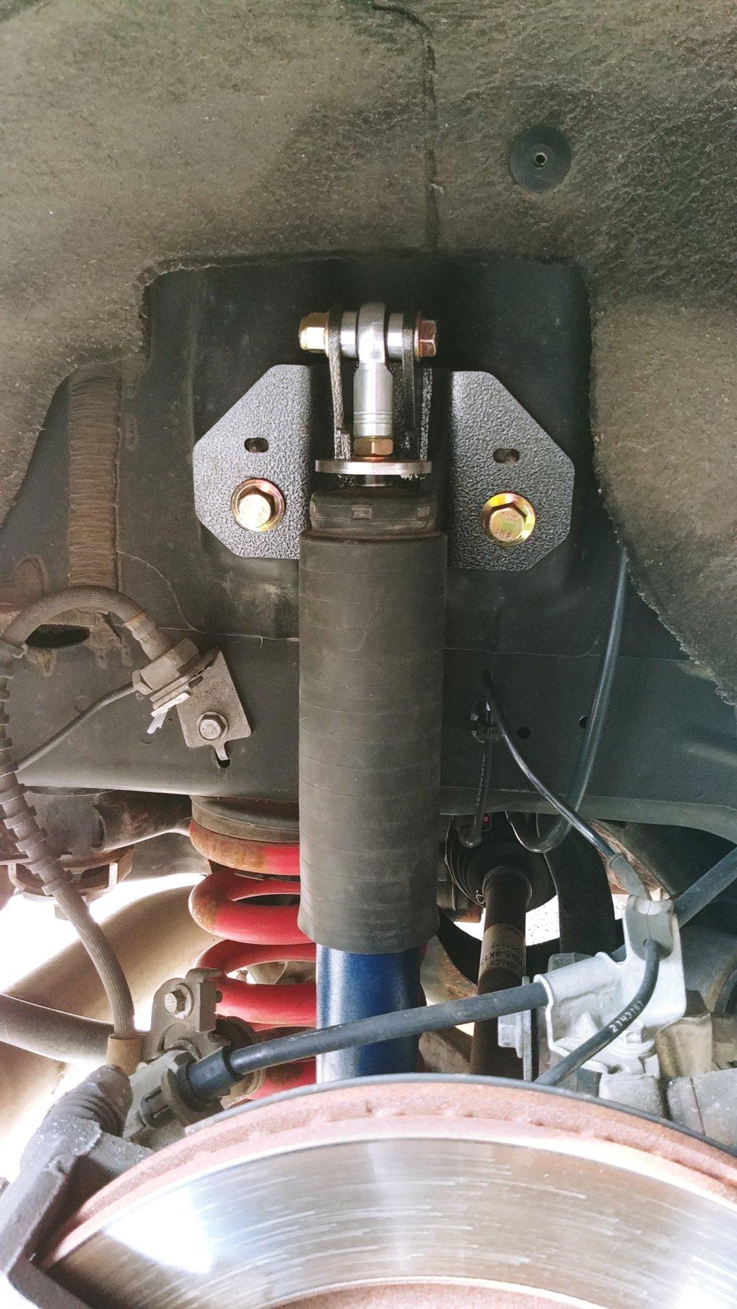

Added BMR Caster/Camber plates today, and replaced the Steeda fixed pro action struts with Ford Performance Track struts.
Ride is quite a bit better. It feels more polished and controlled (was already good in this regard before). All the small and medium bumps are dealt with more easily/smoothly/quickly. So far the handling is similar, though I haven't really pushed it much yet, and need to get it aligned on Monday. Overall I'm very happy! Just over 3 hrs from start to finish, definitely taking my time.
