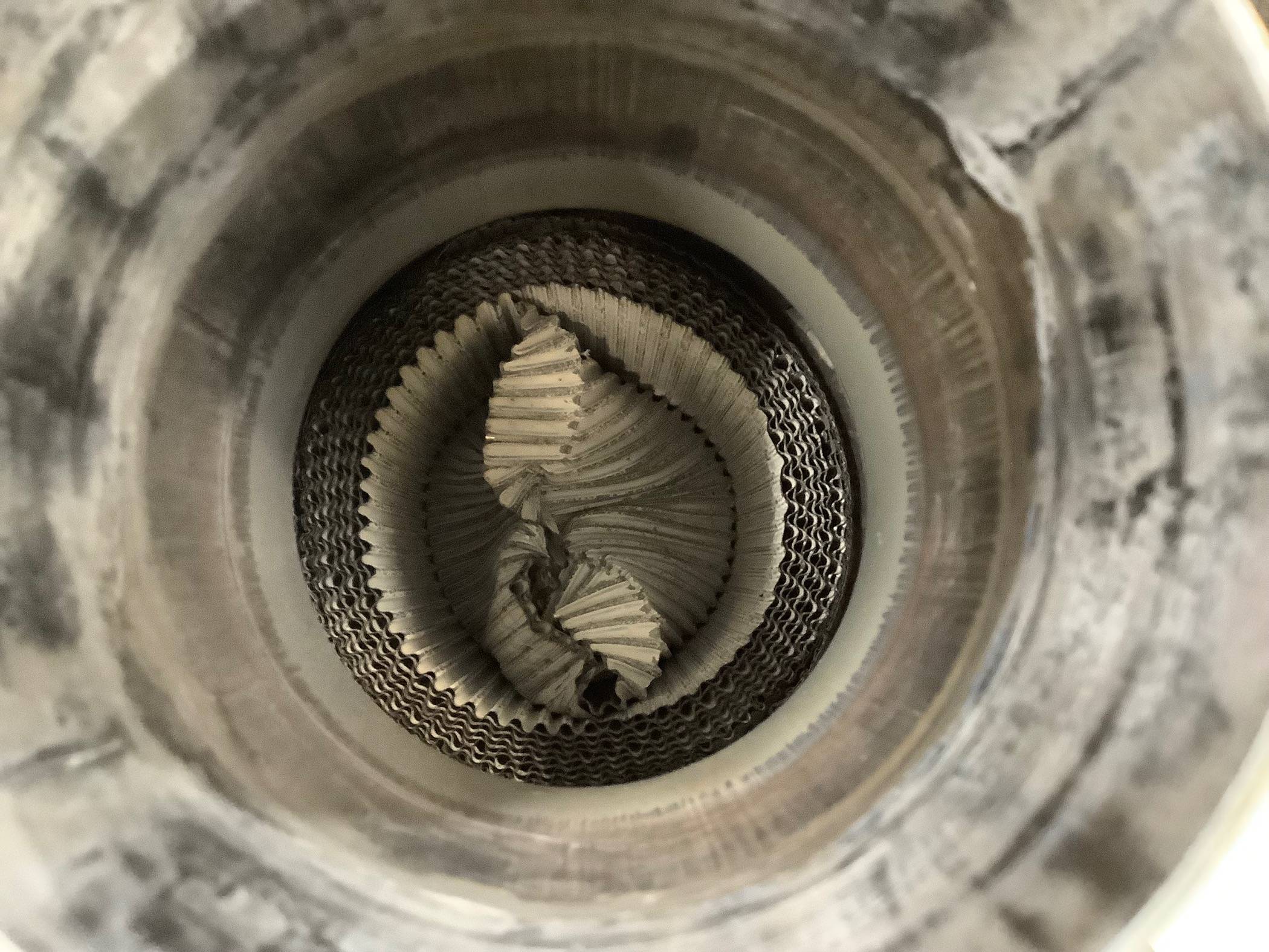

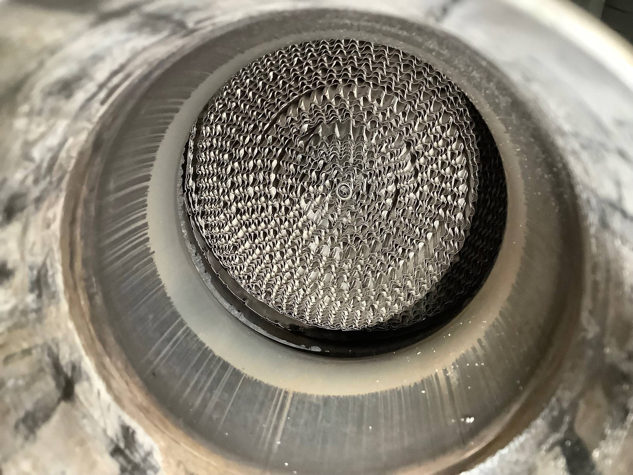

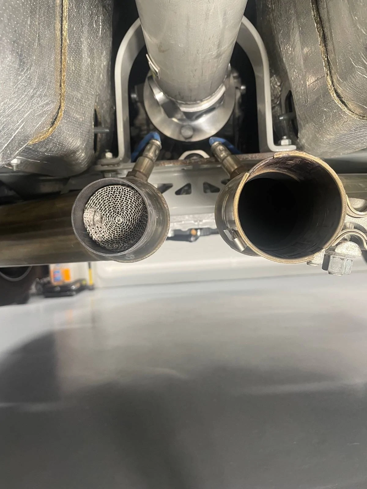

It can be a rotten egg or sulfur type of smell or sudden change in exhaust note. In my case, I noticed the sound of the exhaust change (clogging and unclogging) when the section of blown cat was being blown out under WOT and sucked back in during gear changes. Finally, this is what it sounded and looked like afterward:
