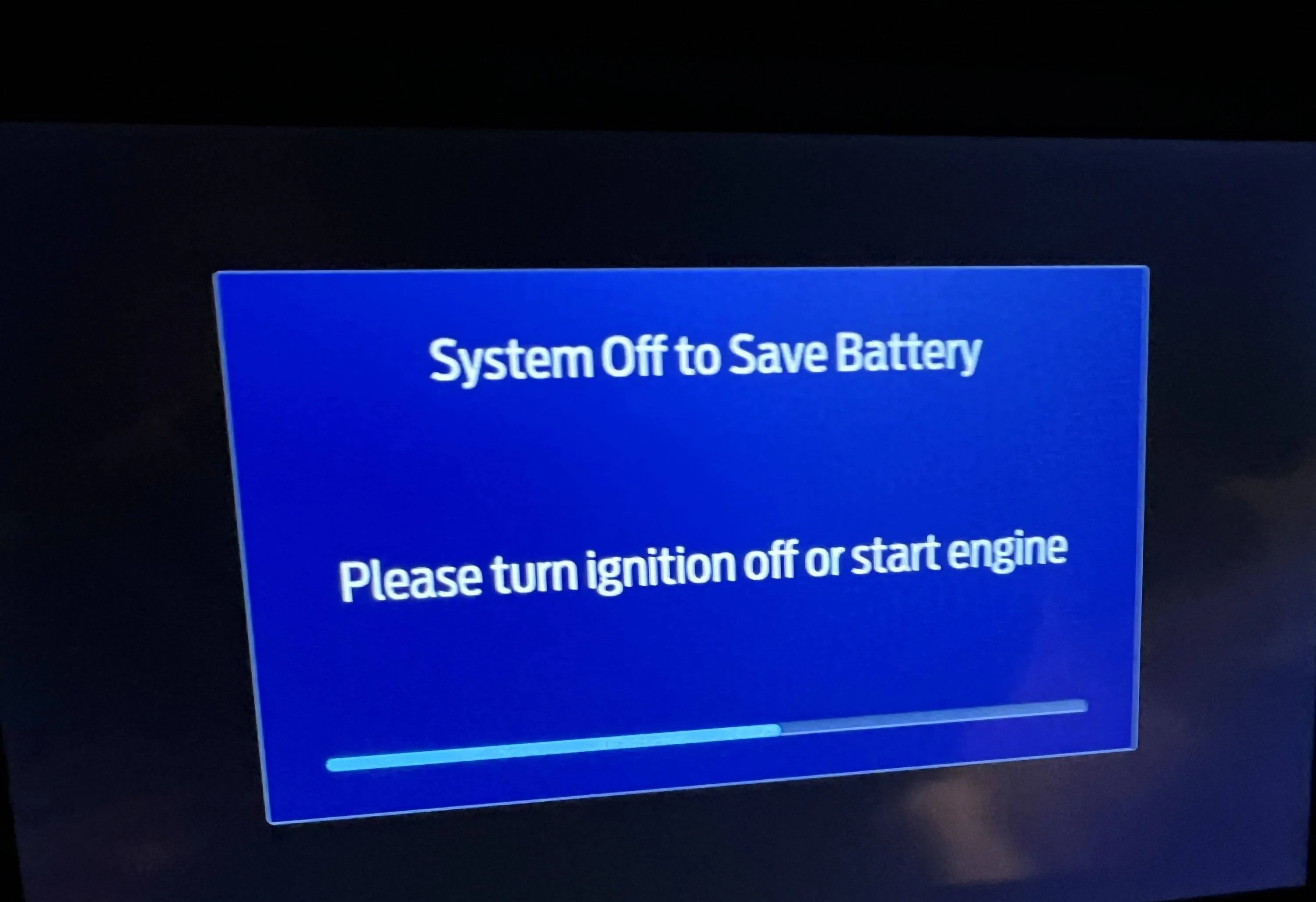

I have been reading about this screen and talked to my dealer while they were doing the safety recall for the brake indicator light. They want to run tests on it that they said can take from 30 min to half of a day to see if the battery is having issues. My car is a 2023 so I am hoping it is not already having battery issues. I will update the forum with the results if it is wanted.

Can you post links to what you’ve read about this screen? My 2019 has this intermittently and I’m sure the battery needs to be replaced.
