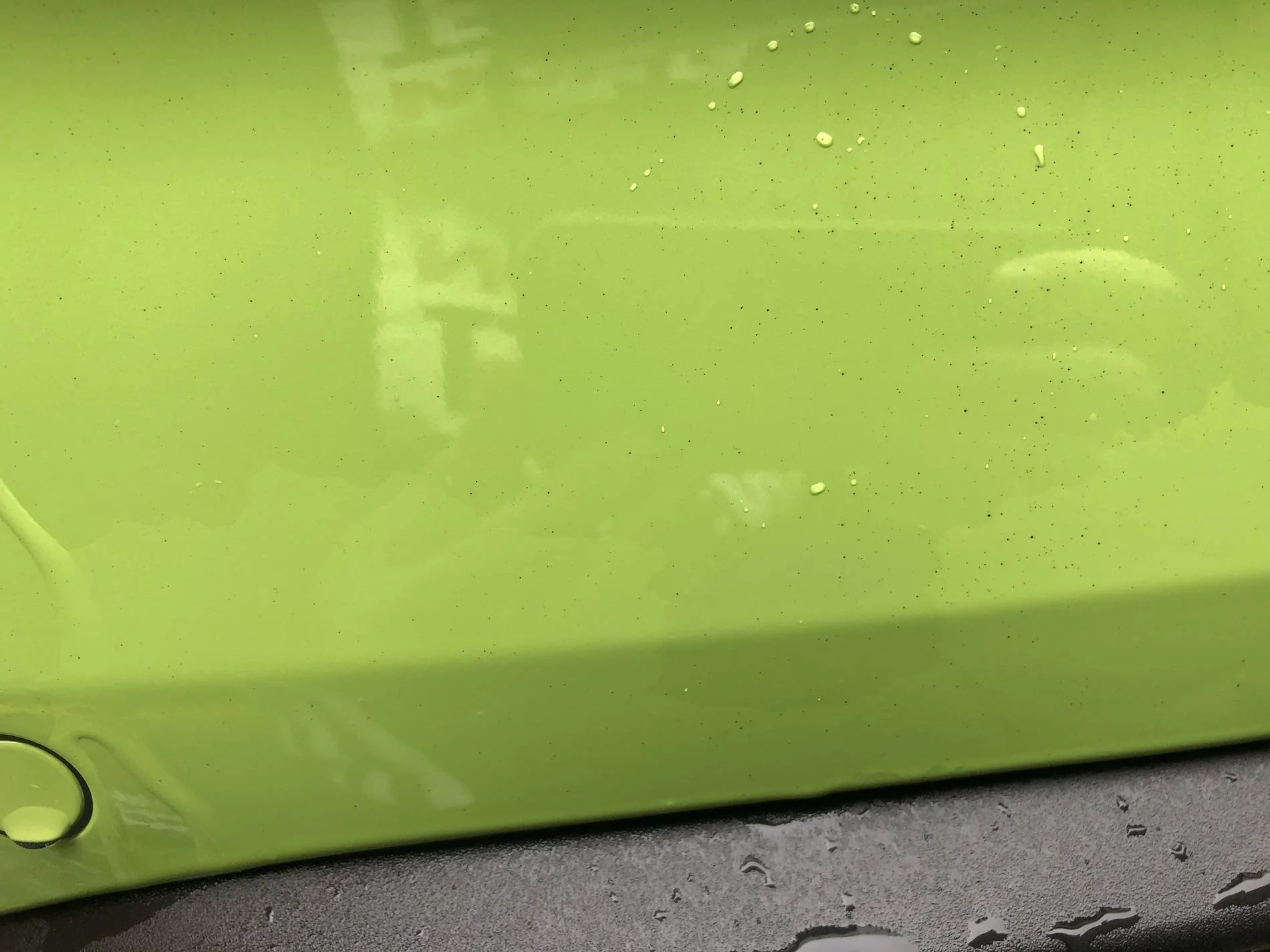

I have the same issue ...

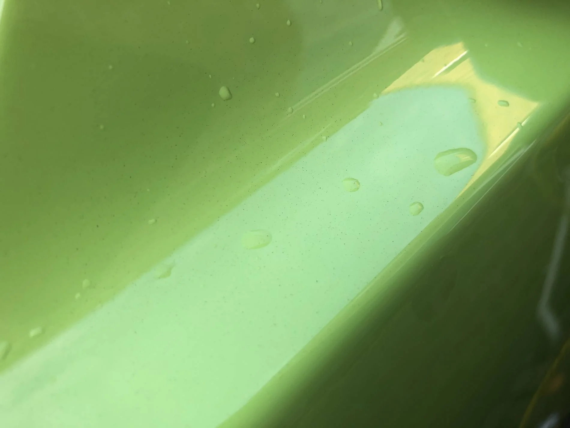

It was mostly around the back on mine :
And far worse on the passenger side :
It was even on top of the door handles and in the little ridges on them - pretty much anything that was low down near the back of the car or anything that faced upwards. Bonnet, roof and boot were fine so I guess the spraying takes place after the white wrap.
Clay mitt worked on the large paint areas, traditional clay around the intricate bits.
Thinners works on it, but be careful what the base material is and if it plays well with thinners. I used thinners on the tail trims with a 3M pad.

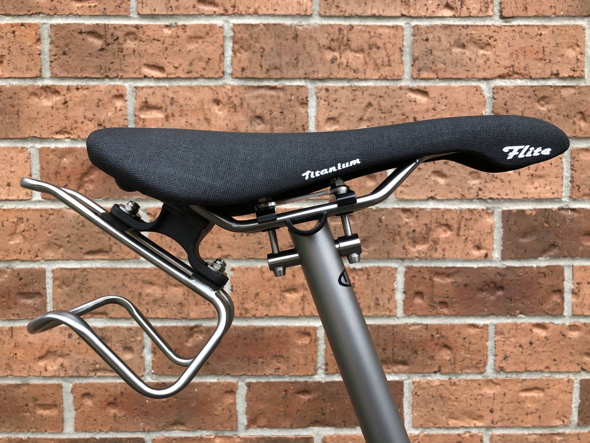

What type of thinners did you use? Is that seat bracket still good?

Thinners was just standard stuff from the local car paint supplier, the tin is marked as 'BC Thinner Standard' (made by 'mipa') :like:
Seat bracket is doing just fine thanks :like: :sunglasses:
For anyone interested, Nigel helped me with the round 'pin'. The only silver thing in this photo that isn't titanium is the small flat plate directly under the seat with two nuts sat on top of it :
