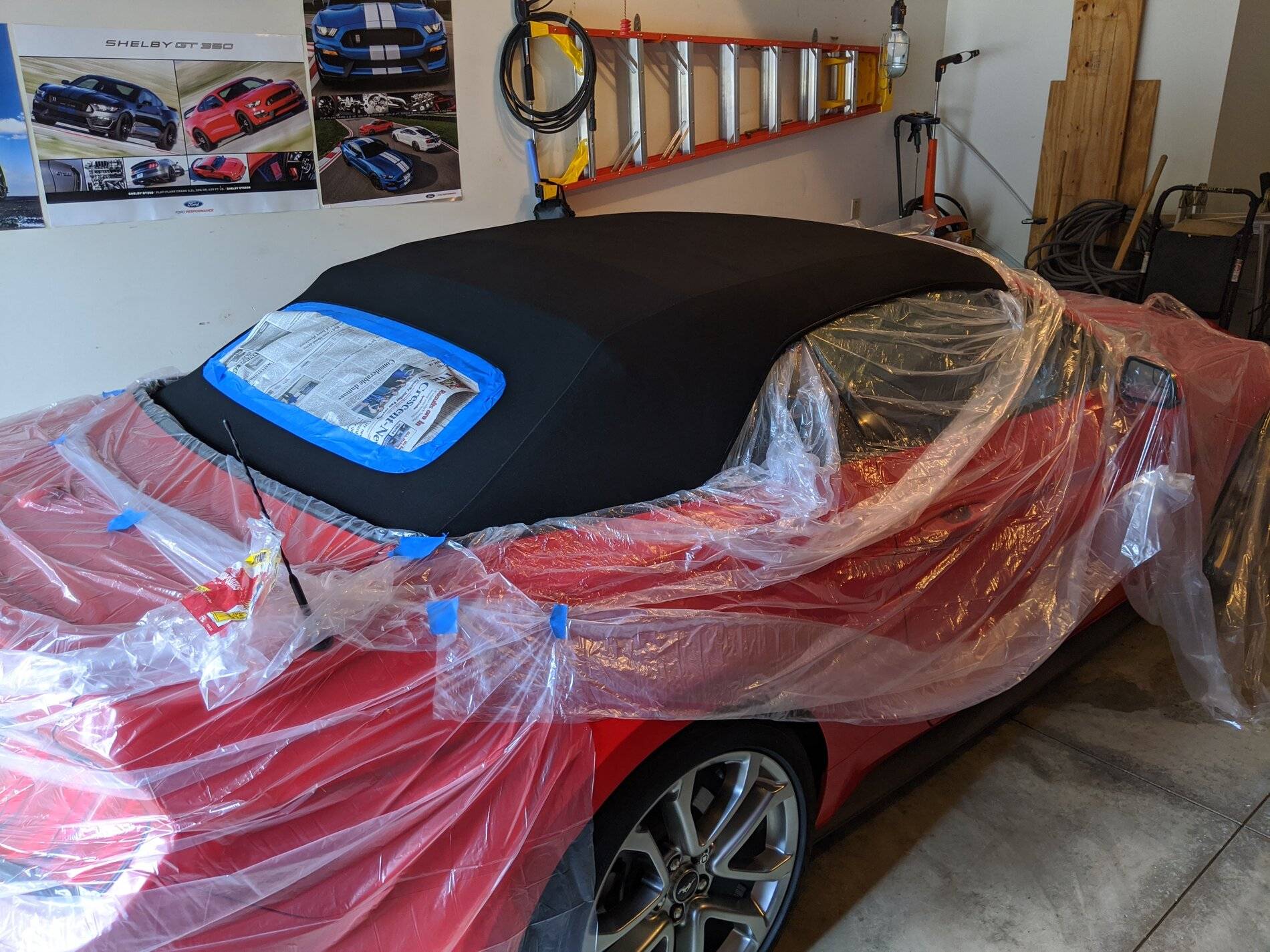

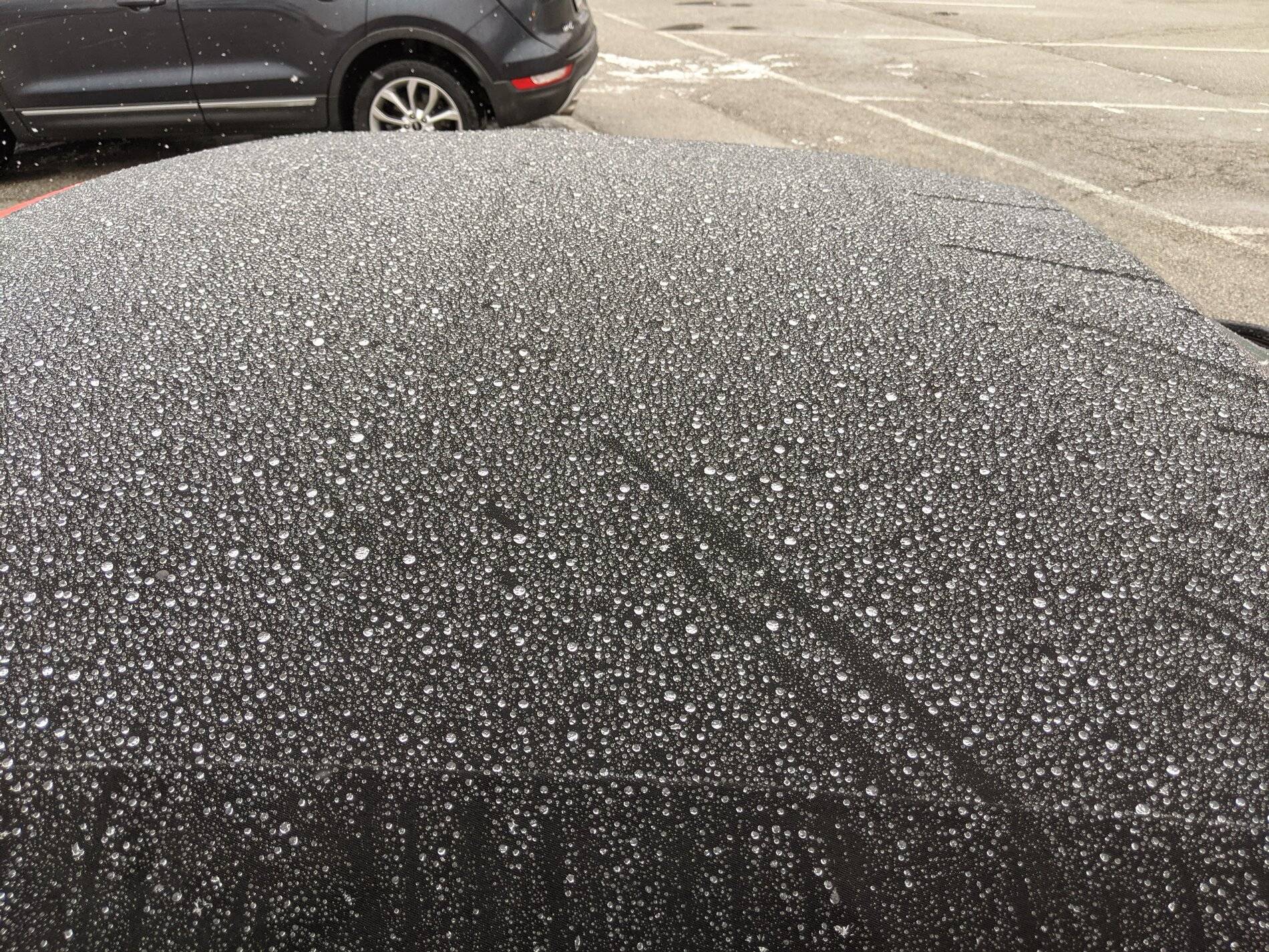

I spray two coats of 303 on every 6 months. Mask it up first. I get beading as pictured.
For bird poop, I just "agitate" it with a brush and rise it off when I wash my car. When I'm hand washing, I just hose down the top and scrape the water off with a silicone squeegee. The 303 lasts longer that way.
