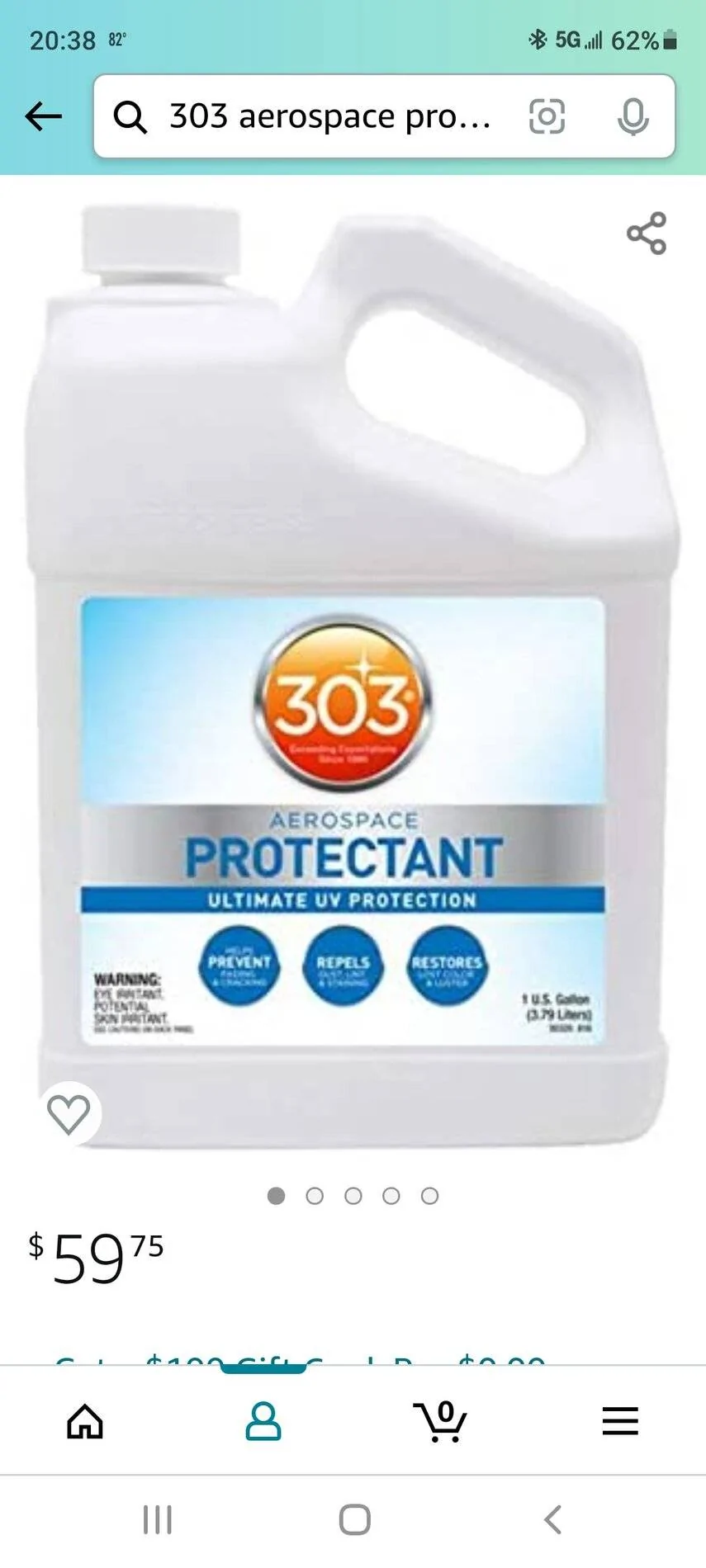

This is what I used every six months. (Protectant) - the cleaner I use when there's noticable soiling, otherwise, a light rinse of the hose.
I also use basically this same regimen. When washing, I use my silicone squeegee to remove the water from my top after hosing it down, and it removes almost everything. The protectant keeps things up on the fabric's surface where they are easy to get off. However, I haven't had to deal with tree sap.

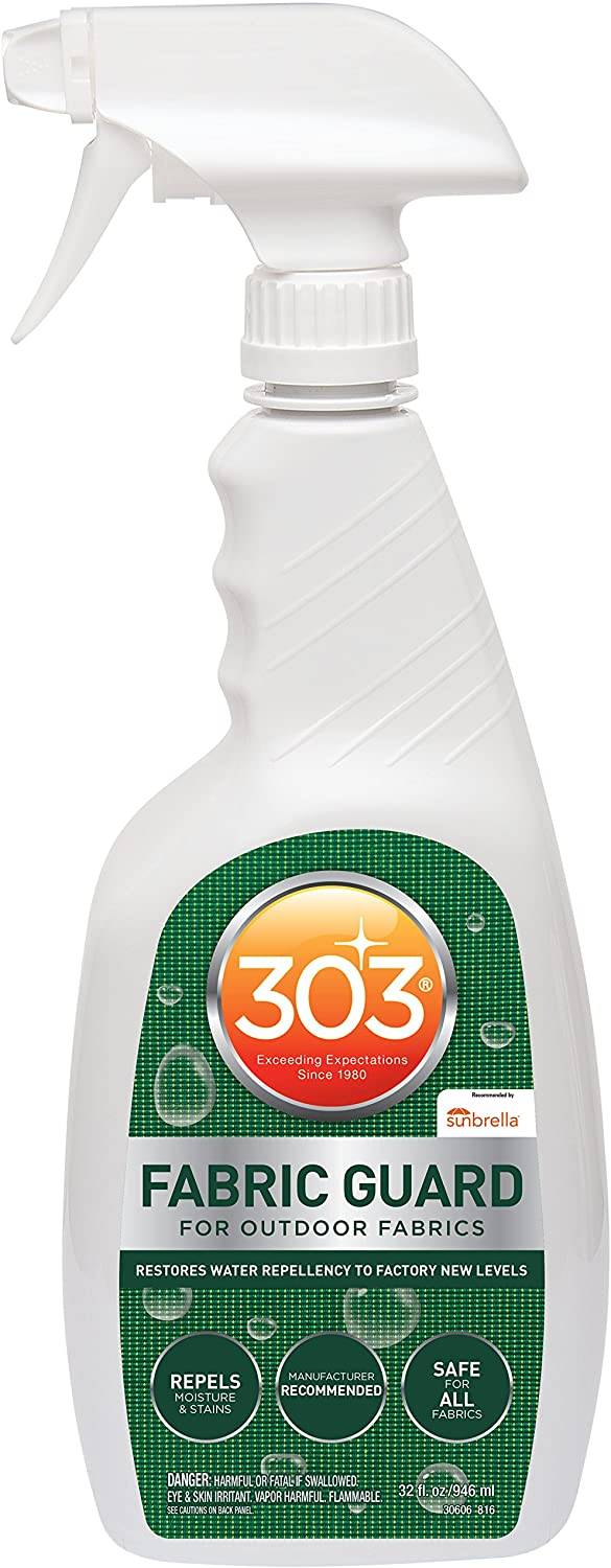

I used 303 from the start on my 20. Applied in March, still beading off:)
I brushed mine on though rather than spraying. It's kind a hard to get it even with a brush, and I probably used more product than required, but if you use it you must put it out in the sun per instructions for drying. Hotter is better:)

This. Spraying seems to be harder to get good coverage, but is easier. I plan to brush on next go round, and from what I hear, marine grade stuff is half the price for twice the amount. Think bimini top protection.

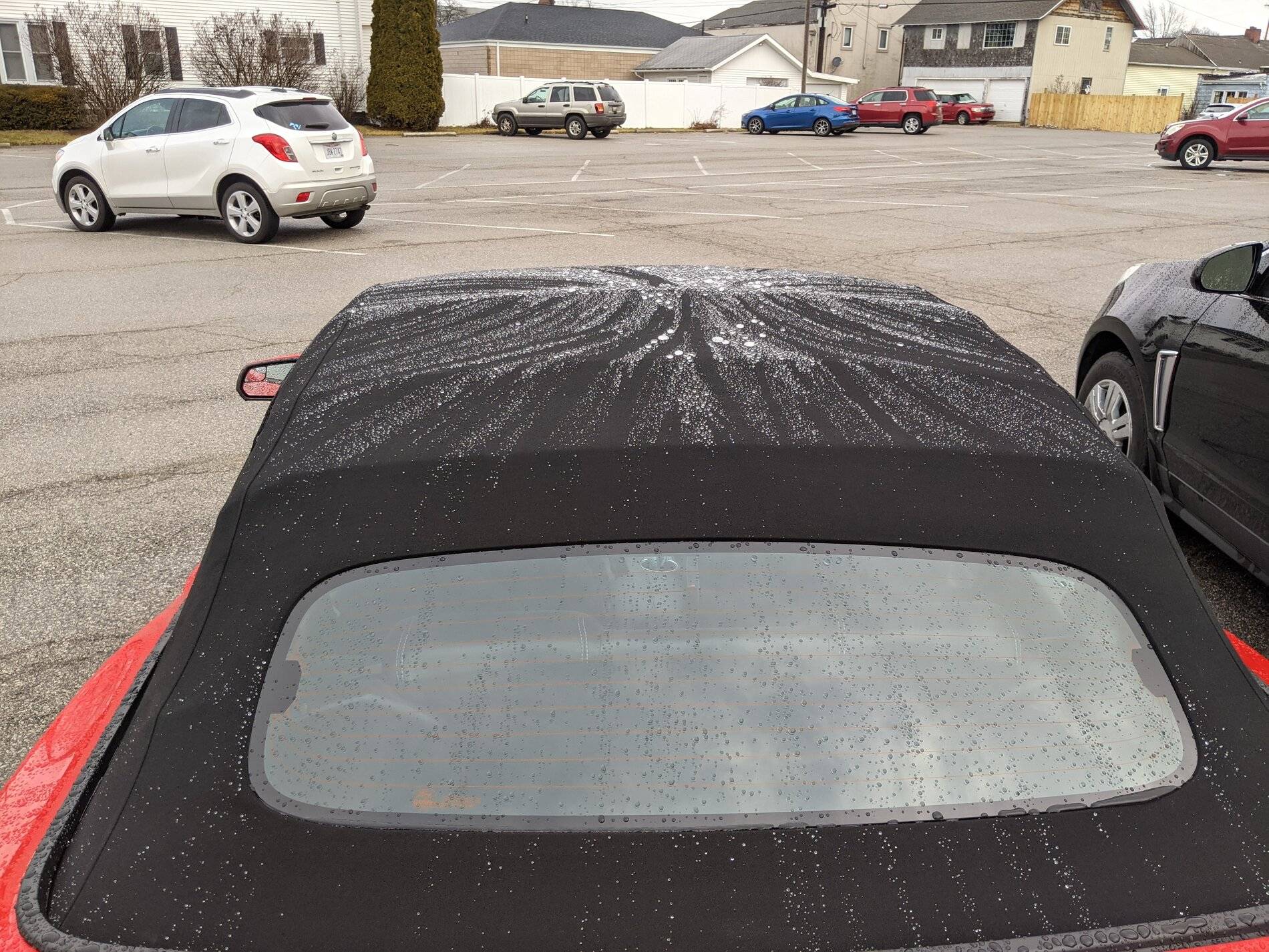

Here's my top today after about three hours in a parking lot with a light snow melting off of it. I had treated it with two sprayed-on coats of 303 protectant a few months ago. I try to hand wash when the weather allows, but its also been through a soft-cloth wash a couple of times since the protectant was applied. Still beading very well and the water rolls right off.
