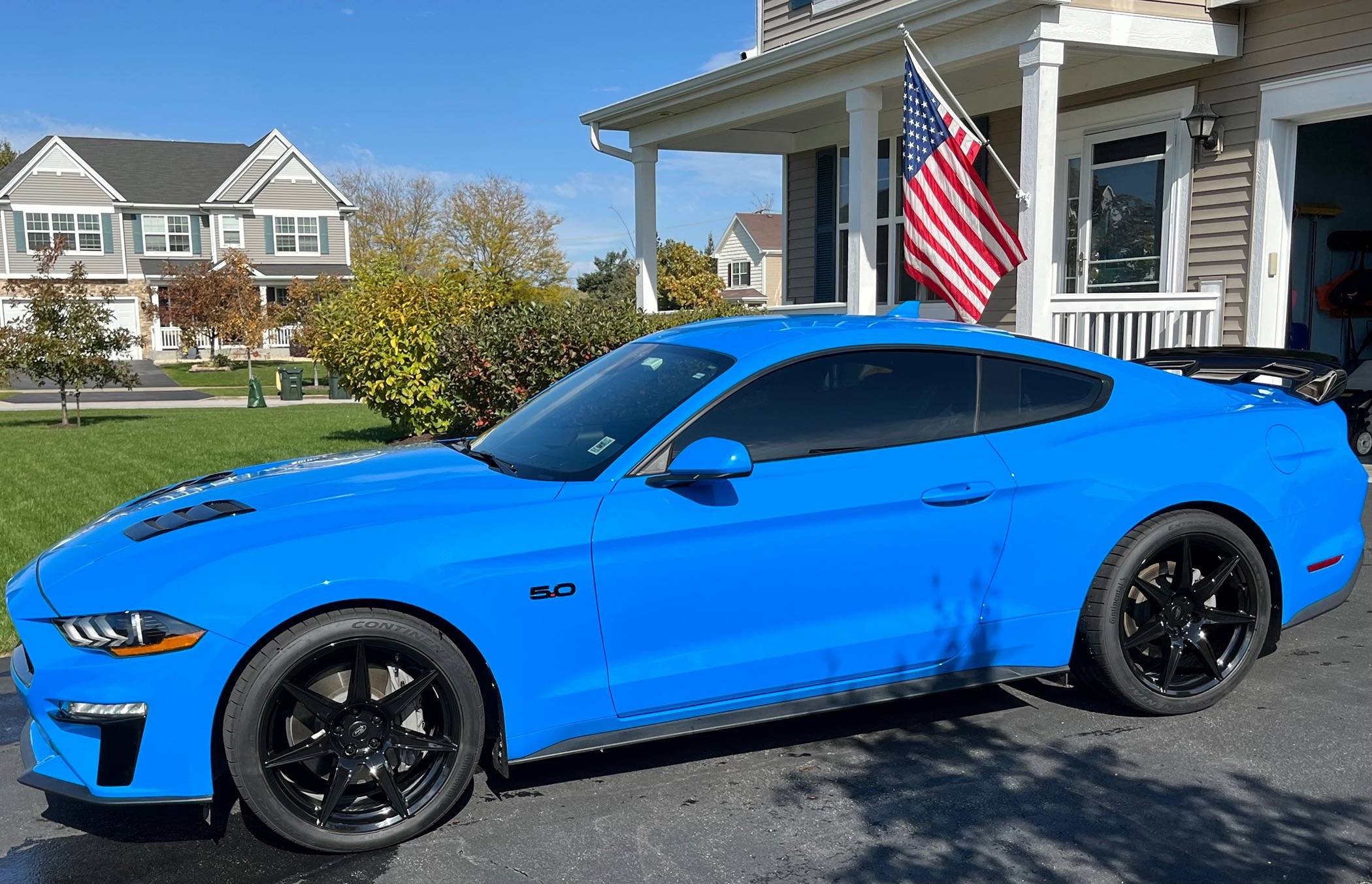

I run 20x10 in the summer. You have a front sway bar (or you should) so no, you don’t need to go larger unless you’re doing track days and feel that you need something bigger.
I run Continental Extreme Contact Sport, 285/35/20
