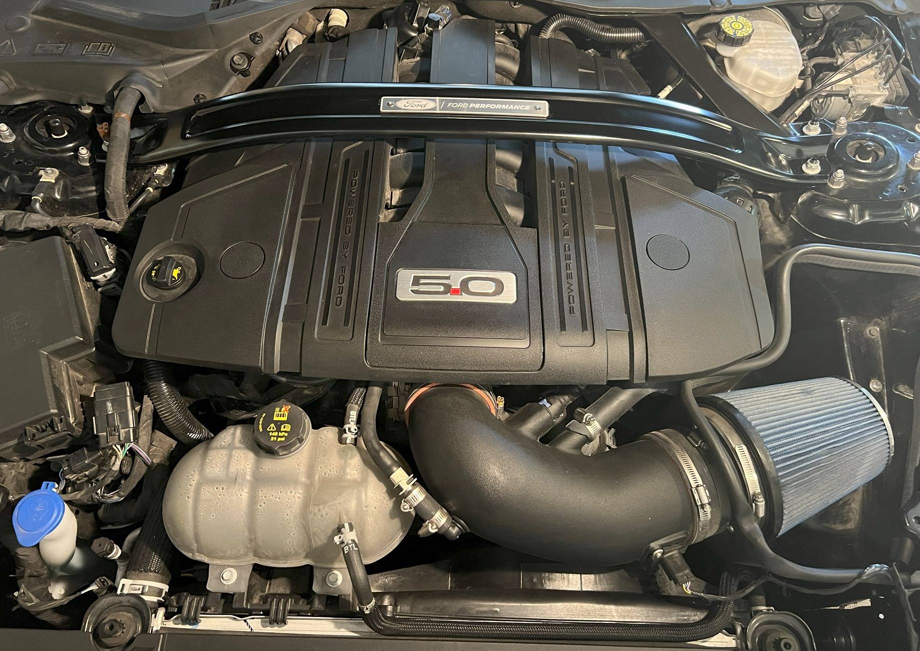

I have the Steeda blue oiled filter that comes with their CAI kit. Looks good with the chrome end ring and fits good. No complaints.
