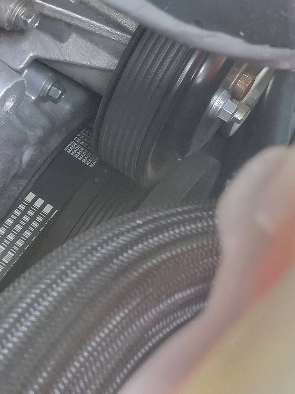

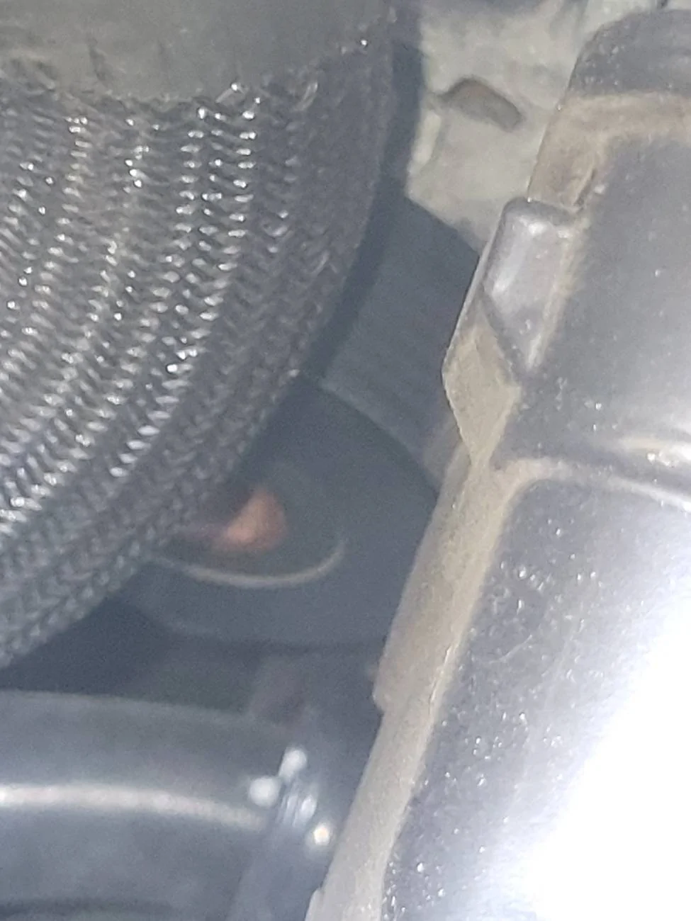

Below are pictures of the water pump crank and did my best to get the alternator pulley.

NP, it prompted me to look at mine though…..if you are seeing the ribs facing up anywhere then it most likely is improperly installed

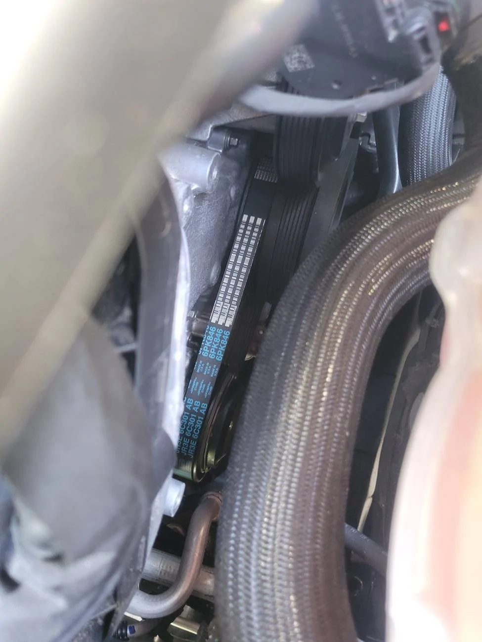

It’s hard to tell from those pictures, but I have seen some “double sided” belts that have ribs on both sides.

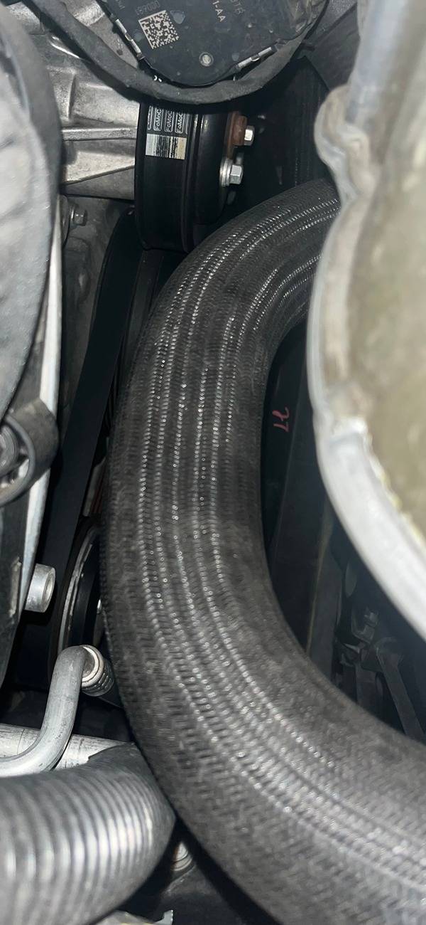

The AC pump belt is correct. Looks like your main belt is indeed upside down.

Yeah that one belt certainly seems upside down unless they make a double sided belt but I’m not educated enough on that

I checked it on the other side and it is smooth . I ordered a new one and will replace it ! Kinda scary cause the car was a one owner and no disrespect but it was owned previously by a girl and all maintenance was performed at a ford dealership. Makes me wonder if it was installed like that at the factory cause the car is a 2019 and only has 13××× miles so it wasn't a daily driver everything else is stock besides some weld in mufflers

Thanks ! Yeah I couldn't pass up the deal on the car very low miles for being a 2019. Thanks for the pictures confirming. I ordered a new belt and will replace it once it comes in .
