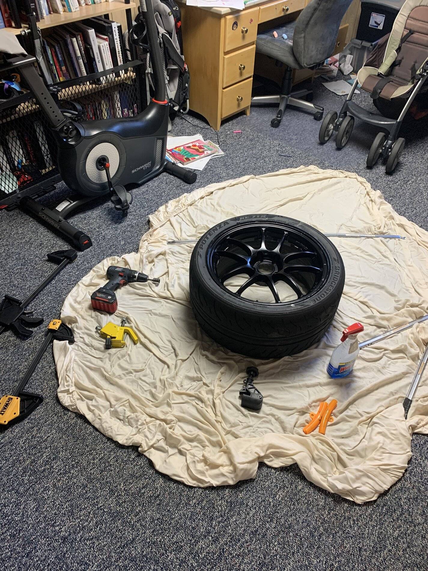

You can clean the tires and wheels with alcohol and mount them absolutely bone dry. The tire machine might not like it, but you can do it by hand with 3 tire irons and a bead depressor pretty reasonably.

3 tire irons, reminds me of my farm days.
Do you use ether to set the bead? :)
I would struggle with those rubber band tires with a tire machine.
