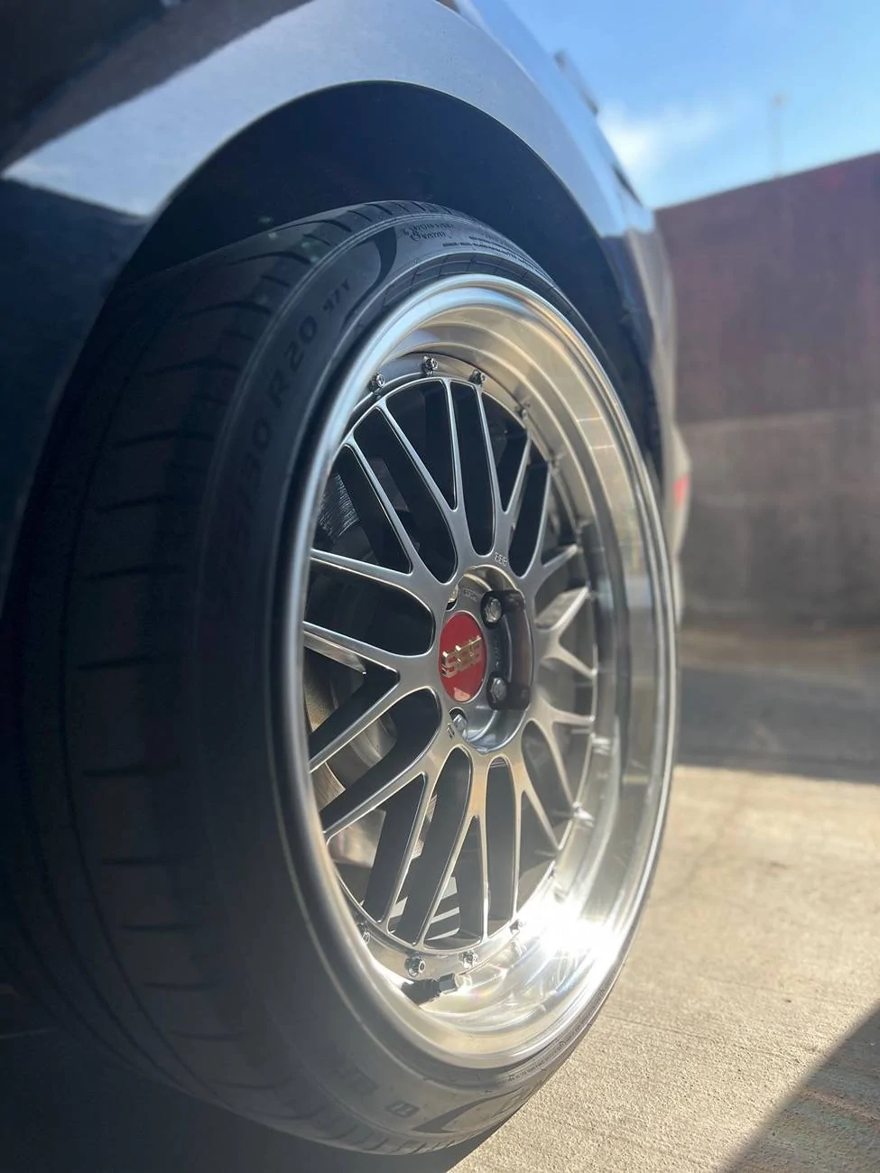

Why are you running a 285 on a wheel that wide in the back?
I ordered a 295 and went to my apt and was told they never got it. Threw a 285 on and thought it fit well. They do poke a little bit and a 295 would amplify that and make lowering difficult.

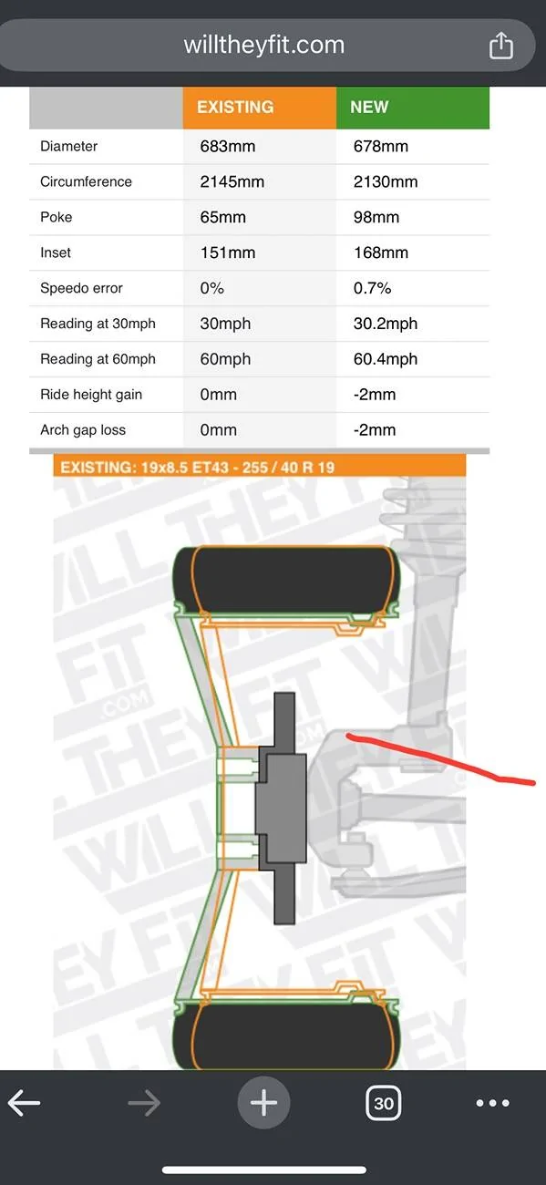

My car came stock with 255/40/19 tires. So a 285/30/19 is not that far off from overall diameter. I would agree with everything else you said though. I was looking for 285/35 before I landed on 295/30/20 due to it being exactly the same overall diameter as the stock 255/40/19. Like I mentioned above I settled for the 285/30 because they had it, and I ended up liking it when I saw it. So yeah not optimal to the fullest sense but good for me! Car is also not the daily driver anymore so ride quality has rooom to compromise a bit. Just drove a good amount of miles the other day and they honestly felt fine.
stock 255/40/19 vs 285/30/20 comparison:
