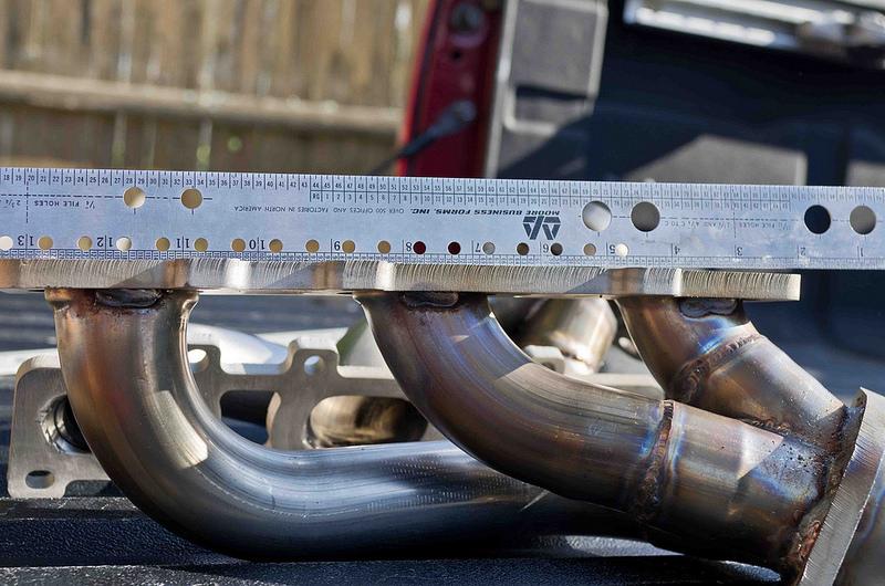

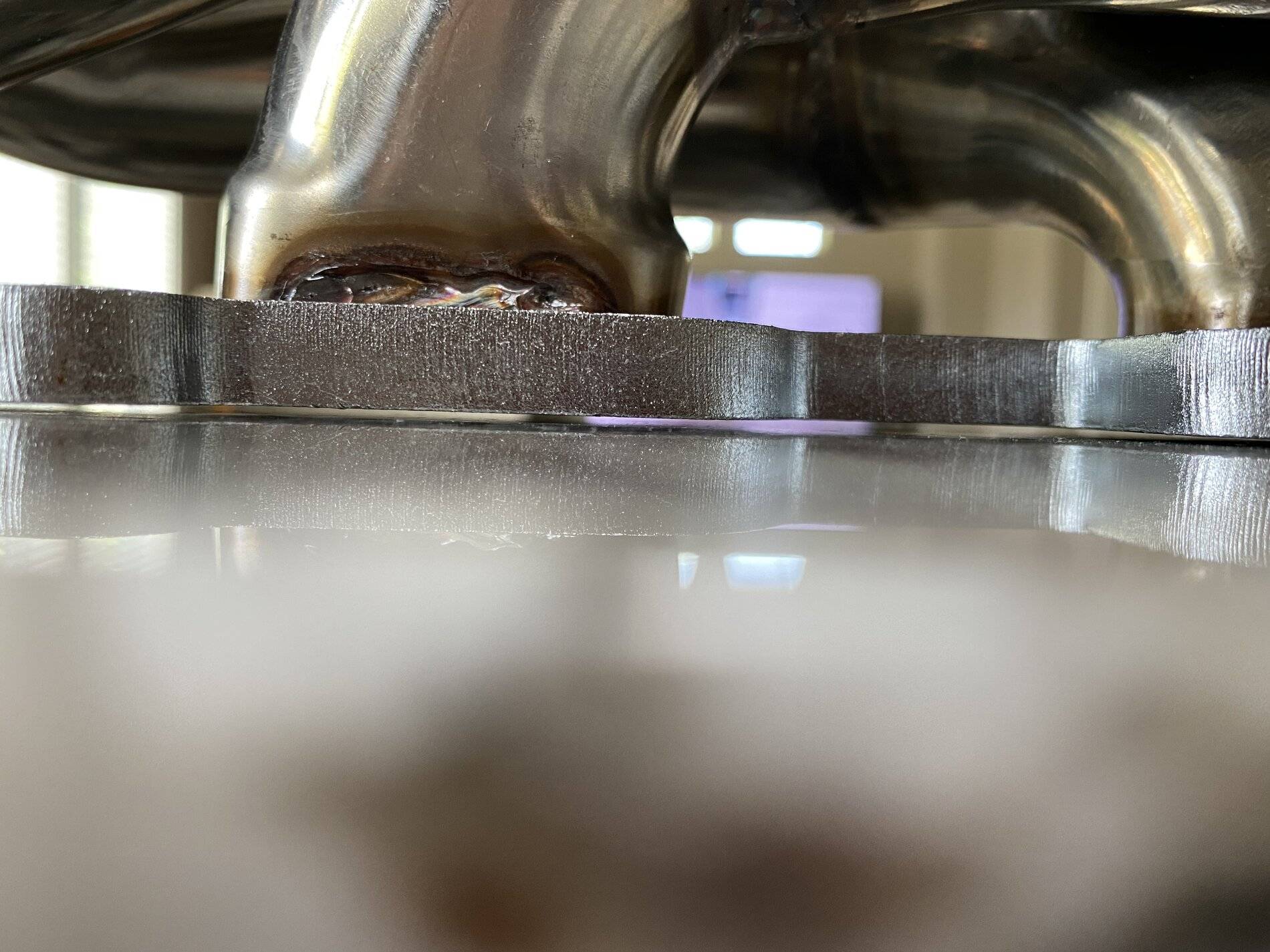

Speed Daddy headers arrived yesterday. The flanges are a touch warped. I can return for a refund or get a discount. I’m wondering just how much of a problem it is?
What about getting them milled a bit?
Thinking maybe just bagging this idea or maybe trying JBAs. Anyone try JBA’s? They look more like equal length headers than the BBK/SD type.

Milling would not only include the surface but making true with the angle at the point of the flange.

I ended up getting them milled at a local machine shop. “Oh they are all warped” the grizzled owner says. He was impressed with the build quality of the Speed Daddy headers. He also said it was a good thing I got them milled flat or I would have likely had leaks. Speed Daddy even refunded $30, which covered half of the milling cost.
