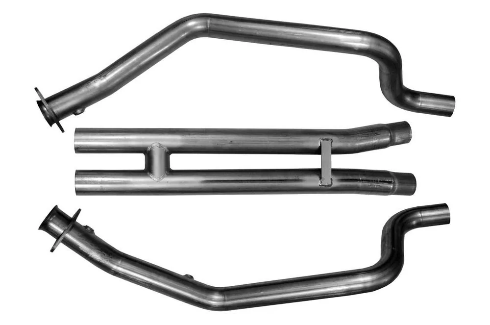

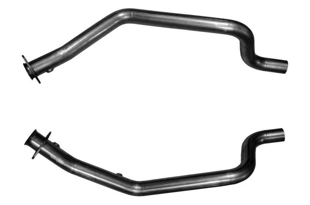

Here's another option for you which makes great power at thew fraction of the cost of headers.
Our offroad legs or offroad h pipe resonator delete kit gained us 12rwhp and over 20ft lbs of TQ on the stock tune.
http://www.lethalperformance.com/sh...g-3-7l-v6-t409-stainless-off-road-h-pipe.html
http://www.lethalperformance.com/sh...ang-3-7l-v6-t409-stainless-off-road-legs.html
Give us a call if you have any questions.
Thanks, Jared
