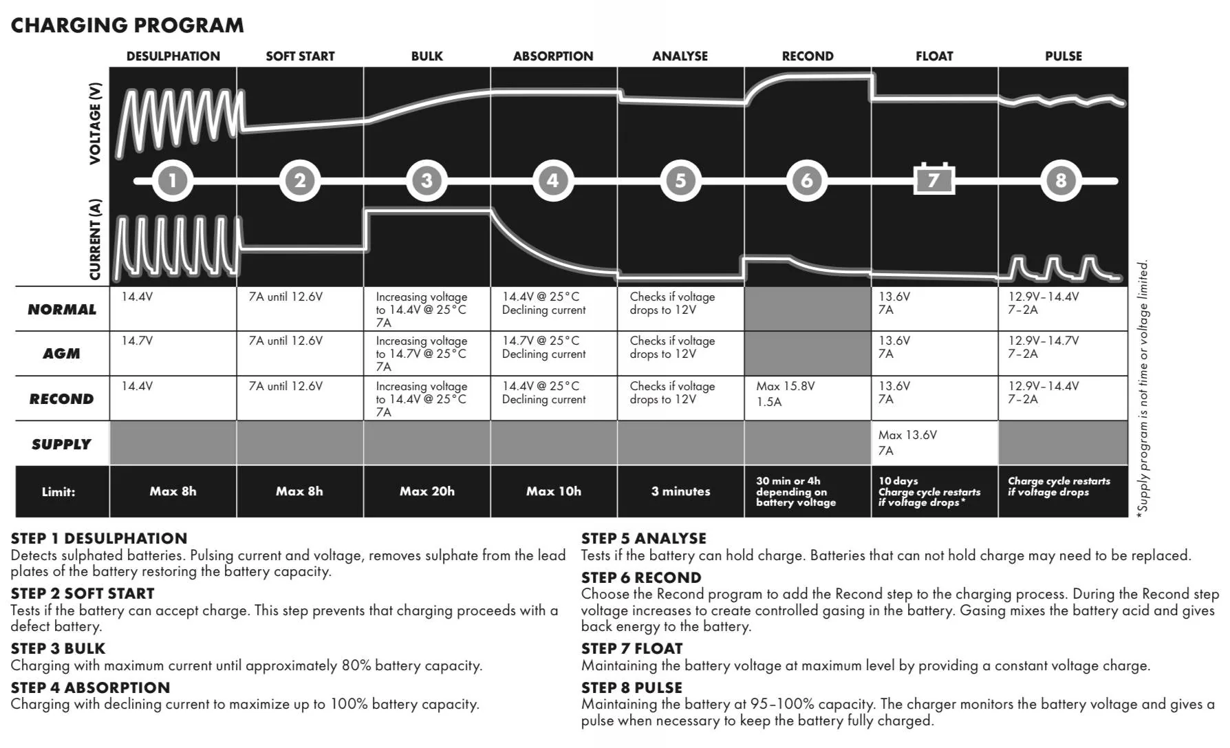

If the car is not a Daily Driver, I think it's a good idea to install and use a battery tender.
Modern cars have a lot more electronics, do more monitoring and can perform reporting, even at rest.
My '08 truck just sits there; the manual says I should start and drive it at least once every six weeks. LOL. But the '22 car, needs more attention as it re-energizes, reviews and reports different bits of the car frequently.
A tender will keep the battery properly conditioned and help ensure it's long-term survival. You'll be changing batteries less while removing problems associated with a weakened unit. And if you can't take the car out to keep it topped up: fuggetaboutit; just keep it plugged in.

If you're not going to drive the car that often, it's best use a device of some type.
FYI: even after installing and using a tender, the car will still go to deep sleep. The advantage is, the tender is still there, 1) keeping the battery topped up and 2) "exercising" the battery, keeping the internals in the best shape possible.
