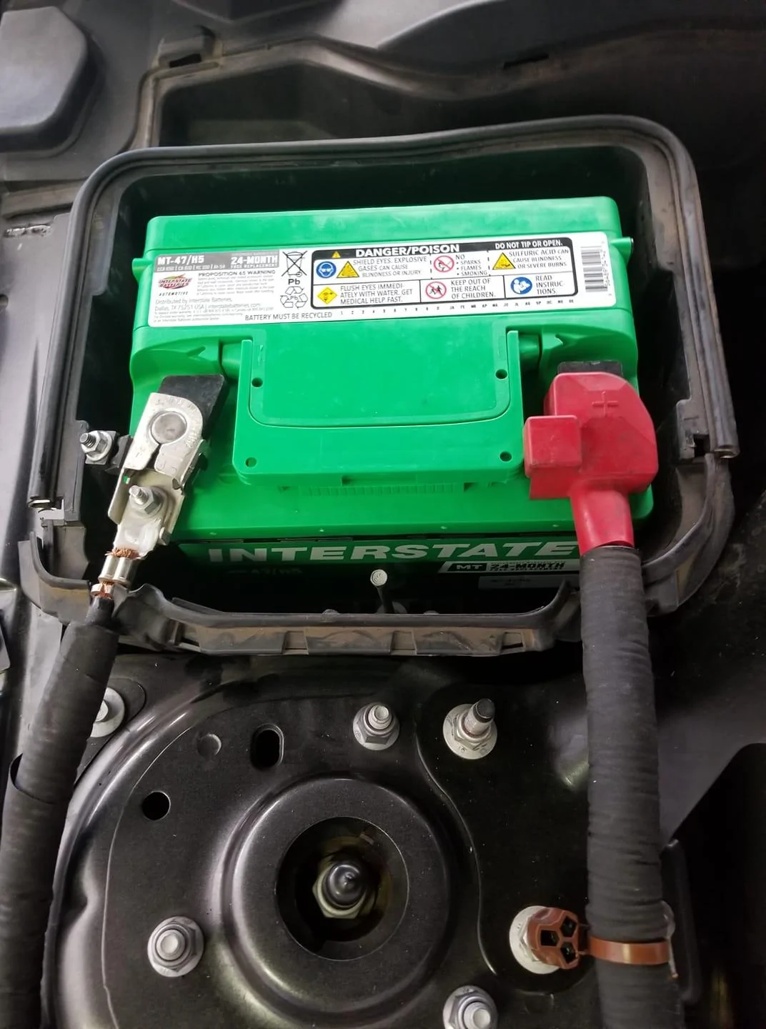

Just installed an Interstate battery and it FITS darn near perfect. just a smige taller but retains the battery hold down & the cover fits right over with NO issues. its stronger and designed for hot climates. sure beats that junky Motorcraft one. This one is rated at 810CA & 650CCA which I believe is the same as the XS Power D4700
Hope this helps others. the size is MT/H5. The price of $165.00 wasnt bad either

Good call.
Was your OE battery the non-sealed type that needs water? Lot's of us had problems with this...in this day and age, the battery living under that cover out of view, you'd never know it needed serviced with dist. water.

Good call.
My battery was not the sealed type. it was the factory 96R. My wifes 2012 uses the same one and here in AZ batteries last 3yrs if your lucky (at least the 96R doesn't).
