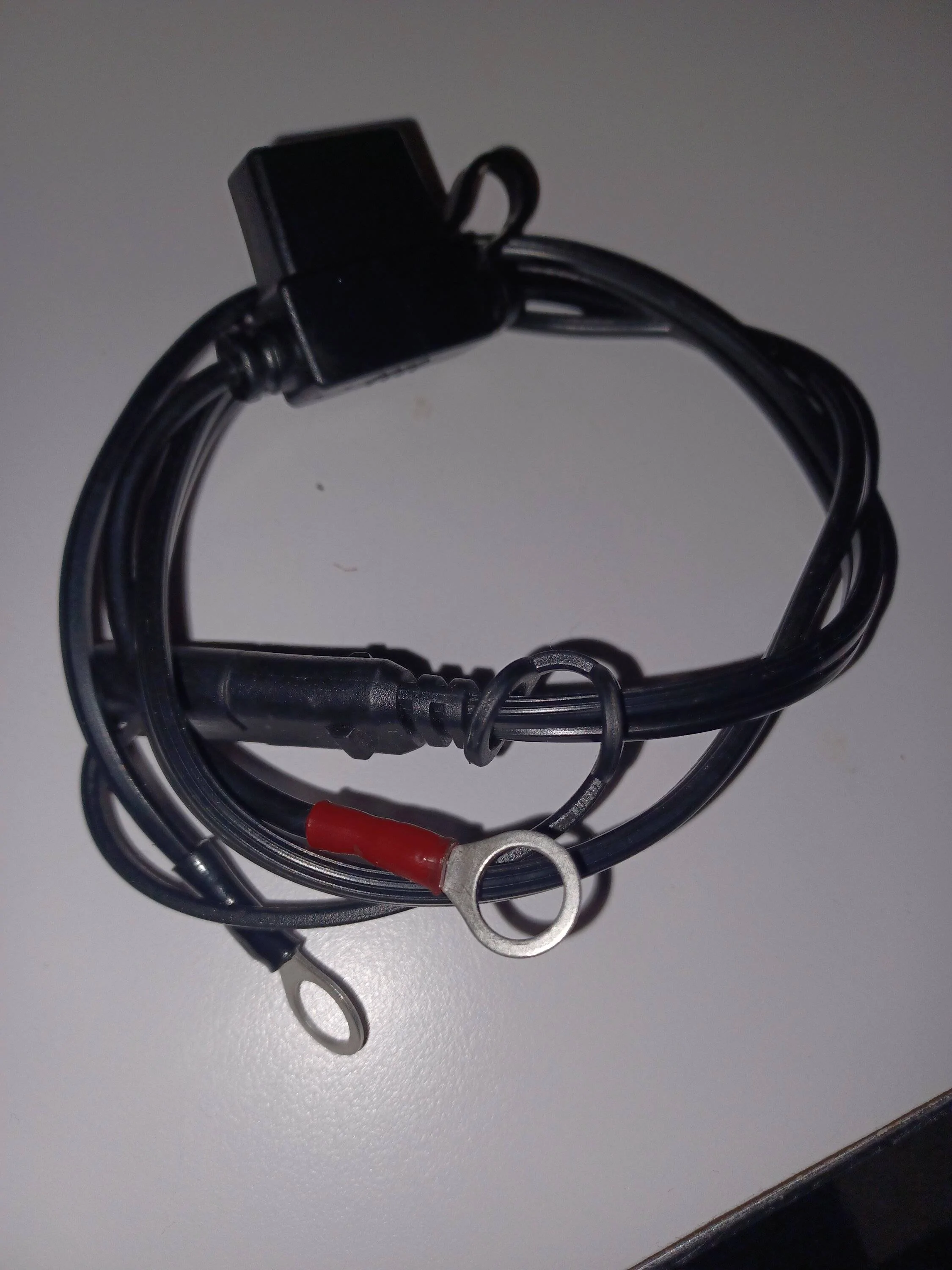

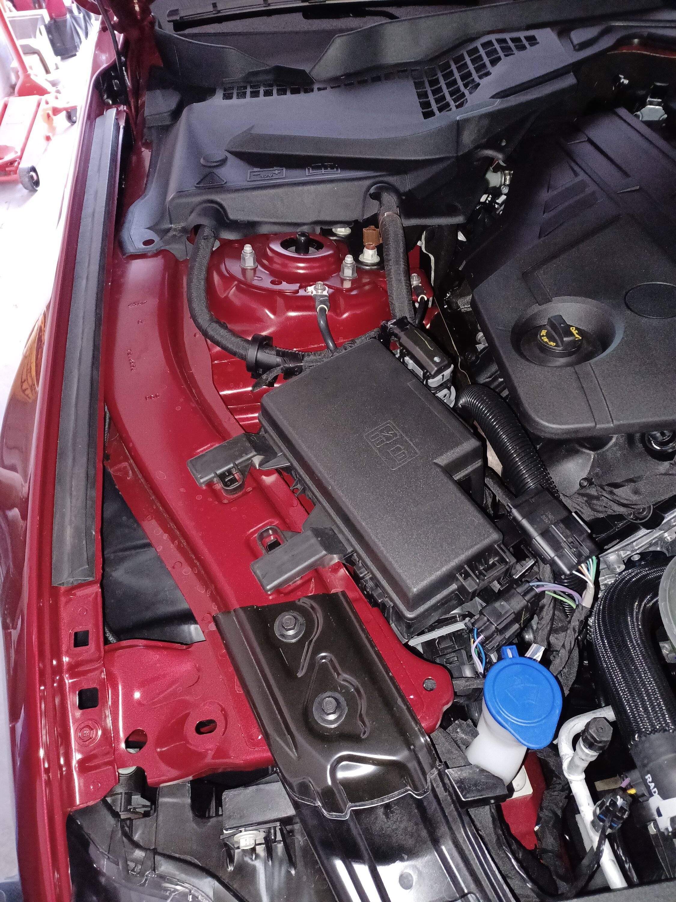

Hey guys, I recently purchased a 2022 mustang GT and was setting up the battery tender using the fuse box as seen in these two pictures. Fuse Box / Ground.
While installing the positive cable to the fuse box the lights flickered a few times and the fuel pump cycled 4-5 times until the bolt was snug. Just wondering if this would have or could have damaged anything? Nothing seems wrong but I'm just probably being paranoid so I thought I would ask...

I’m guessing you removed/used the nut already holding the red cable to the fuse box? That would create an intermittent contact for all accessories. This would cause the items you mention to flicker/cycle.
I added an additional nut on that post to not have to remove the other one. But what you did shouldn’t hurt anything.
Yeah I used the nut that was already on the fuse box, next time I'll try using a nut on top and that way the line stays secured. I don't think it harmed anything, mostly just being paranoid I think. I'll take it off in spring and see what happens...

The connections are in the right place.
It reads like you installed the tender while the battery was still connected at both posts? If so, that could cause the conditions you mentioned. If you had disconnected the battery prior and then installed the tender, when you reconnected the battery, the same events would have happened.
When I reconnected my battery, all kinds of gizmos clicked, spun up and powered back on, over a period of minutes.
Anytime I work on anything involving the car's electrical system, I always disconnect the battery first, to help protect car and self.
It does sound like "normal" events and that you did no harm. :like:

Nothing is going to get damaged from a temporary inconsistent connection, luckily. As far as why people use the fuse box, it's just to keep the car clued into the battery charging process. There's an inductive current sensor on the main ground cable to the battery that measures amp draw, and the car uses this to determine its charging strategy and infer battery charge level. If you connect directly to the battery, it has to figure it out the long way which requires sitting for 8+ hours.
