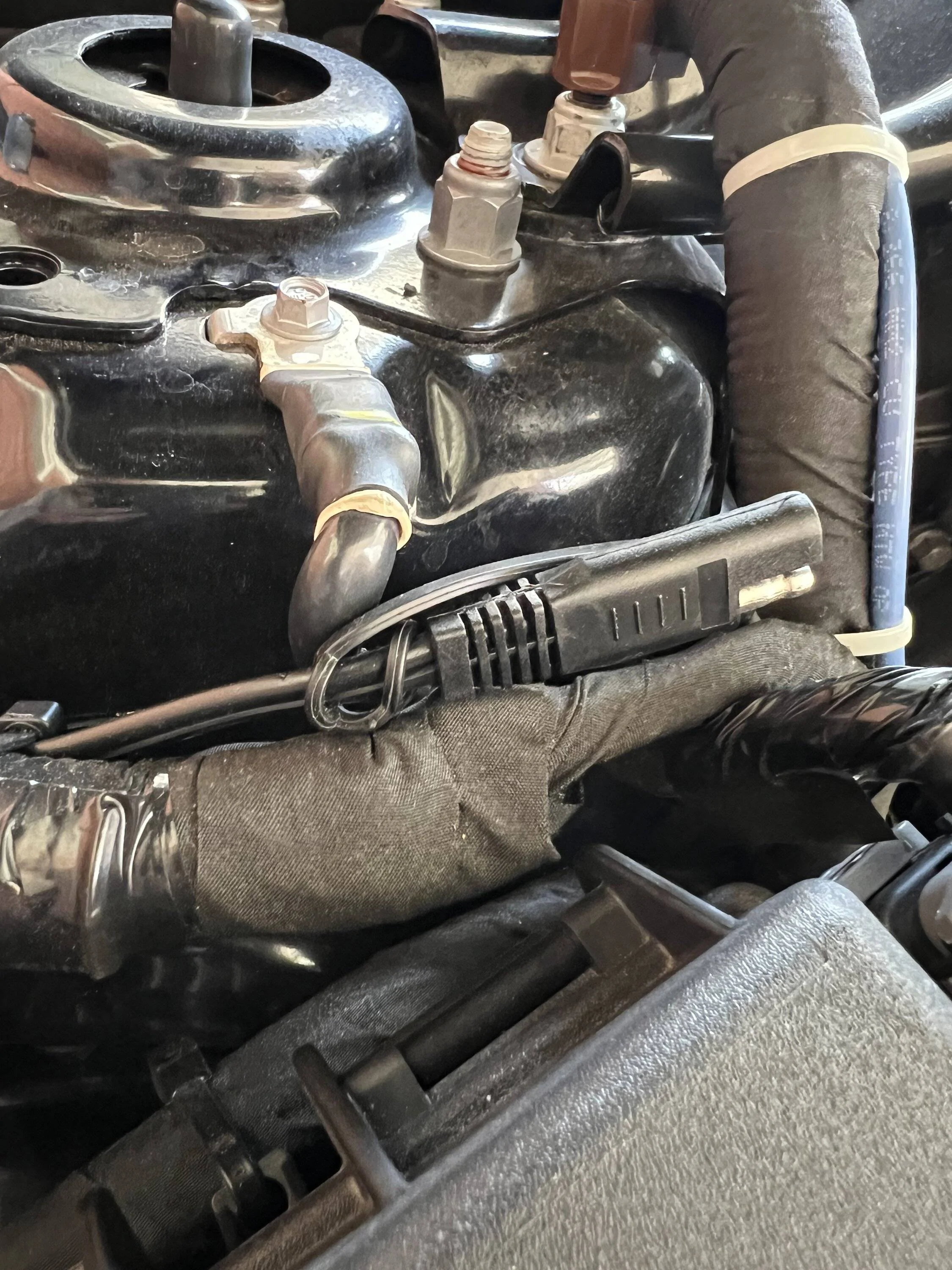

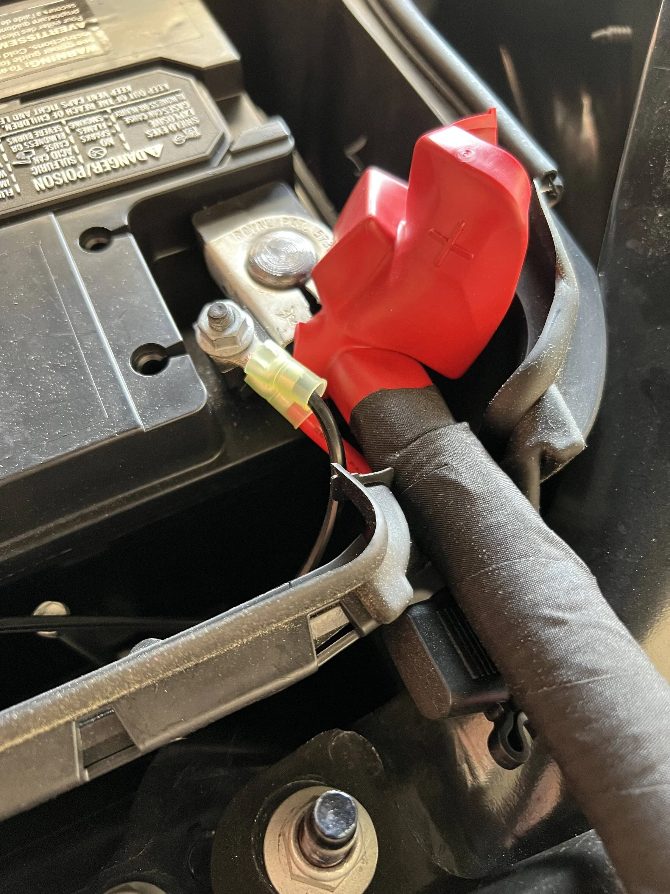

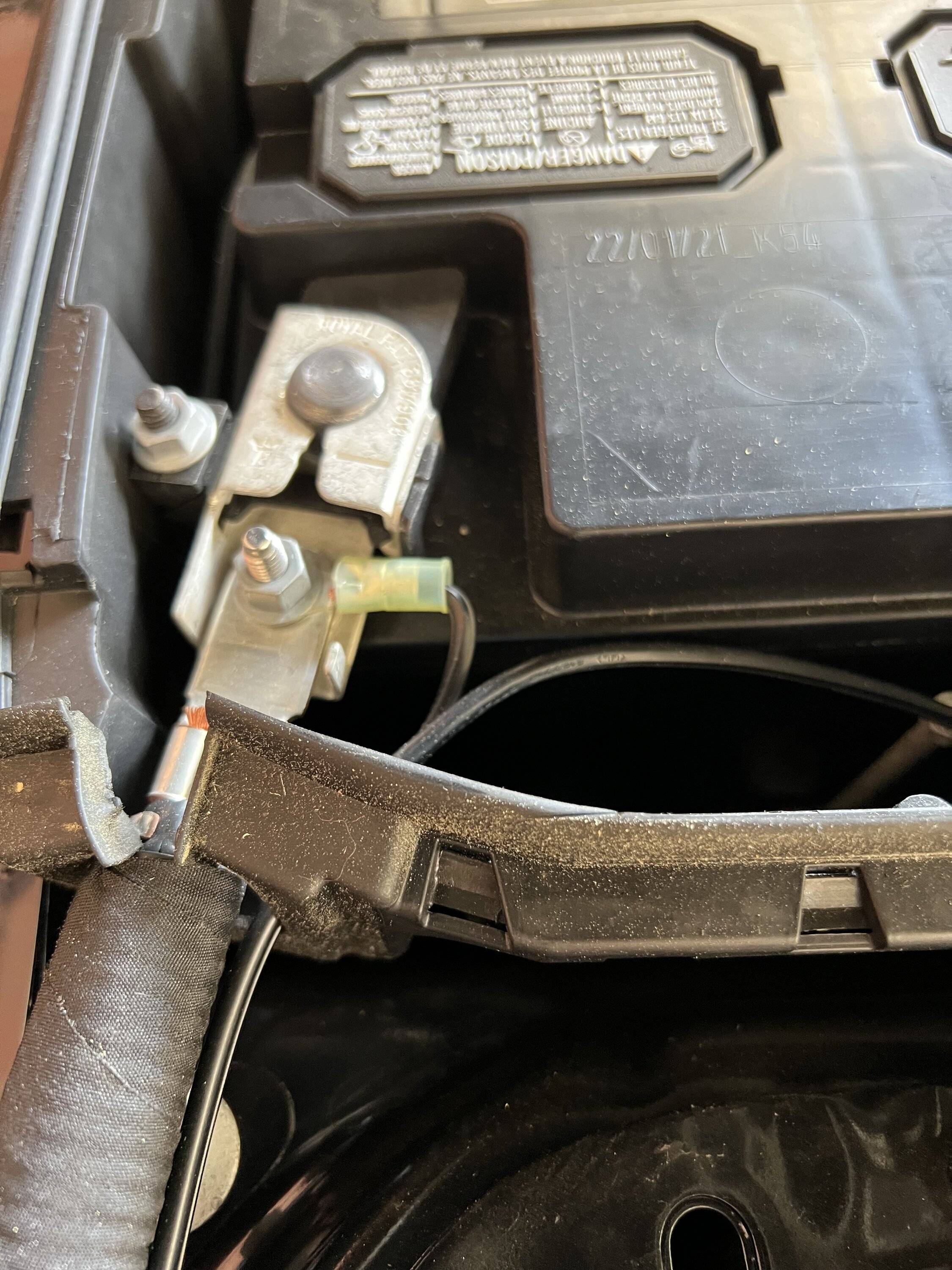

Okay, photos of charger cable to battery. Yes, I did have to replace the ring terminals. Also, you will notice a heavy red wire on the positive battery terminal. It is a positive fused feed to an amplifier that routes to trunk beneath the car (changes to blue forward of the battery - didn't have red).
Engine Bay:
Battery Negative Terminal:
Battery Positive Terminal:
Charger Connector (cap removed):

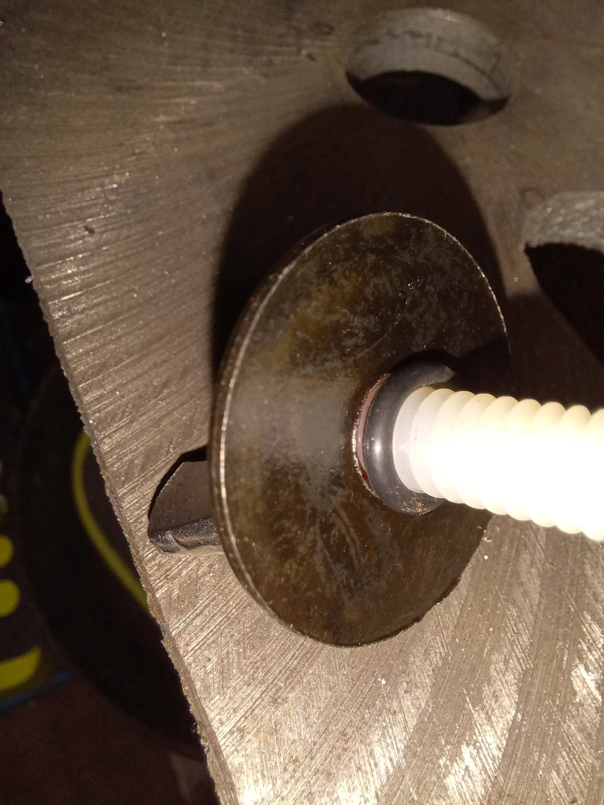

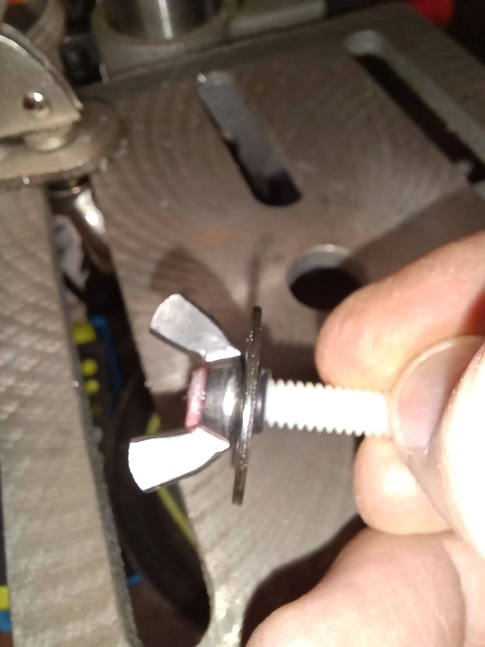

After a few tries to get the correct push pins(?) for the battery cover I said the hell with that and am doing the Rivsert trick.
One thing that I changed was using a black fender washer under the wing nut. It is held in place by a small o-ring. It should work well.
The battery cover has to come off again to make the hole bigger for a better fit of the strut mount.
I want to cut a slot from the hole to the edge so the cover comes off without having to pull the strut if need be.
