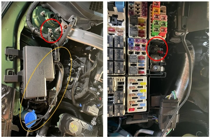

Positive can go direct to the terminal but negative must be before the BMS which is connected directly to the negative terminal. If you connect direct to the negative terminal the Battery Monitoring System (BMS) will not read the flow and recognize it. It will eventually self-correct but that is not the best way to charge your vehicle. Luckily, there are a number of easy points to connect to near the battery. In the attached image you can see my battery tender pigtail in the orange circle. The red circle on the left image is where my negative eyelet is connected. The red circle on the right with the fuse box open is where my positive eyelet is connected.

thanks for the images. Why didn’t you connect your positive directly onto the positive terminal and went to the fuse box ?
Just easier. The point where I connected to positive still goes directly to the positive terminal. The size of the eyelets on my charging cable pigtail and the length of the pigtail were a perfect match for the points I used.
