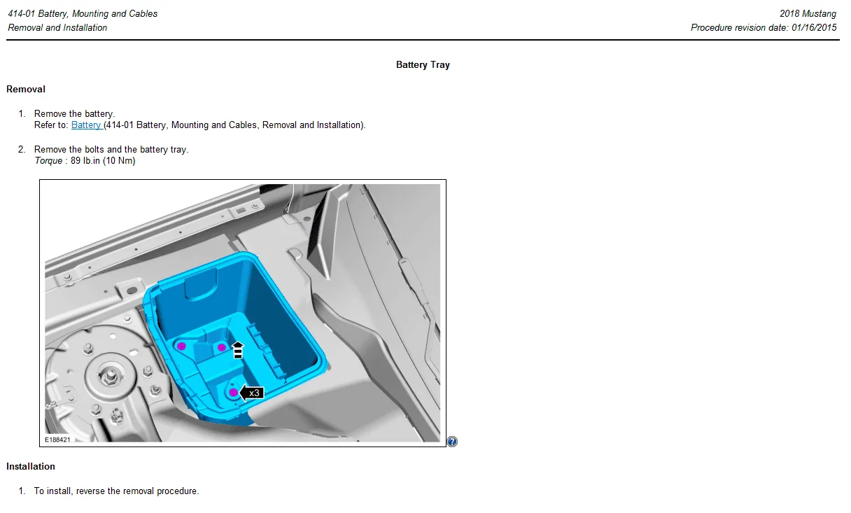

has anyone had the battery box out of an 18 up, looking to run a wire from battery to trunk for am upcoming sub woofer. There is a rubber grommet on fire wall just in front of inside fuse panel that would be perfect route but it's behind or just below battery and I can't even see it let alone get a hand in there. If the battery box comes out fairly easy it would be handy to use rather than run across to driver side. Thanks Jim

Thanks MegaG, it never occurred to me to hit youtube should've known. I did about 40 years for Norfolk Southern and a lot of that was electronic wiring, you do nice work-very clean set up. Jim

:cwl: whoops, oh well thanks anyway confirmed what I was thinking of trying! Jim
