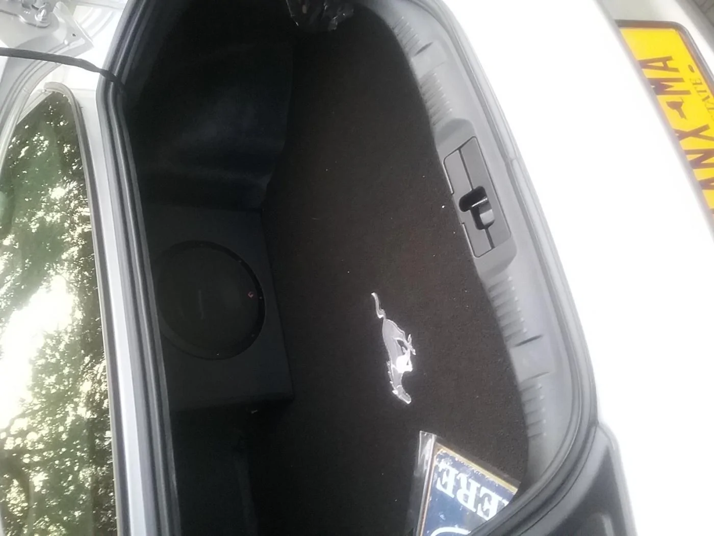

Anyone have a picture of a rockford powered sub installed? I dont want booming base just something to actually play the low end a bit

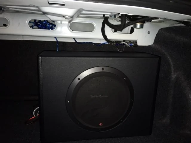

Rockford Fosgate p300-10. Small footprint big sound

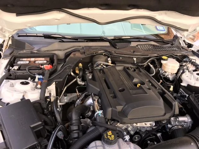

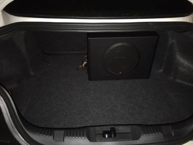

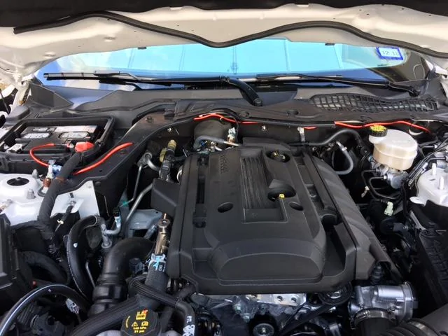

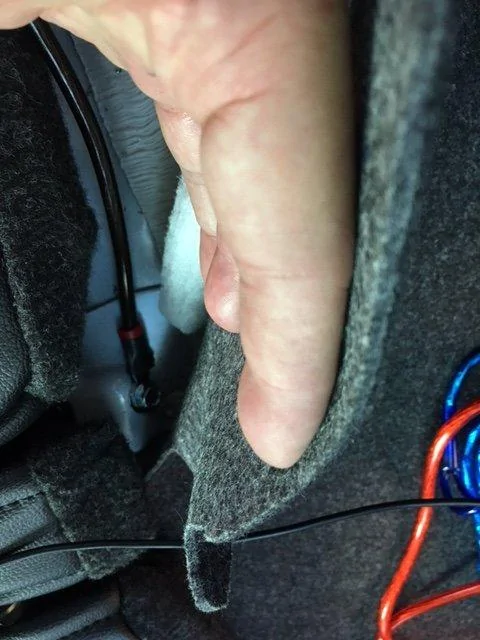

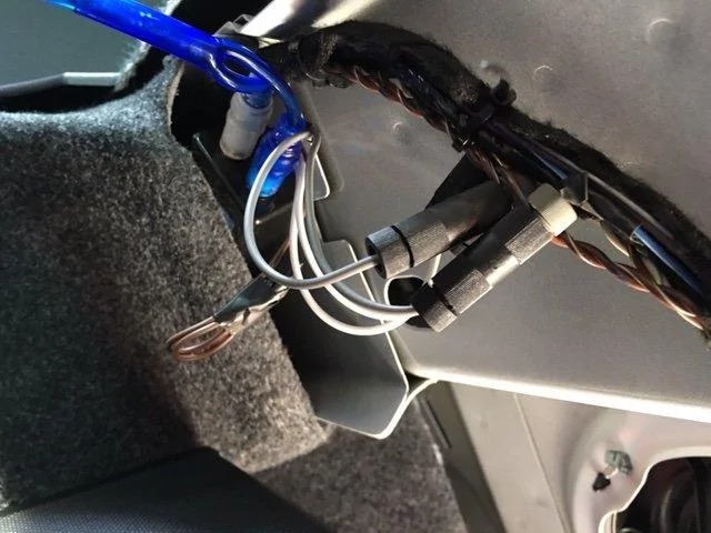

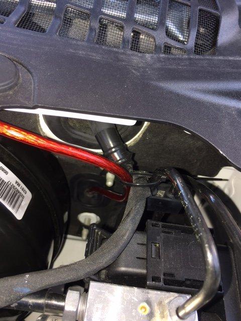

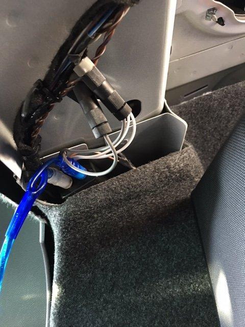

First off I'd like to thank Edwin for the great info and the subsequent contributors. This is my first post and I'd like to add that I too installed the Rockford Fosgate P300 10" sub and wanted to add some additional info in hopes it will help someone.
This install was a breeze and here are some tips below to make it even easier:
1. I didn't cut any wires or solder, I used Posi Taps to tap into the rear speakers. Super fast taps, very secure, and just so so simple.
2. I used a LOC because I wanted to keep the proprietary RF plug in tact in case I decide to sell it someday.
3. I did not run a remote wire since this sub allows you other options and I used "Audio" on the sub panel settings and it turns on and off perfectly.
4. I created my own ground right behind the seat belt bolt in the center that others have used. Just preferred to make one and avoid the seat belt bolt.
Here are some pics of my install. I ran the power wire inside the car, through the grommet on the driver's side. I've seen others run it outside the car on the passengers side, but that just makes me super nervous.

Running power from the battery is very simple, see pics in above post. Also, you may not have to run a remote wire since you're tapped into the speaker wires. If your sub is set to auto, it will sense the signal from the wires when the car is on (also stated in your manual). As far as the hum, double check your ground or, depending on how old the sub is, might be a sub going bad but that may be the last reason.
