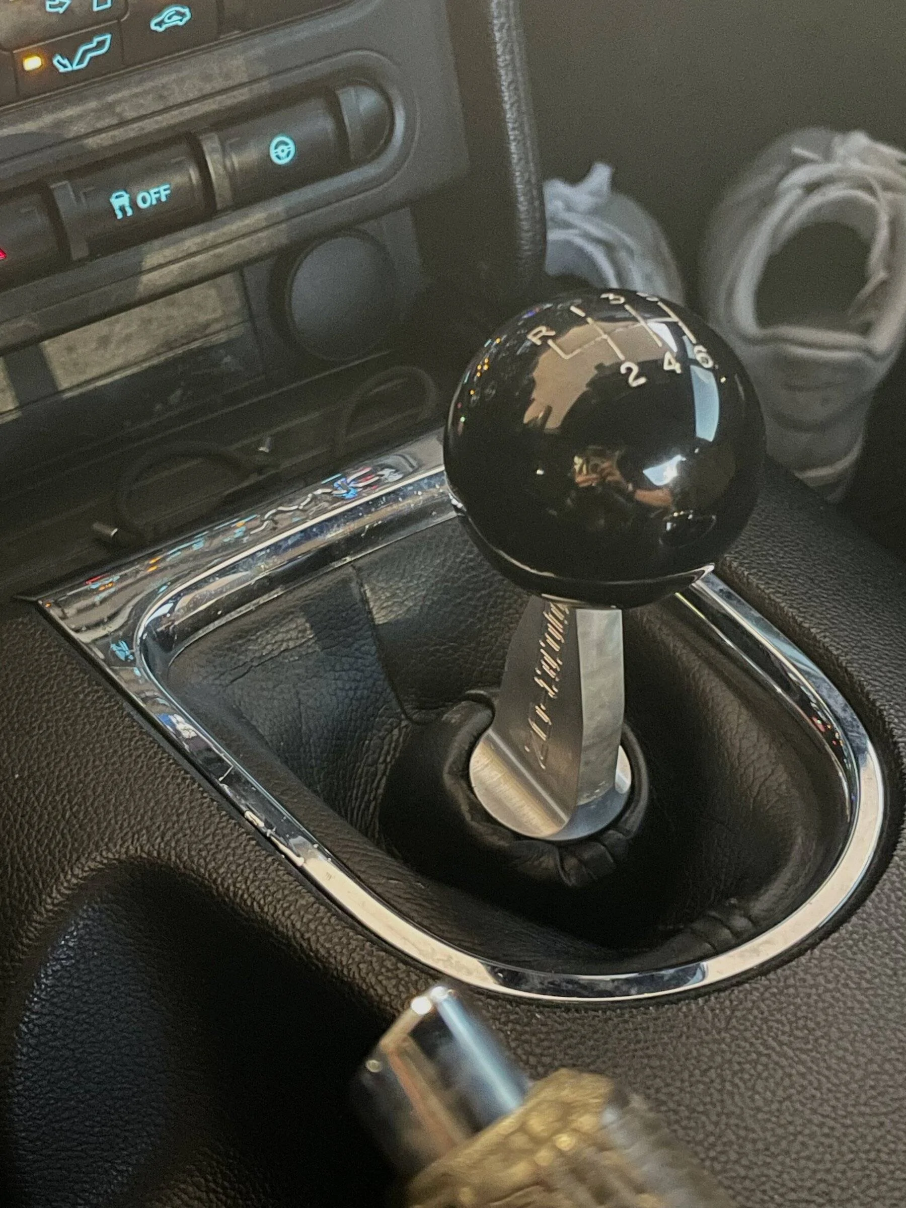

I’d like to start off by saying I did so much research on weither to go with the barton or MGW shifter. I pulled the trigger and went with the barton and i cannot say i’m not blown away, the feel, the look, just everything. I don’t want to start a MGW vs barton thread, rather i’m just giving my insights on the barton hybrid 3 shifter for anyone who is on the edge. I went with the barton mainly because there was the option of body or trans mounting in case i wanted to change it later, I also love of how the flat stick looked (and because it came with a simple black shift knob). Then it came down to the flat stick or the pull up collar. Before i had an issue where the reverse collar would wobble at higher rpm’s, i knew it wouldn’t be the case on the barton but i still didn’t want to deal with it. 550 dollars and 4 days later a package from AM shows up on my door step. The happiness ensues. Not going to lie it took me 6 hours and my hands are scared but it was all worth it. Watch the video and did the best i could. Keep in mind i’m 16 and weigh 120 pounds so the times where muscle would do it in 10 minutes it took me 30. My father offered to help but i declined. I had it on the 4 post lift it his diesel mechanic shop and dropped the exhaust from cats back. Unbolted the drive shaft let it hang and unbolted the trans mount and let it tilt down with the help of a trans jack. You could do it on the floor but i wouldn’t recommend. Few hours and cuss words the world has never heard later and it’s finally in. Shifts are absolutely incredible, not trying to meat ride the boys at barton but man this is amazing. Notchy but not to notchy, stiff but not too stiff. Just incredible, Mild NVH but that’s what you’d expect with a trans mounted shifter. If your on the edge on which one to buy i hope this helps you make up your mind. If you have any questions please let me know. If a scrawny 16 year old can do it, you can too.

Nice! I really like the look of the flat stick too. How does the reverse lockout work with that setup?

You have to push down on the whole shifter, it takes some force so you’ll never accidentally go into reverse instead of first, takes some getting used to but i love it

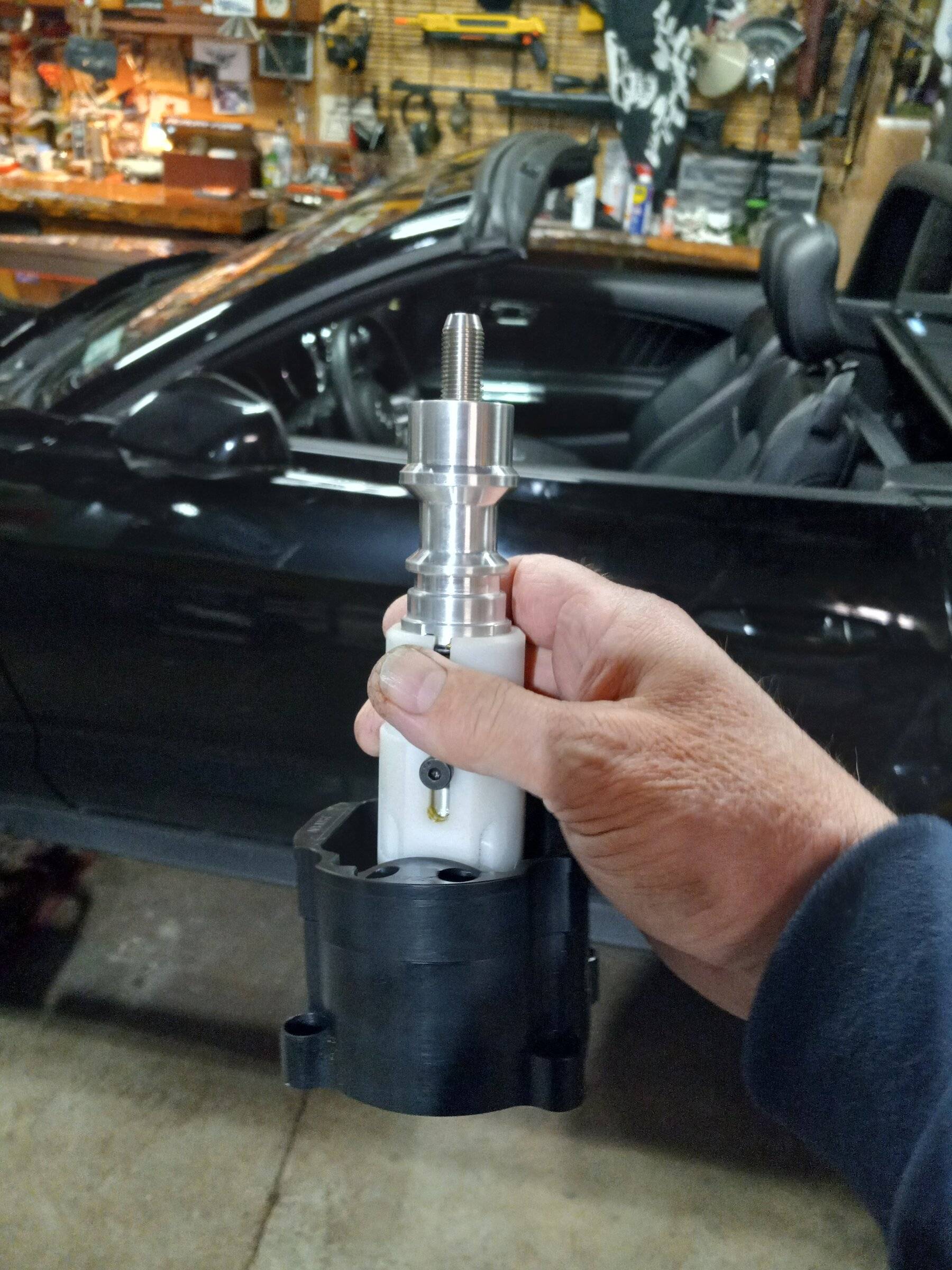

Installed the short shifter a couple weeks ago...tried it with the springs in...then removed the springs..much smoother without them
