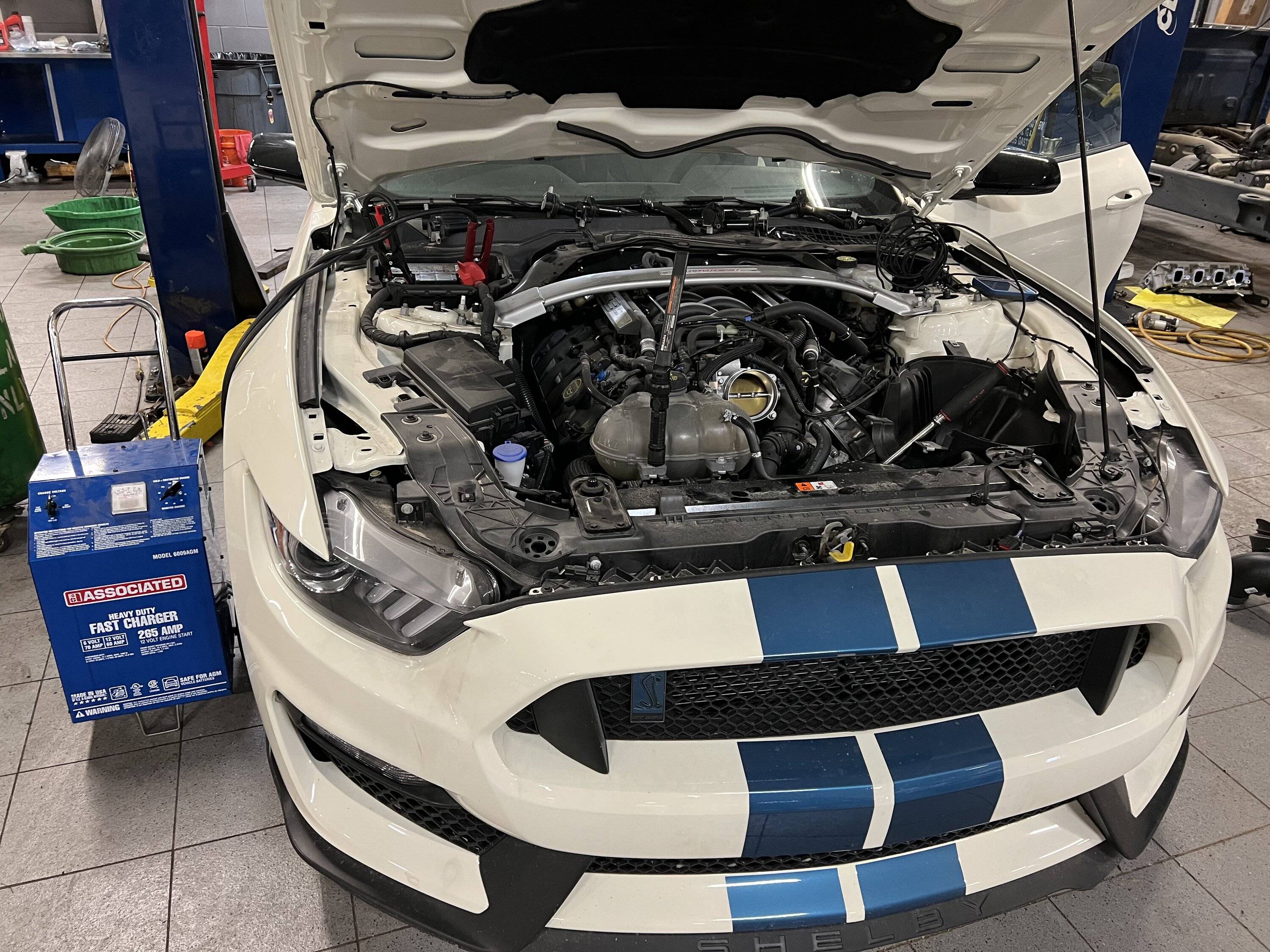

Another update: dealer swapped the coil pack and spark plug on the cylinder throwing the misfire code. However the bigger issue is that the engine is making a metallic noise when running. Dealer suspects connecting rod bearings. But that's purely a guess since they don't have the tools to investigate further and it would require a engine tear down anyway.

Update:
Bit of a plot twist this afternoon. I had a lab analyze an oil sample and their conclusion is that while the oil needs to be changed, there is no excessive metal in the sample. I also have Blackstone reports covering the first three oil changes and ~6k miles on the engine and this reading looks in line with those in terms of iron/copper/etc. deposits in the oil.
Which makes me wonder if there really is fatal mechanical damage to the engine. Could it be that the timing chain slipped instead? Would it make sense to have an indy Shelby specialist check the chain on the side you can't see through the oil filler opening? Am I still screwed even if it's "only" a slipped timing chain given that the Voodoo is an inference engine?

We have very little information on this... a timing chain will not slip it there wasn't a ludicrous amount of slack in it, and by that time you would be already hearing it.
The car also is quite new so is the chain.
I don't know if you are mechanically inclined but "the engine is toast" is not a professional diagnosis. The dealer your brought the car to must give you a clear explanation on what happened to the engine, what is broken and what is the chain of events that put the engine in the current condition.
If they can't provide such explanation then I would have the car towed to a reputable shop. Yes it's a Shelby but still a car so generic logic and craftmanship still applies. A good mechanic is better than a shaved "certified" ape with whatever logo.

If bearings are damaged, then there'll be visible metal in the oil pan. Oil analysis only looks at particles measured in a few nanometers, invisible to the naked eye. Drain the oil and see what you find in the oil itself, by wiping the floor of the sump through the drain hole and in the filter.
Thanks, good point

Diagnosis from the dealer in Texas came through yesterday: dropped valve.
