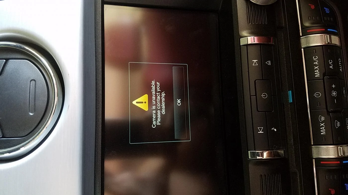

I just bought a 2016 EB Prem Conv and have the exact problem you described. Someone previously tried to fix the wiring harness. The job looks clean as if an electrician did the work. The back up light does illuminate. The fuse # 66 (Blind spot information system. Rear view camera. Air conditioning compressor relay coils.) was blown and I replaced it but still no back up camera. I have not yet checked for voltage at the camera and I have not yet replaced the camera either.

There is now a recall for BUC camera harness, however, like the door lock issue, parts are in short supply.

Welcome to the forum @ASLGiddyUp. Just FYI, you resurrected a 5 1/2 year old thread. A lot has happened since then.
