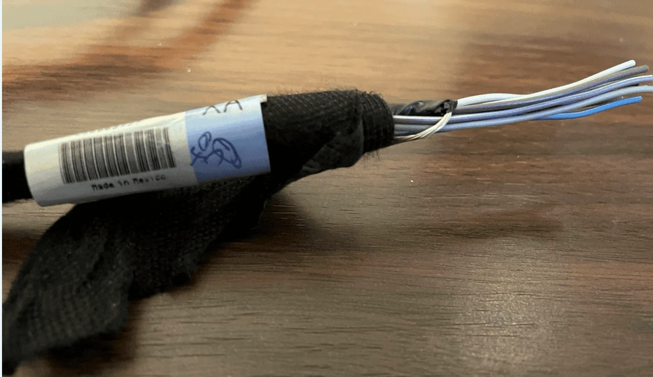

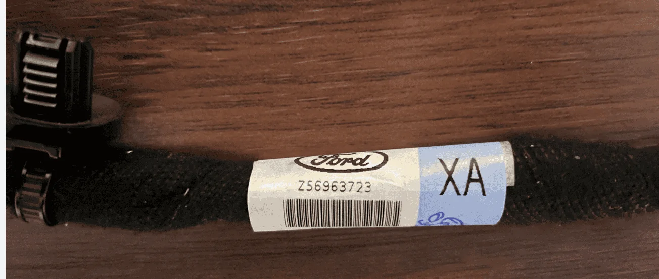

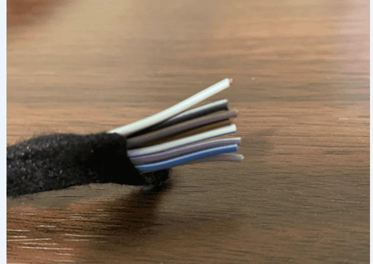

For anyone that bought the TSB harness FR3Z-14A411-X, did it have 8 or 9 wires at the end? I just got mine and it only has the 8 insulated wires, the bare wire that is part of the shielded 3 was not present.
Will it work without having that?
Picture of the harness I got from https://www.ebay.com/itm/333436243591
It will probably not. I had to connect mine.
You have to dig a little ways back to get the shield.

2017 Mustang GT Lightning Blue
I peeled the cloth tape back a bit more to check. Indeed it has the bare wire present and taped down to protect it.
