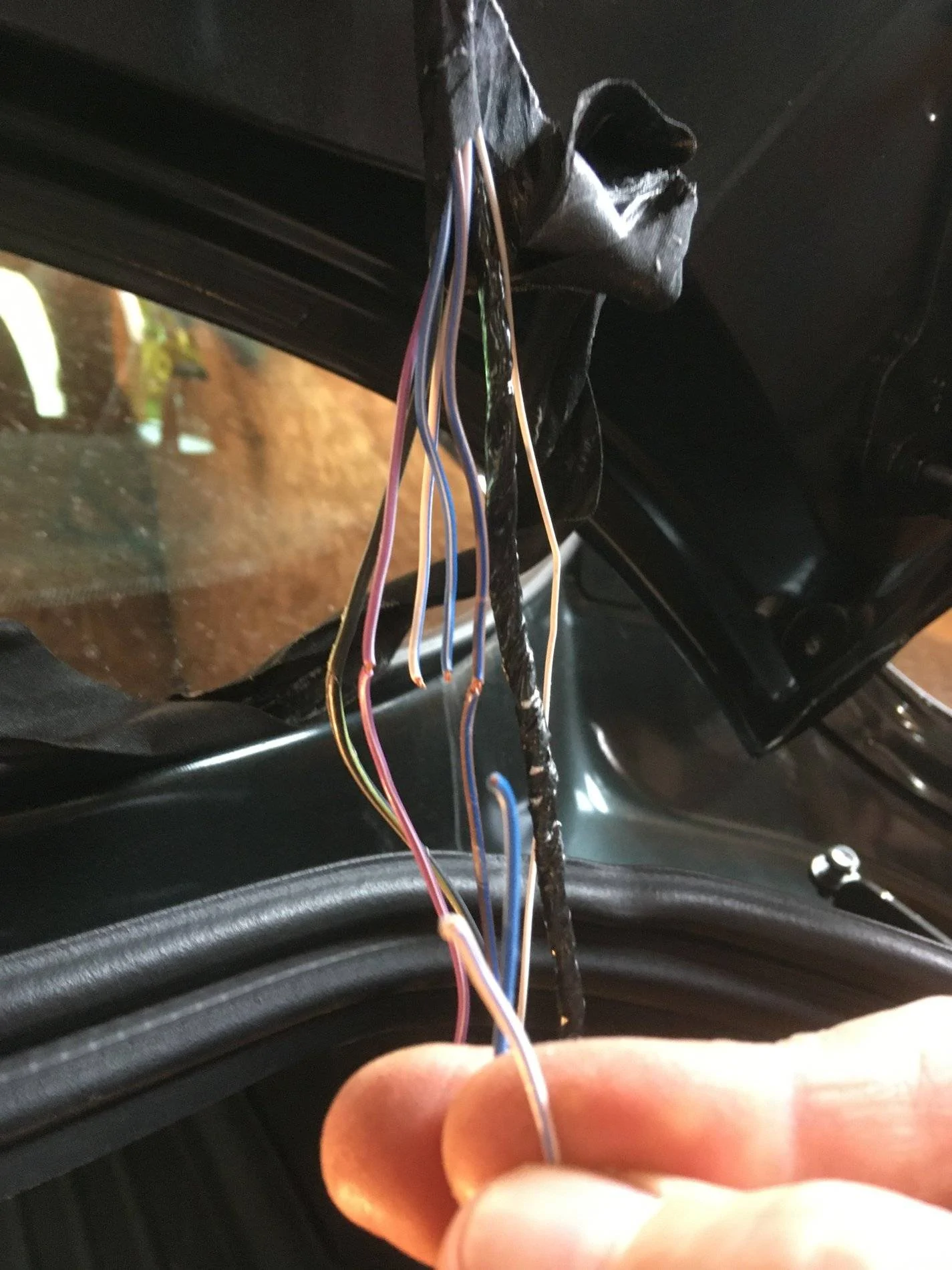

Hey everyone. I see that there are other threads on this issue but I didn't quite find what I needed and I don't want to hijack anybody's thread. So last Friday, my backup camera stopped working. I found a few threads and saw a potential fix. I saw where the zip tie was possibly causing the issue, pulled back the sleeve, cloth and electrical tape and found that none of the wire had an issue except for the set of wires all wrapped together with what looked like silver tape. This set had 3 wires together and one of them appeared to be cut. Since believed this to be the issue so I cut it all the way. From there I used a butt splice to connect them all together. This didn't resolve the issue. Now, I am wondering, did I need to splice those 3 wires individually? I spliced them all together, None of the other wires I saw appeared to be cut. I don't know if I screwed the pooch with this or not. I didn't want to take it to the dealer (don't have the time and don't want to spend the money). Plus even with an extended warranty, I don't believe me doing what I did to try and fix this; that taking it in is even an option at this point. Sorry for writing a novel. Any help you guys can throw my way would be really appreciated.
