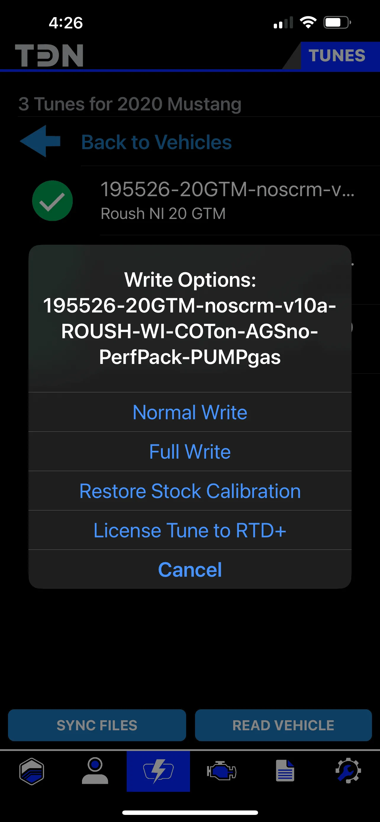

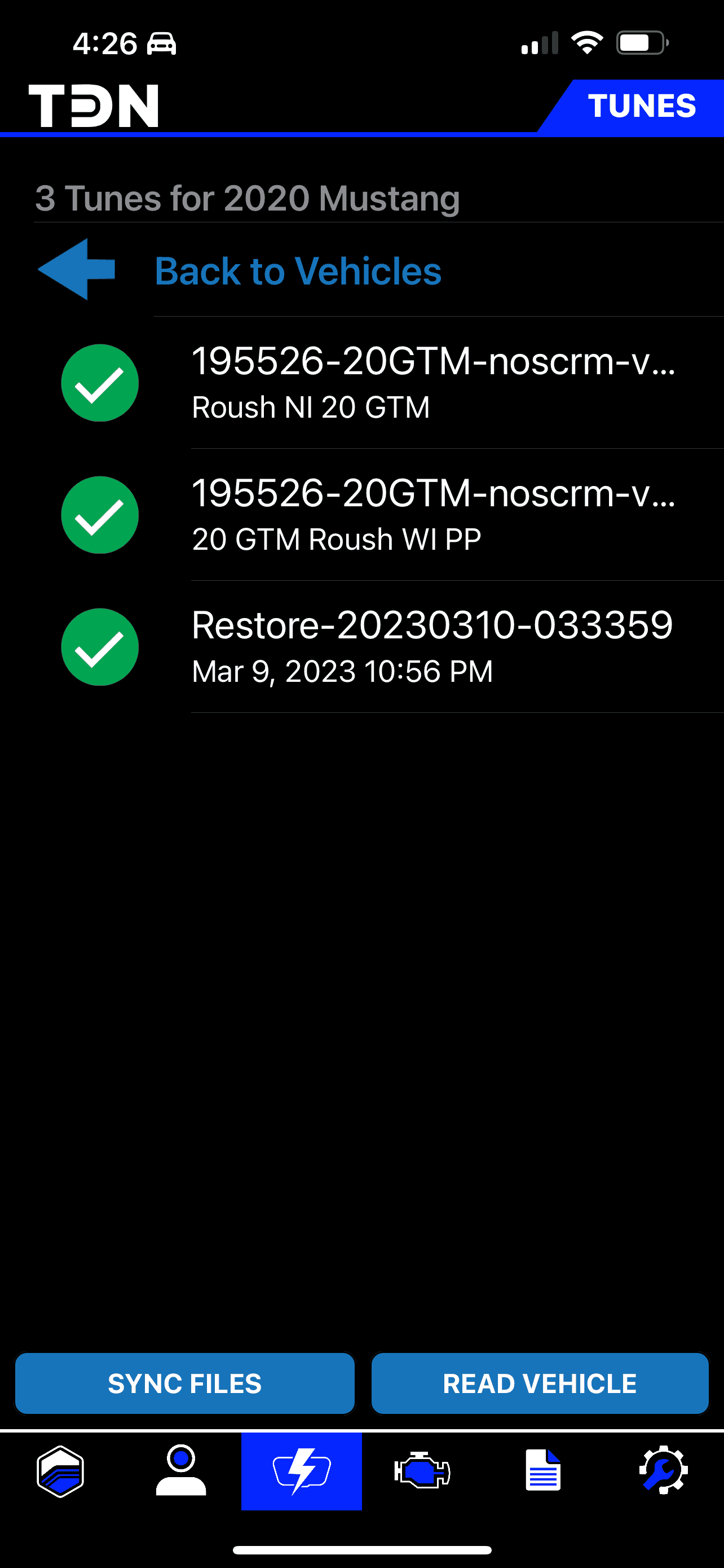

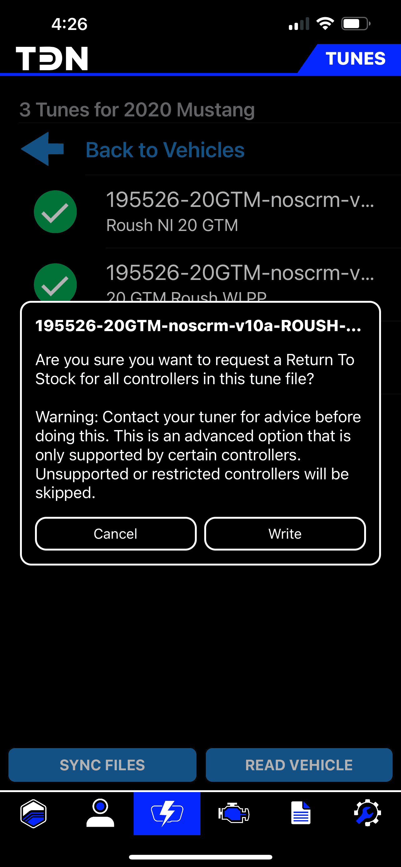

There’s been a recall on the Mustang which includes my 2020 pp2. But I have a Lund tune back in March 2023 which has to be removed, dealer request, upon fixing the recall which has to do with the car computer. I reached out to Lund and they sent me the stock file, but I think I need to be a bit clearer before proceeding to start with this process. That’s why I am reaching out for, perhaps, a more defined or polished help. I have attached 3 photos as far as the process I started, but didn’t proceed. Thank you for any help!

The restore file should be your stock file.

Just ran into this today , when tech starts an IDS session they need to do a manual VIN input then select aftermarket calibration . Then they can configure or recalibrate the BCM .

Well, when I took it in this past Friday for the recall I didn’t know that it was involved the computer reading. That’s when the tech told me that because of the tune he couldn’t access the computer to complete the recall issue. I do have a Roush cold air intake without insert though, but was able to remove it and getting ready for the appointment, after removing the tune, put back the insert, the car is running good.

Do you guys think the tech took it off before performing the remediation for the recall?
No, Lund locks the computer. Not even Ford can access it.
