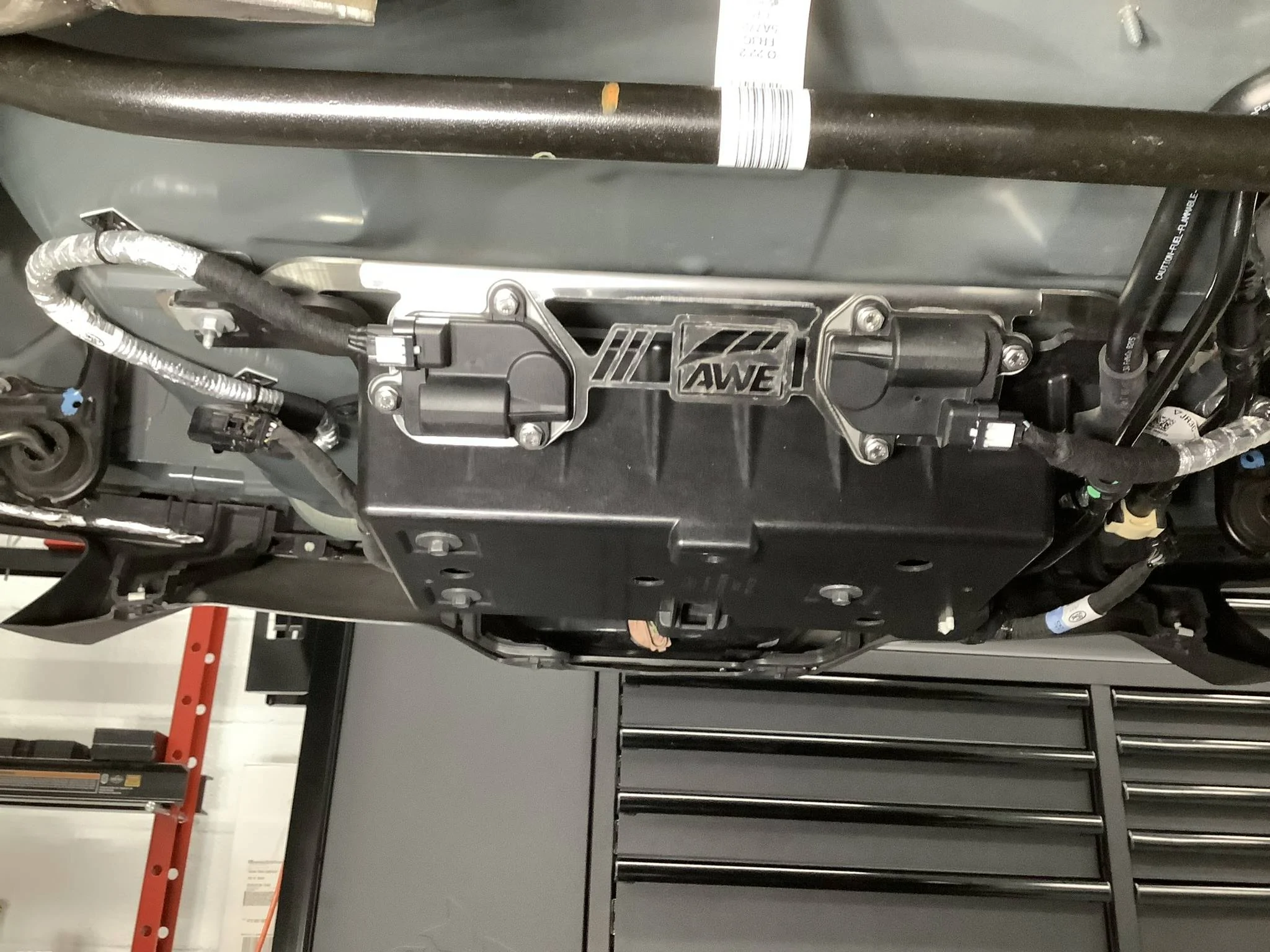

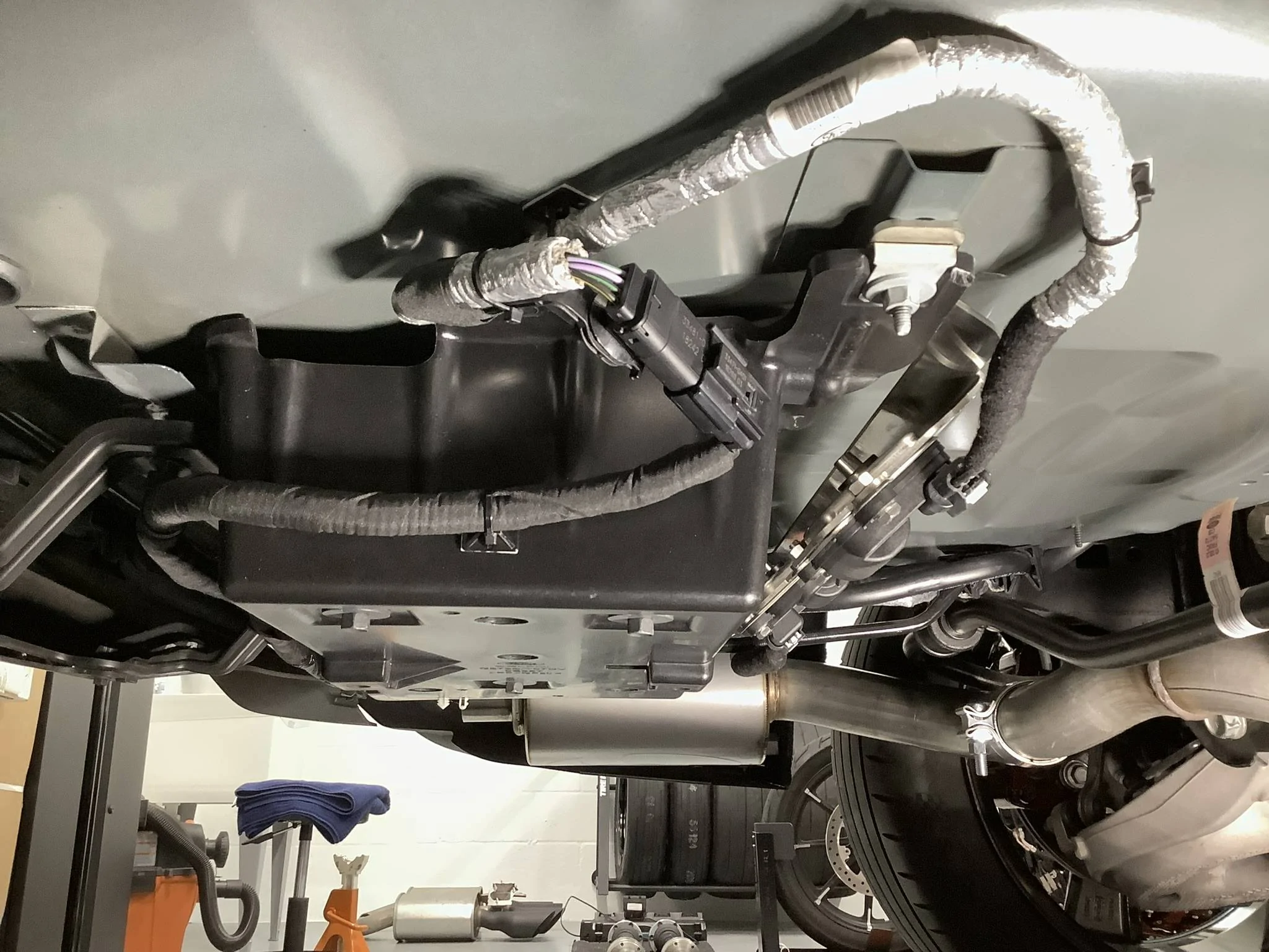

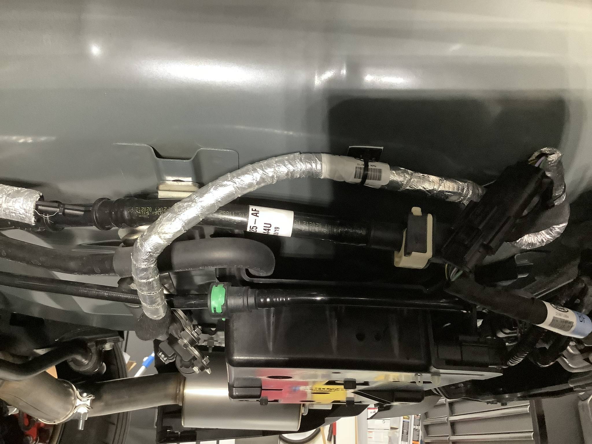

No codes or warning lights on the dash after disconnecting the AE. I bought an AWE bracket and mounted the actuators in it. This allowed me to keep everything plugged up to keep the PCM happy, as it sees the system as functioning properly.

N60T8R, thanks for the reply and excellent pics.
