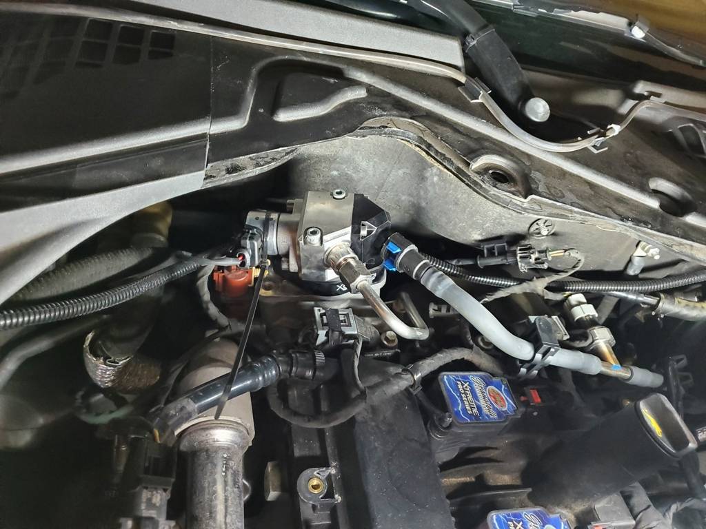

Installed Xtreme-DI Evo today and uploaded the base 91 Oct tune for it. Once that's finalized, it'll be 91 Oct + WMI, followed by E85, so it'll be a few weeks before I can realize the benefit from it.
It didn't come with an install guide and I couldn't find one online for Mustangs, so I referenced one for Focus RS. Only useful info I got out of the RS guide is clocking/bolting the pump and torque values. Fortunately, swapping HPFP's a pretty straightforward process and there are less steps involved for the Mustang compared to the RS due to easy accessible. The hardest part was gently bending the metal high-pressure fuel line to fit the new pump as it was almost 1" off compared to the stock pump. Idle test and a short drive didn't show any leaks, so I'll proceed with datalogging for the 91 Oct tune this weekend.

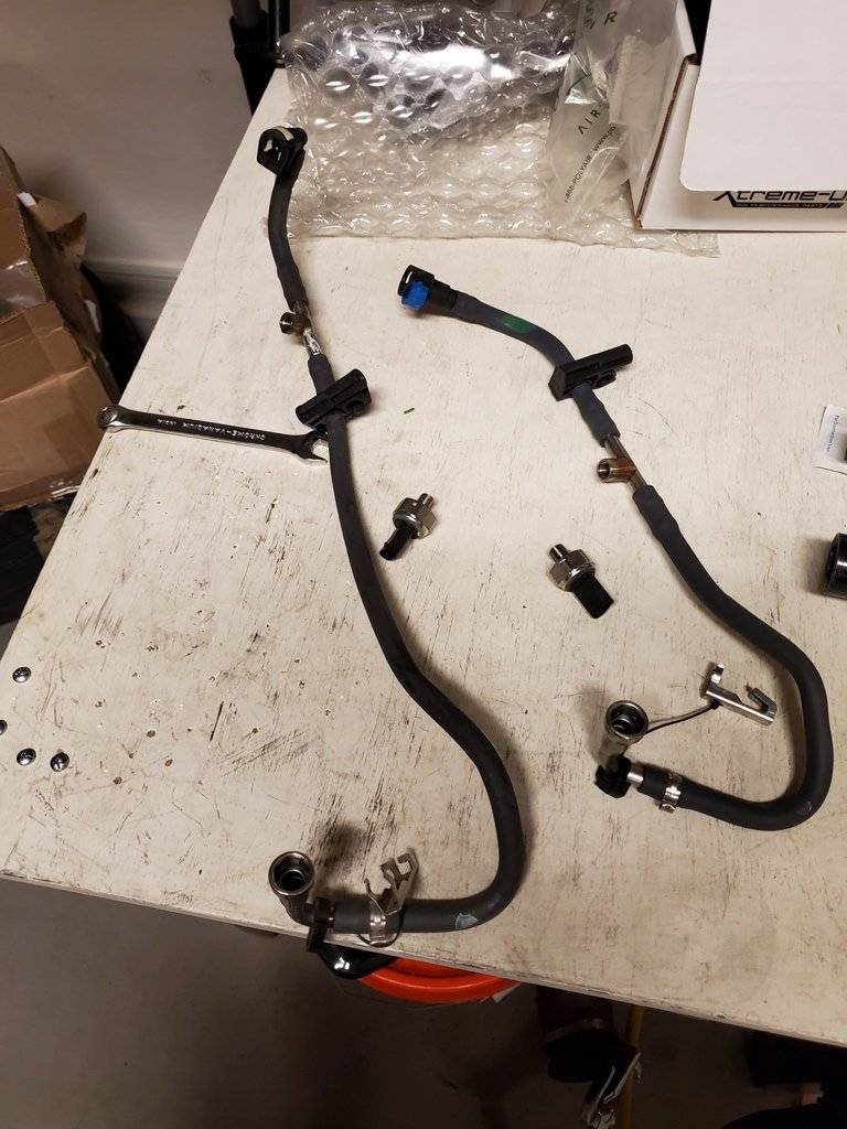

Evo kit:
Pump
Pump harness extension (the socket's on the other side of the pump compared to the OEM one)
4 bolts
Shorter low pressure fuel line with the pressure sensor
Tools used:
5mm Allen drive (for Evo pump mount to the block)
3/16" Allen drive (for Evo pump to the pump mount)
8mm socket (for OEM pump to the block)
10mm socket (for bracket around the OEM pump)
17mm socket (for turning the crank until fuel pump lobe on the cam's at its lowest position)
17mm combo or flare nut wrench (for removing the hard high-pressure fuel line)
Fuel line disconnect tool (for removing the low pressure fuel hose by the firewall)
Trim removal tool (handy for removing various line holders)
The kit's low-pressure fuel line's on the right side. It's shorter to accommodate for the fuel inlet location of the new pump. It came with the old style sensor that's known to be unreliable. I previously swapped to the new style, so I just swapped the senor over from the old fuel line.
This is the pump as installed.

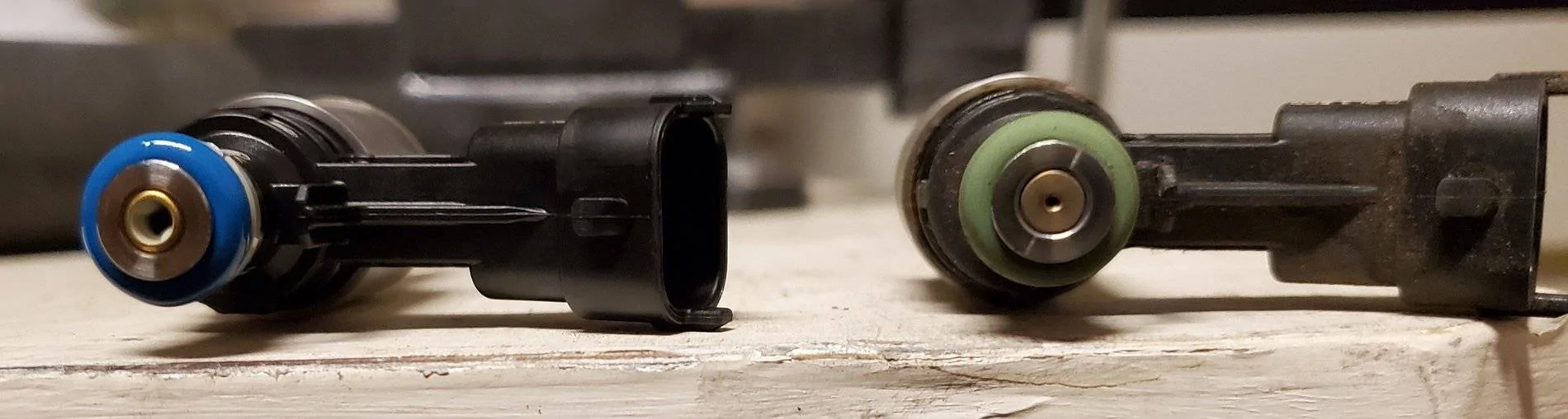

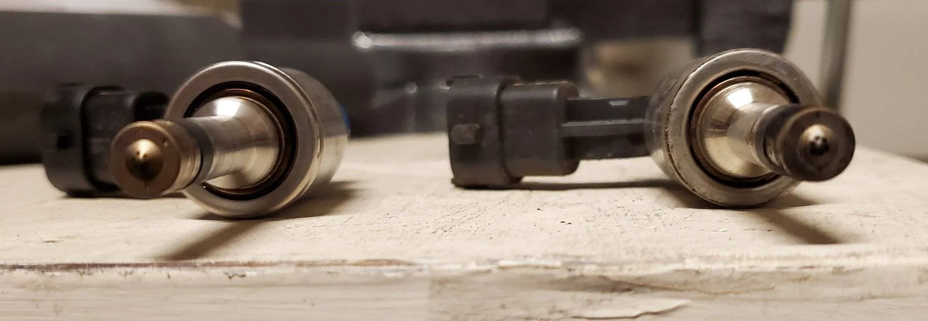

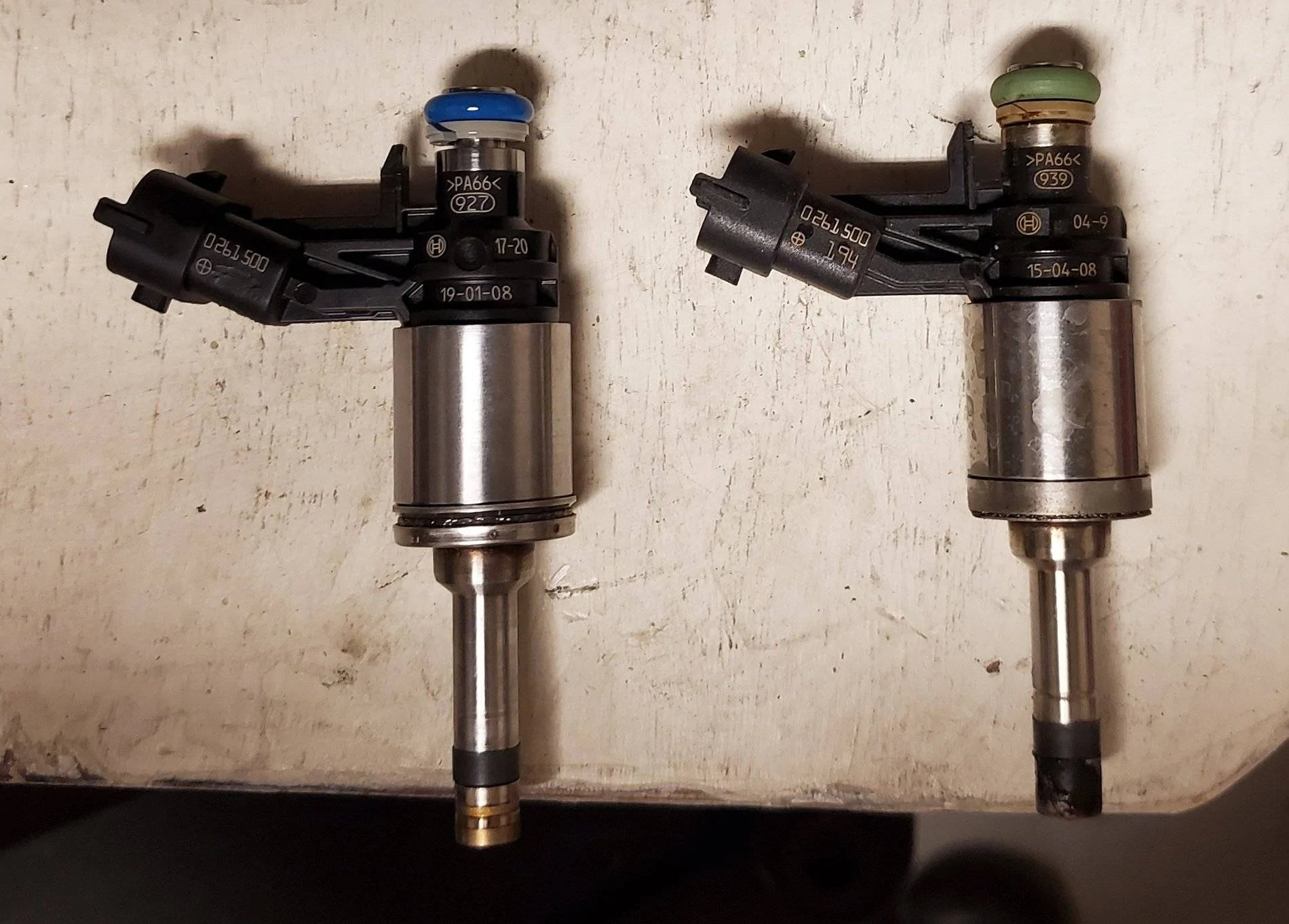

XDI2050 injectors finally arrived today! XDIs are on the left and OEMs are on the right in the pictures. They look about the same from the side and nozzle views, but XDI’s inlet is definitely bigger. The fourth picture shows XDIs mounted on the fuel rail, ready to install.
None of the OEM injectors were stuck to the head as they all popped out along with the fuel rail. If any of them were stuck, the injector puller (cheaper Chinese copy) would’ve worked as shown tested on an injector in the last picture.
