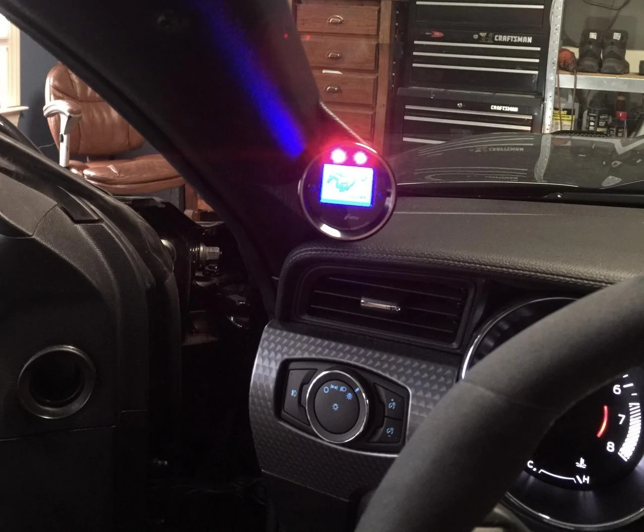

Was the original A-pillar easy to remove (and was the AM piece easy to reinstall)?
How do you like those gauges? Do they dim down at all, like as in, tied to your factory dimmer switch?
The original pillar is held in by a few clips and it pops right out. It was a little tricky positioning the new pod and aligning the clips but it fits great and looks even better. The gauges themselves are pretty damn impressive and since they are scan gauges you simply plug them into the OBD2 port and viola! No need to splice any wires and you have access to many different parameters which is extremely nice. They do have a dimming feature but i don't find them to be too bright. Been pretty busy lately but will try to grab some better pictures this weekend. Highly recommend this pillar pod for anyone who is considering it! The instructions that come with it are pretty spot on as well!:cheers:

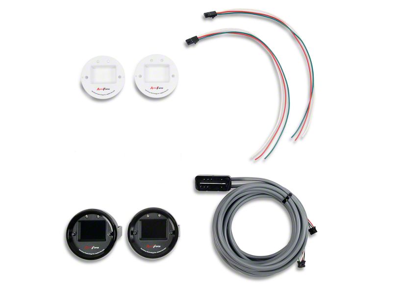

Was wondering how you got two gauges hooked up? Done they each need the obd2 port?
Nope! The dual package comes with an OBDII plug with two separate cables out of it. See the picture on the bottom right.

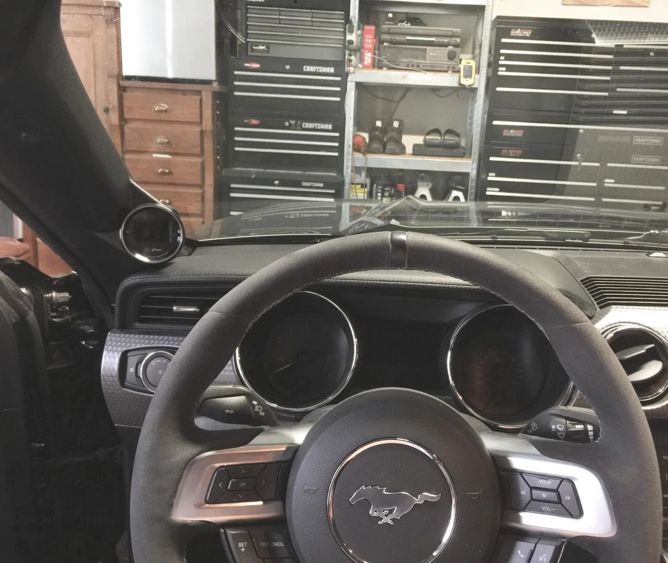

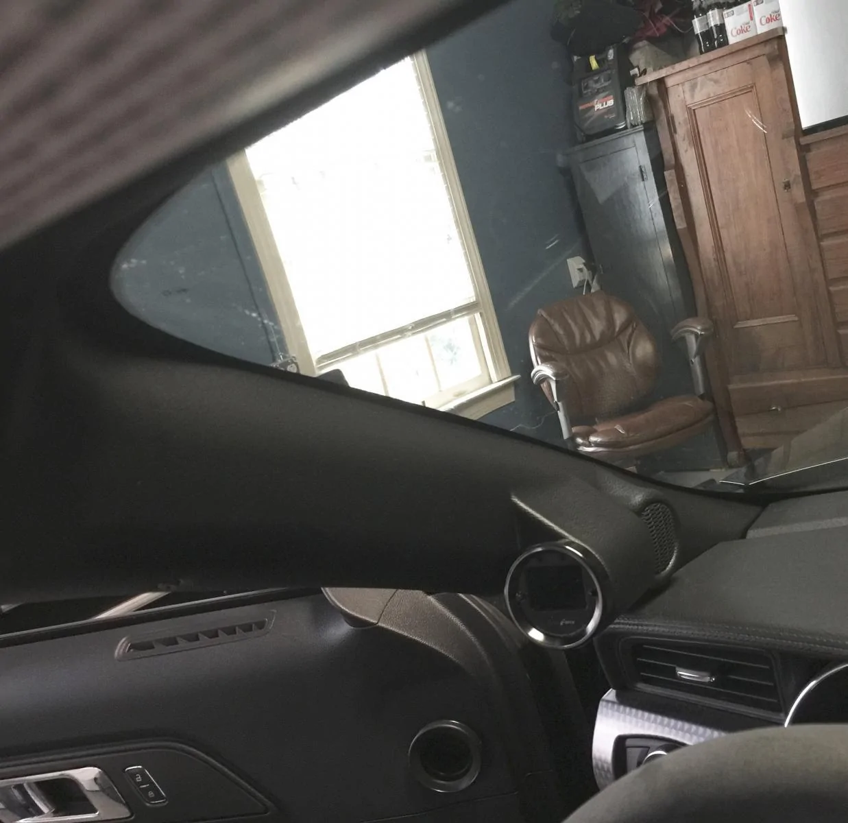

I installed a single Autometer Pod over the holidays, and it fit pretty well.
I used a single aeroforce gauge
mulage
Aug 29, 2015
139
Central, NC
2015 Mustang GT, Black, w/ Performance Pack
and the shift light
