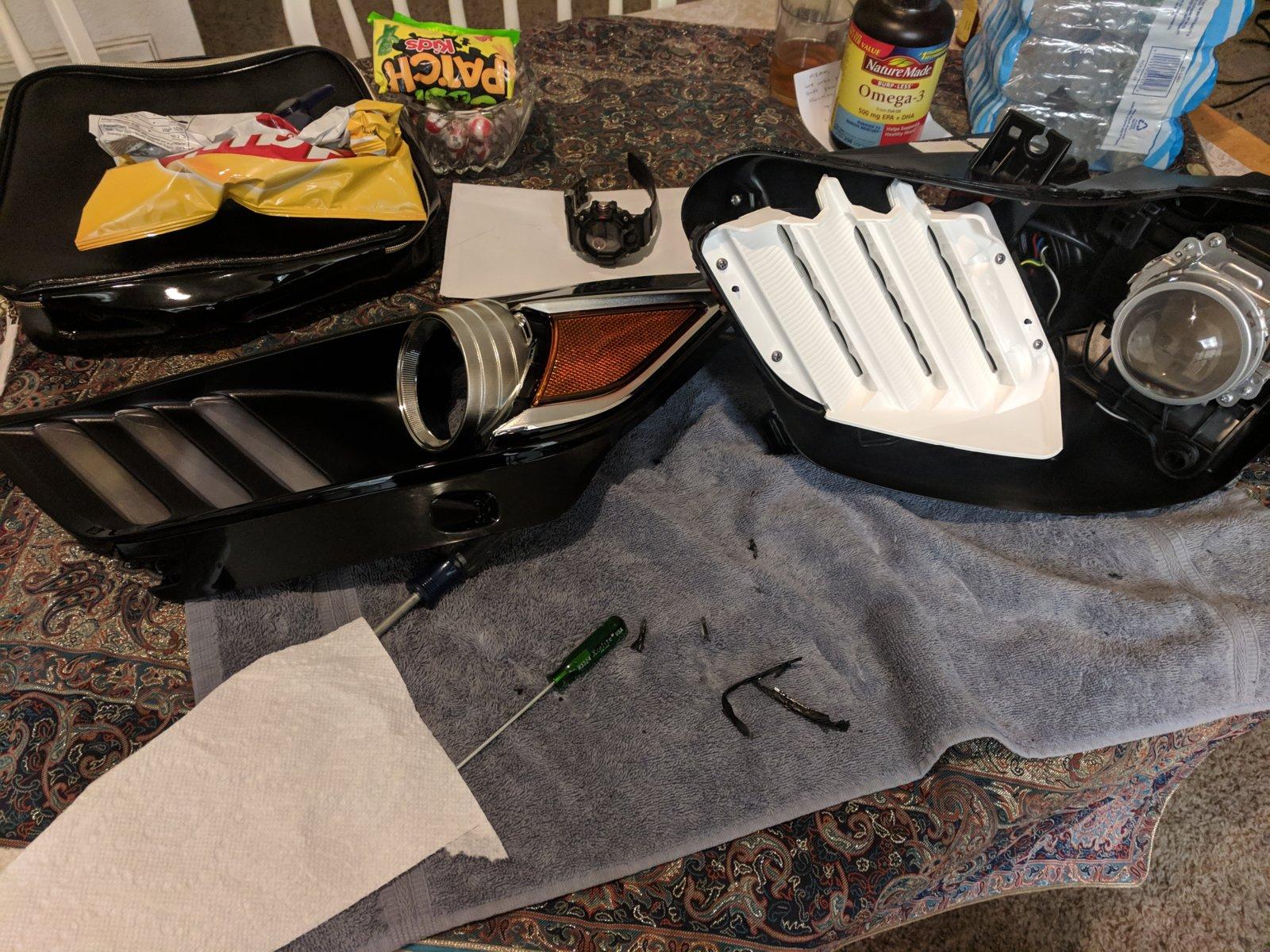

I also put RTV on the outside all around just to make sure.

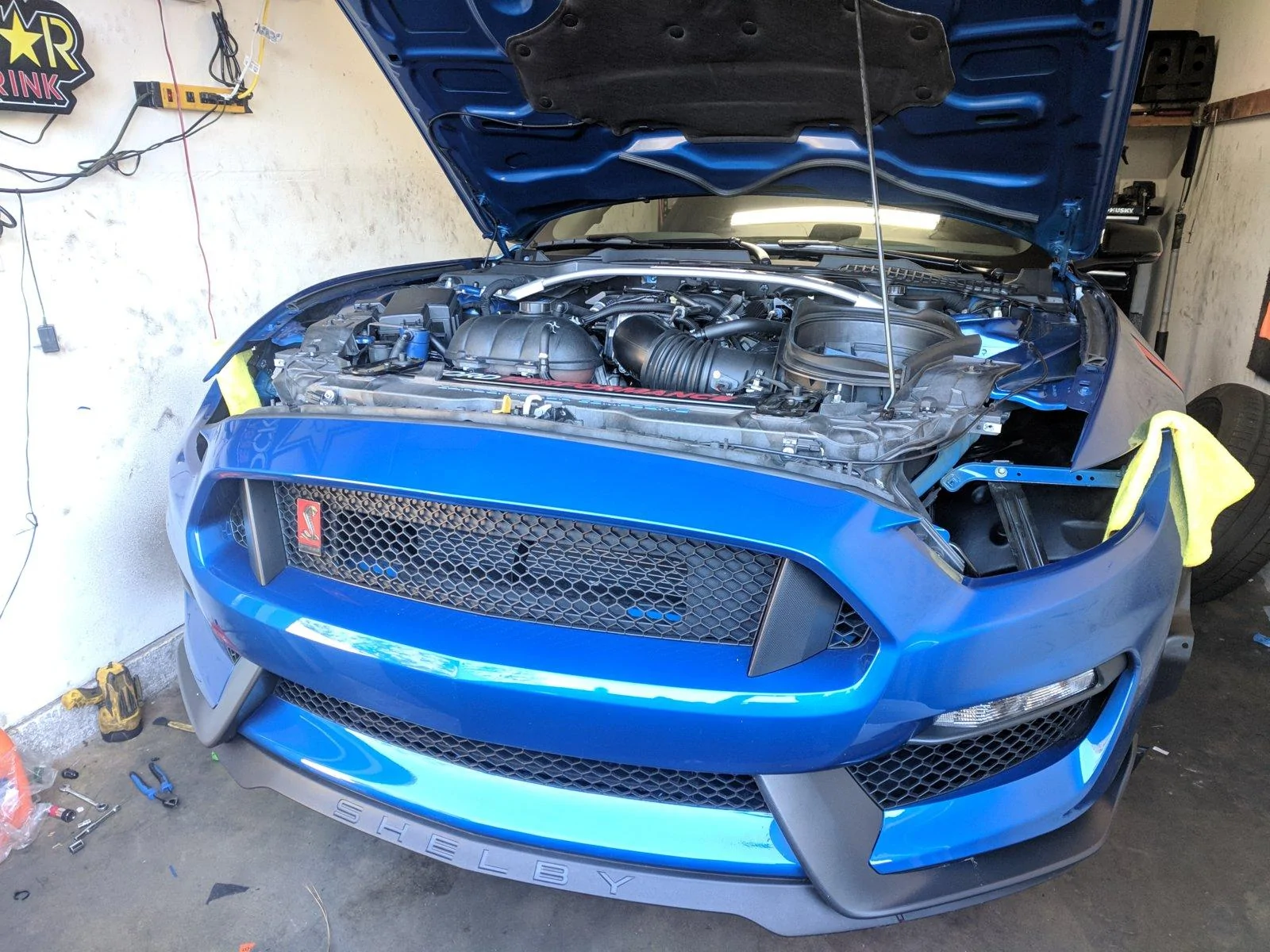

Didn't have to competely take the bumper off to get lights out. Saved me so much time.

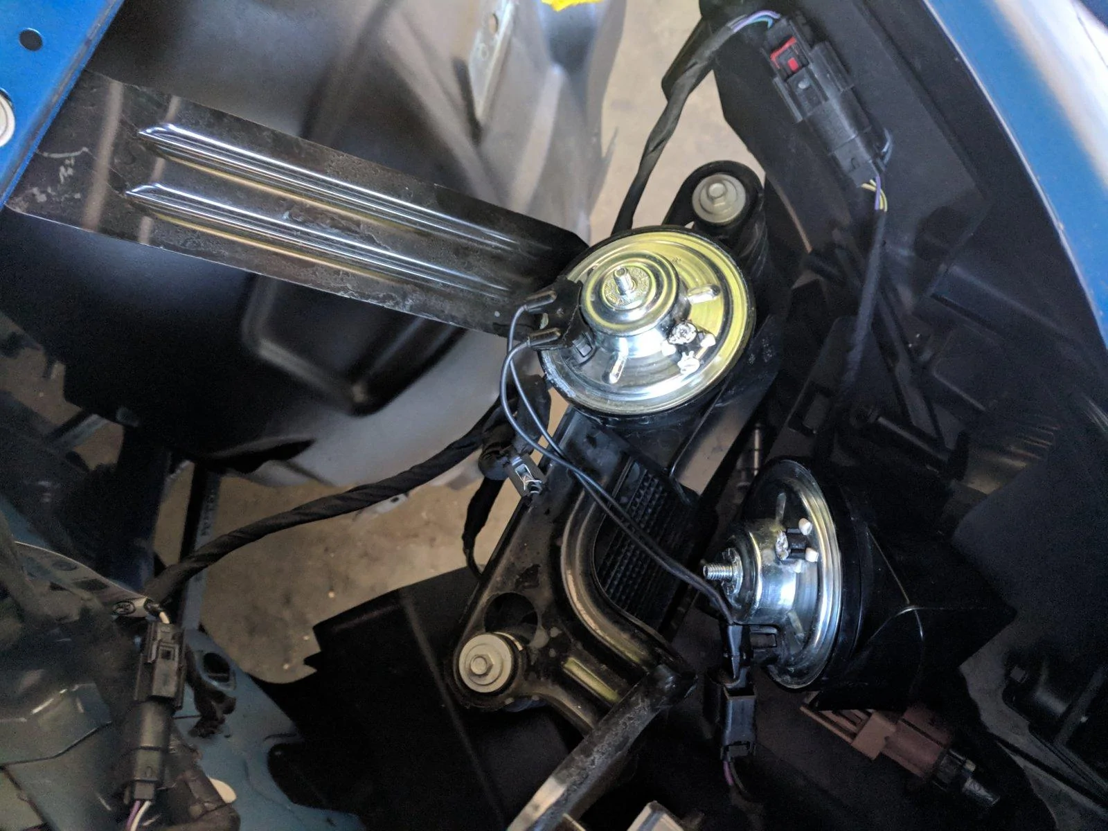

How did you get the bottom bolt out and what's the deal with "adjusting the horns"?
I used small 10mm ratchet and put my hand through the opening and opened it.

Wait, hold up...adjusted the horns to make them louder? Did you just move them around or did you actually change something to make them "honk" louder?
And you can turn the double-honk thing off with FORSCAN.

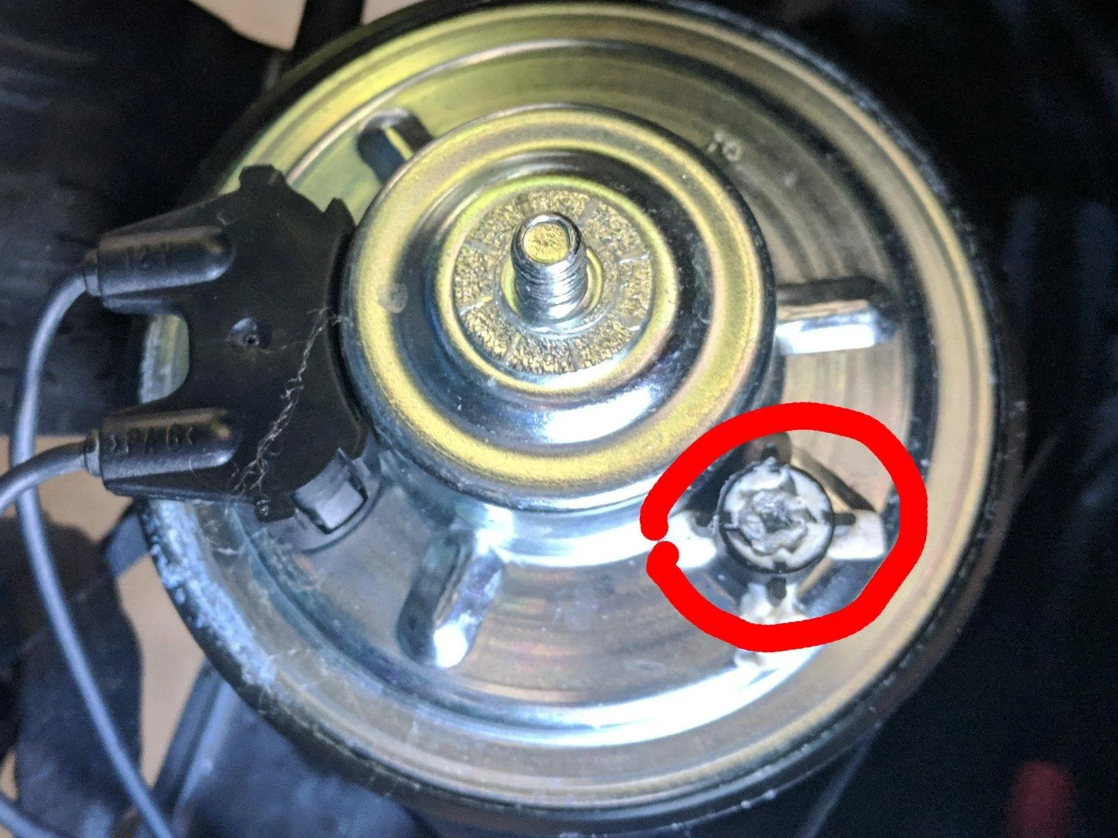

No. You have an adjustment screw on the horn that you turn to adjust the noise. It is located under the white rtv.
It is around 40% louder now. I love it.

After 3 hrs of cursing and heating finally comes off.
Right or left to make it louder? How many turns did you dial in on yours?

It took me around 30min to get it where I want it. If i remembe correctly clockwise is to get it louder. Keep on trying and you will figure it out. Both of the horns have the adjustment screw.
When done, re seal it with rtv.

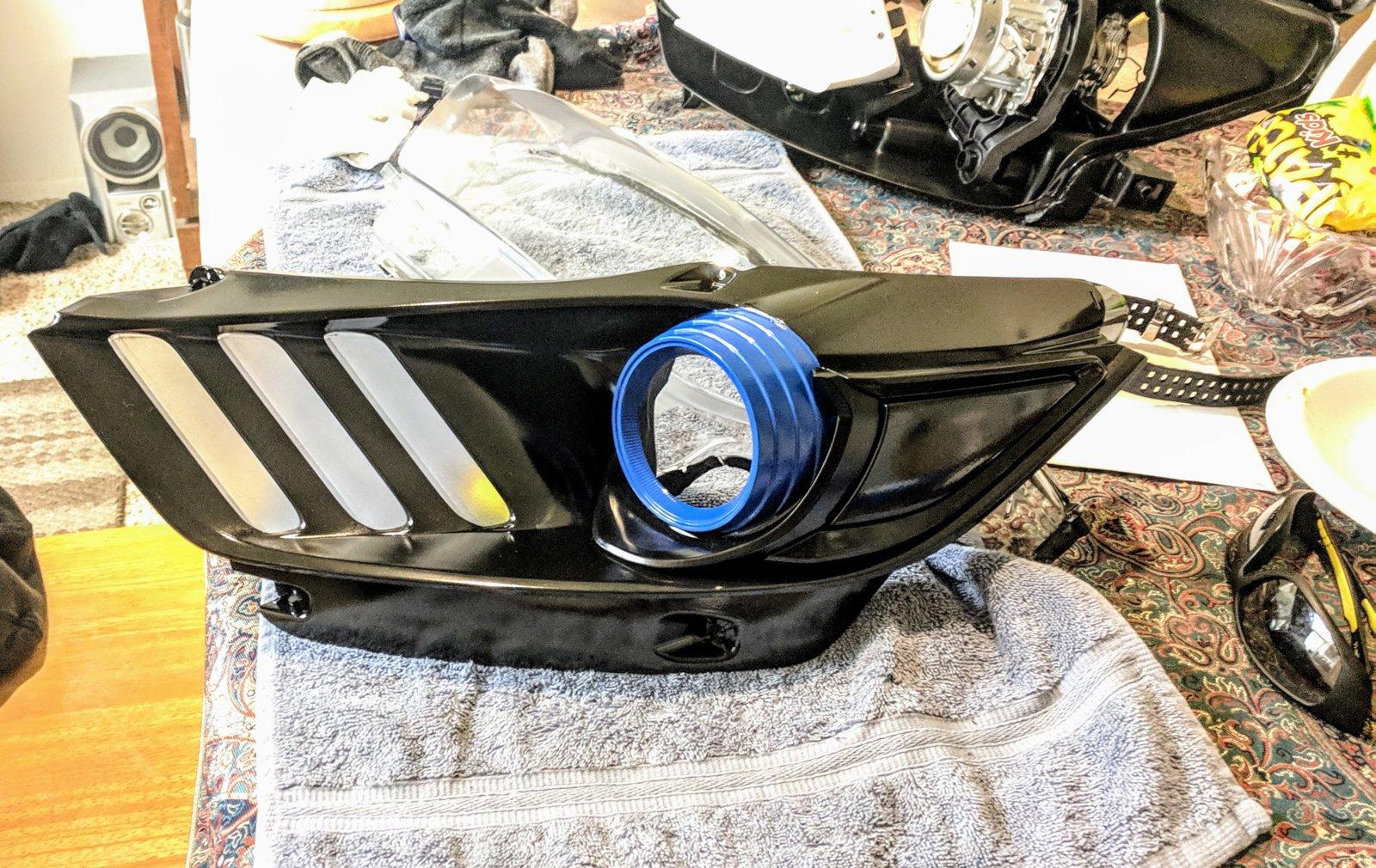

The blue is actually more darker and matches my painting. I tried 3 different cans before I made my decision.
Btw, my hands got stabbed/cut 5 times. Lol
