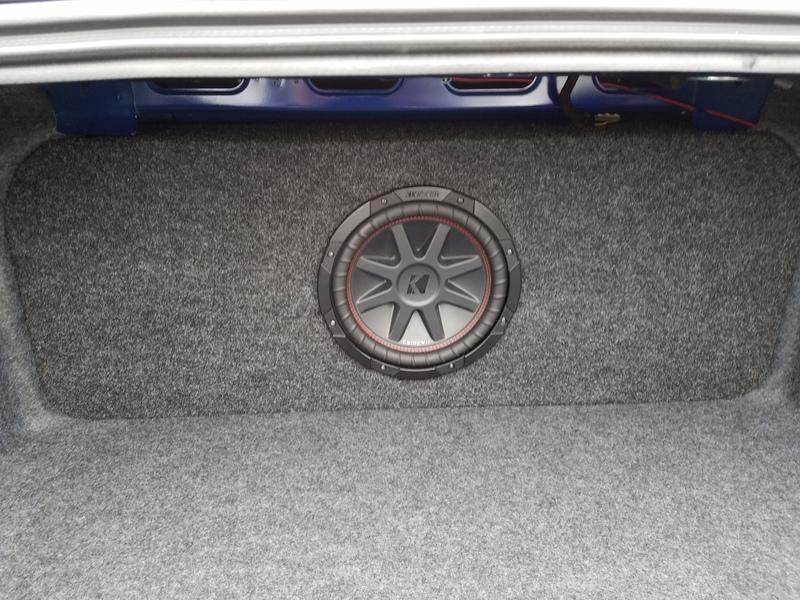

Wondering if anyone had installed the Zenenclosures single side sub woofer box? Can you tell me if it fits well and if it slides around at all. Just looks like it might want to walk itself out of it's position since its not really wedged in there, or is it a pretty snug fit?
Can access the spare tire compartment with the box installed.
Also, they offer a driver or passenger option, just wondering if it is really the same part. Looking at my shopping cart when i pick both, from what I can tell its the same part number. Just curious if it is really the same thing and can be flipped over to mount in either side.
Thanks.

heres the Zen Enclosure I have, absolutely love it! fit is spot on, it is very snug, doesnt move around at all, I still have access to the spare tire well

i have the exact box in that picture. it WILL slide around, fall over etc BUT, there is an easy fix. theres a metal lip that hangs down from the top of the rear deck. I took a small piece of wood and mounted it to the top of the speaker box. then you just slide the box in from the side so the wood sits behind the lip. once its in there it aint going anywhere. it has not moved at all since i did that even under acceleration and braking.

Thanks for the info, sounds like an easy fix. Much appreciated.
Also, thanks to the others for the other pics of what's available. Thinking I want to go one side only. The very first weekend I had my car I needed to fold the seat down and pass something long through, never had to again, don't even know if I ever will, but thinking the single side is what I want to do.

Not sure that the box could just be flipped and fit on the other side... looks to me like the corner radii are different between top and bottom.
As for securing the box, you could also add some strips of Velcro on the bottom to prevent it sliding around.

Does this one allow easy access to the spare tire or is it blocked?
thats the same style I have, yes I have access to the spare tire well.......

FYI I had one and it fit great but would fall backwards under hard acceleration. I made a little bracket and it was perfect after that. I've since sold the car but still have the box of anyone's looking for one.
