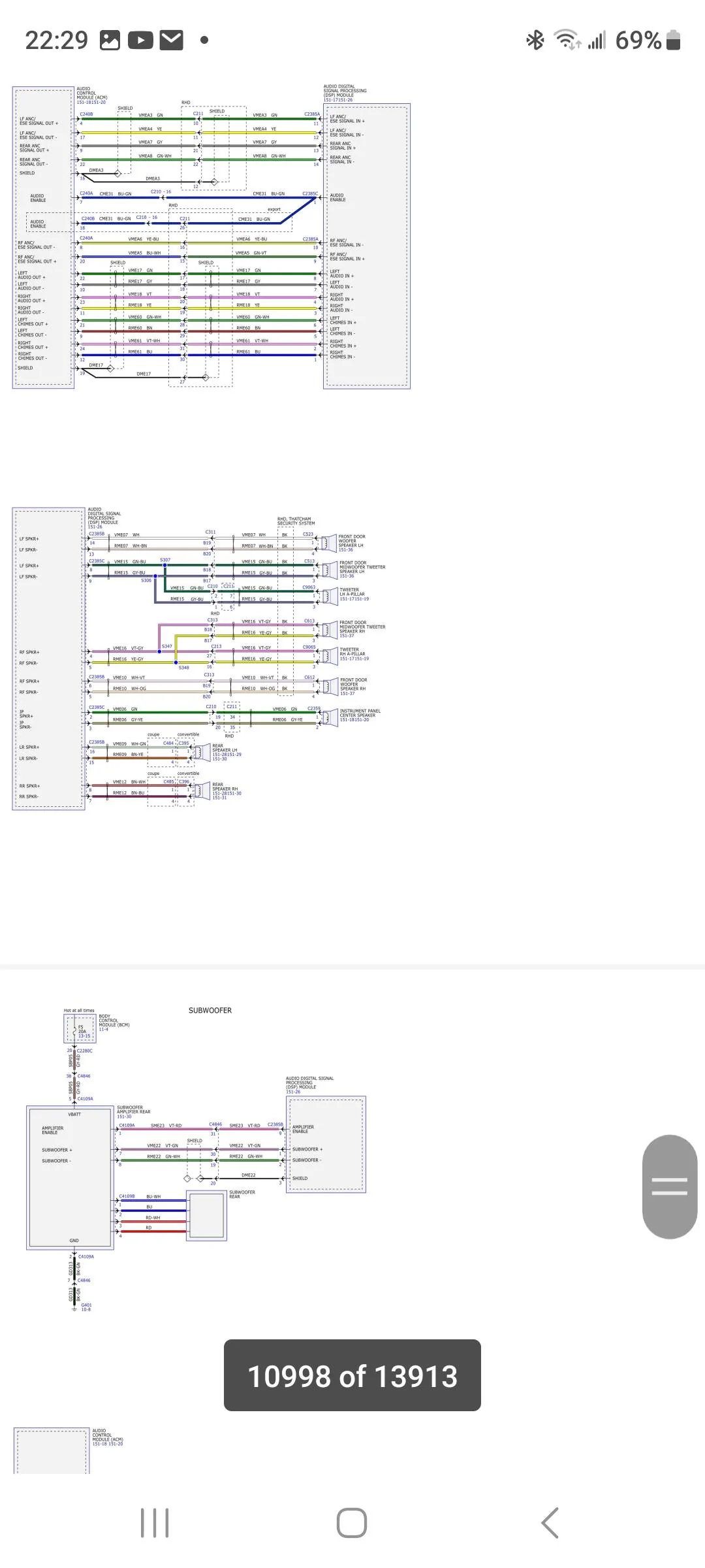

I have spent most of the day removing (I will try to post picture) of previous owners "upgrade" to the audio system (it was crap). I am trying to go back to stock.
Basically, I had to cut/solder all the speakers back to their factory positions and I missed something.
Does anyone have a wire diagram of the non-premium sound for a 2016. I do not know which pair of wires is amiss.

Thanks for the diagrams. The wire code just does not seem to match what I have. It is the RR speaker and what they have as BR/BL .... not even close. I dont have one of those at all. Ill keep at it. It is a pain to redo a pair ..... put back together....test...take apart etc. I appreciate the help though.
And yes, ..... go back to stock. Because it did NOT sound good. My 17 year old daughter would not listen to it. Like I said, with only three corners working last night, it was quite an improvement over what it was. Dont know why, it looks like a quality Kenwood system. As you can see....there was a lot of wiring involved (which continues..sadly).

I found the offending speaker wire. All fixed. I have no desire to rattle the windows out of the houses as I pass by. So now the stock set-up is just fine for now. I really sounds a great deal better. Perhaps the speakers could not handle the 1000 watts being jammed through them. You could not even hear music before, just a jumbled mess of noise.
