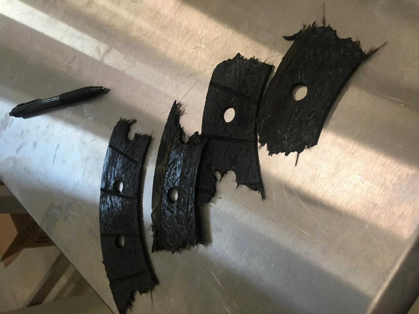

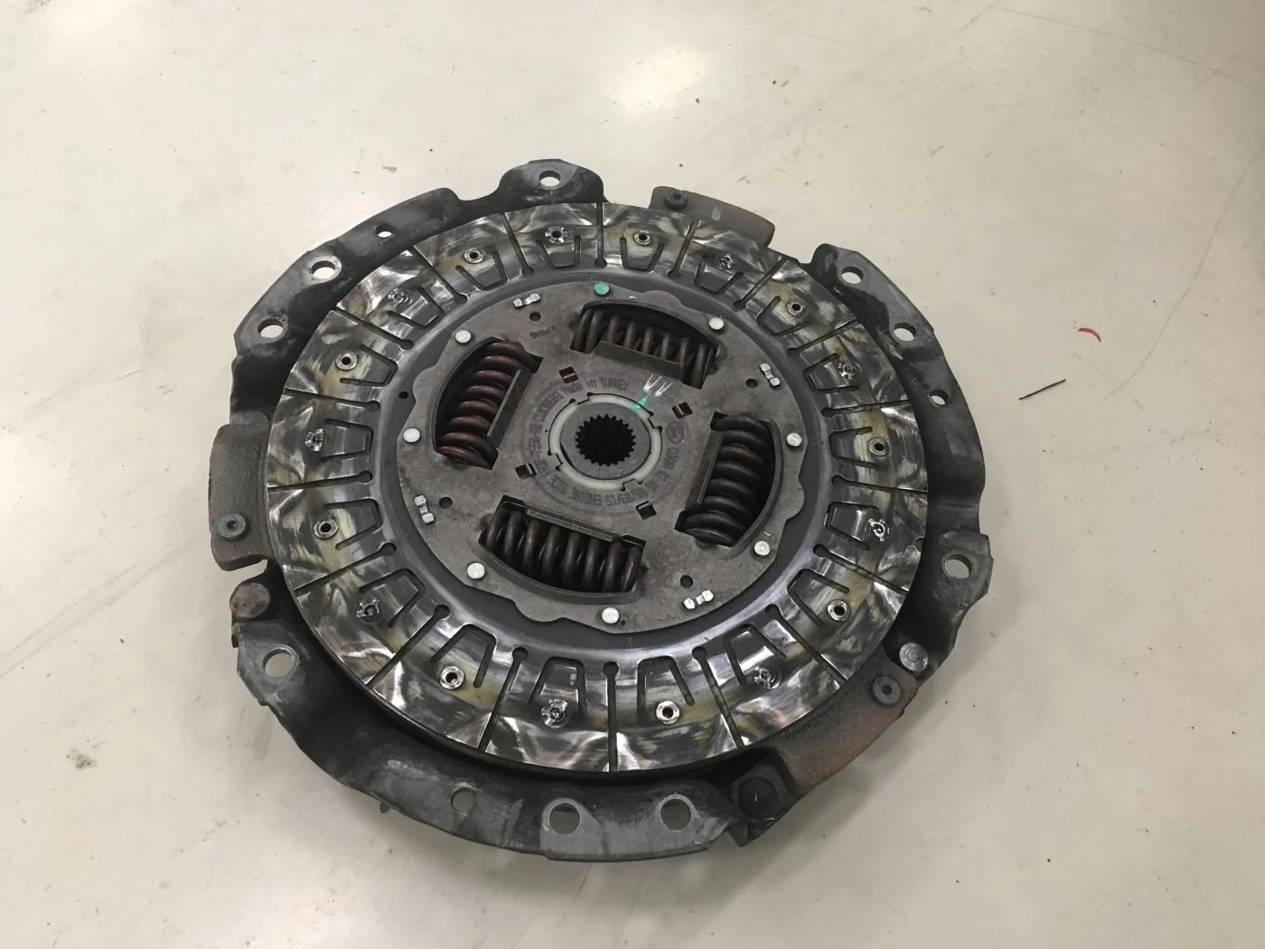

Same thing happened to me. I made the 3-4 shift and I think it actually went into second. The shifter came straight back but as soon as I released the clutch the RPM red lined and the back tires started sliding. I blame it on the extra torque from my Whipple and the soft transmission mount bushing causing the shifter to be out of alignment. I bought a Mantic clutch and the new Barton shifter. Mounting the shifter to the transmission will definitely get rid of any alignment issues. The clutch goes in Monday, I'll be sure to take a look at the stock one. If I had to guess it looks a lot like the OPs...

Here's what mine looked like... All the friction material fell out of the bell housing when the pulled the transmission.
