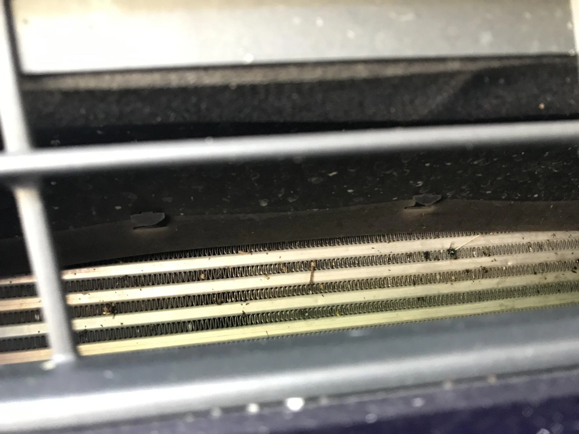

I have a 2018 PP, which appears to not have grille shutters on the upper but has a shutter on the lower.
If removing the shutter how do I avoid a check engine light?

You can remove the actuator motor from the shutters after removal, plug it back into the harness, then strap it with zips behind the bumper out of sight. Also, even though it will throw a code if not plugged in, it will no turn on the check engine light.

Is there a plastic flap like this. Is this a shutter?
Lol I remember that, I honestly don't know what it was, I sort of thought it was to just direct air to the intercooler. I did not reuse it as it did not fit my new one. However I had nothing that was left unplugged, no codes, no lights that I am aware of.
