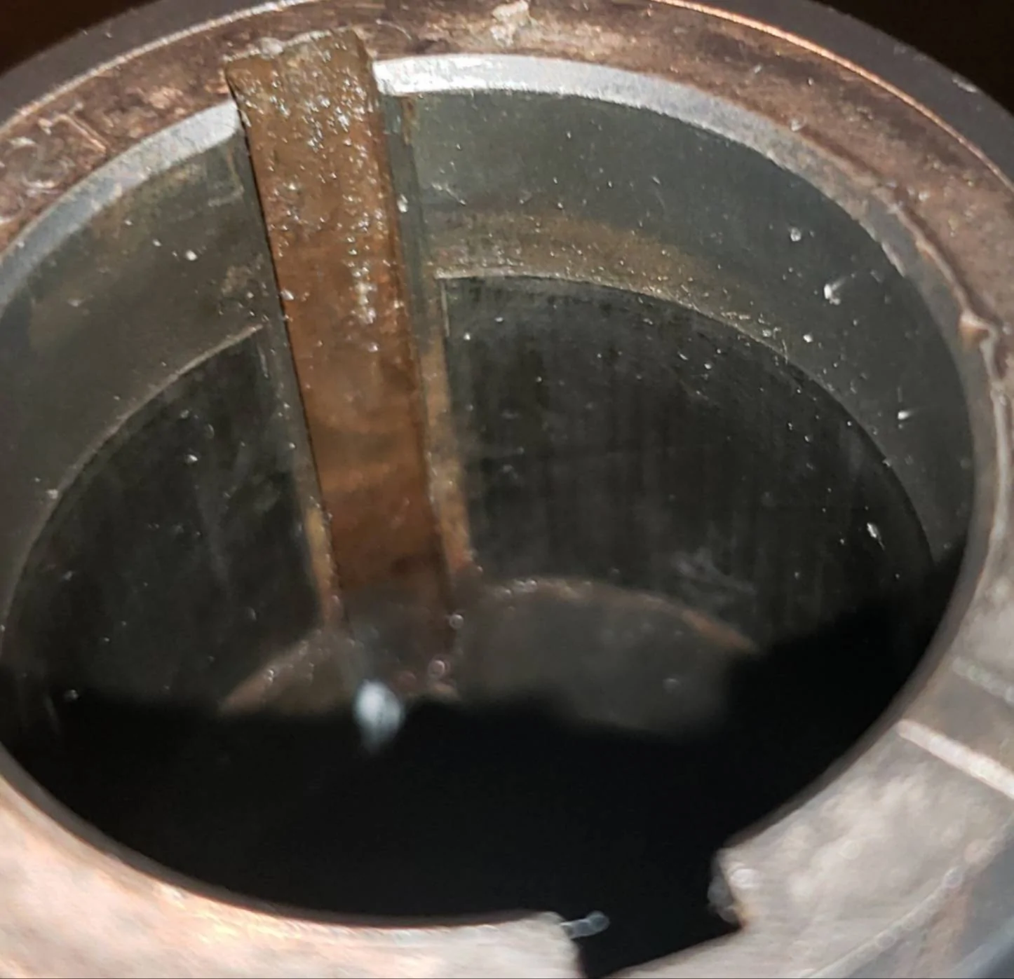

I've ran my ATI balancer on my gen 1 for about 7,000 miles with a ton of abuse. When L&M was building my engine they failed the hub upon inspection and installed a new one. The hub clearly had a ring groove worn into it. I think if I kept on going with that balancer hub i would have had a crank issue.
Broken cranks are not a Procharger issue. They are an ATI issue with n/a and all power adders having failures.
