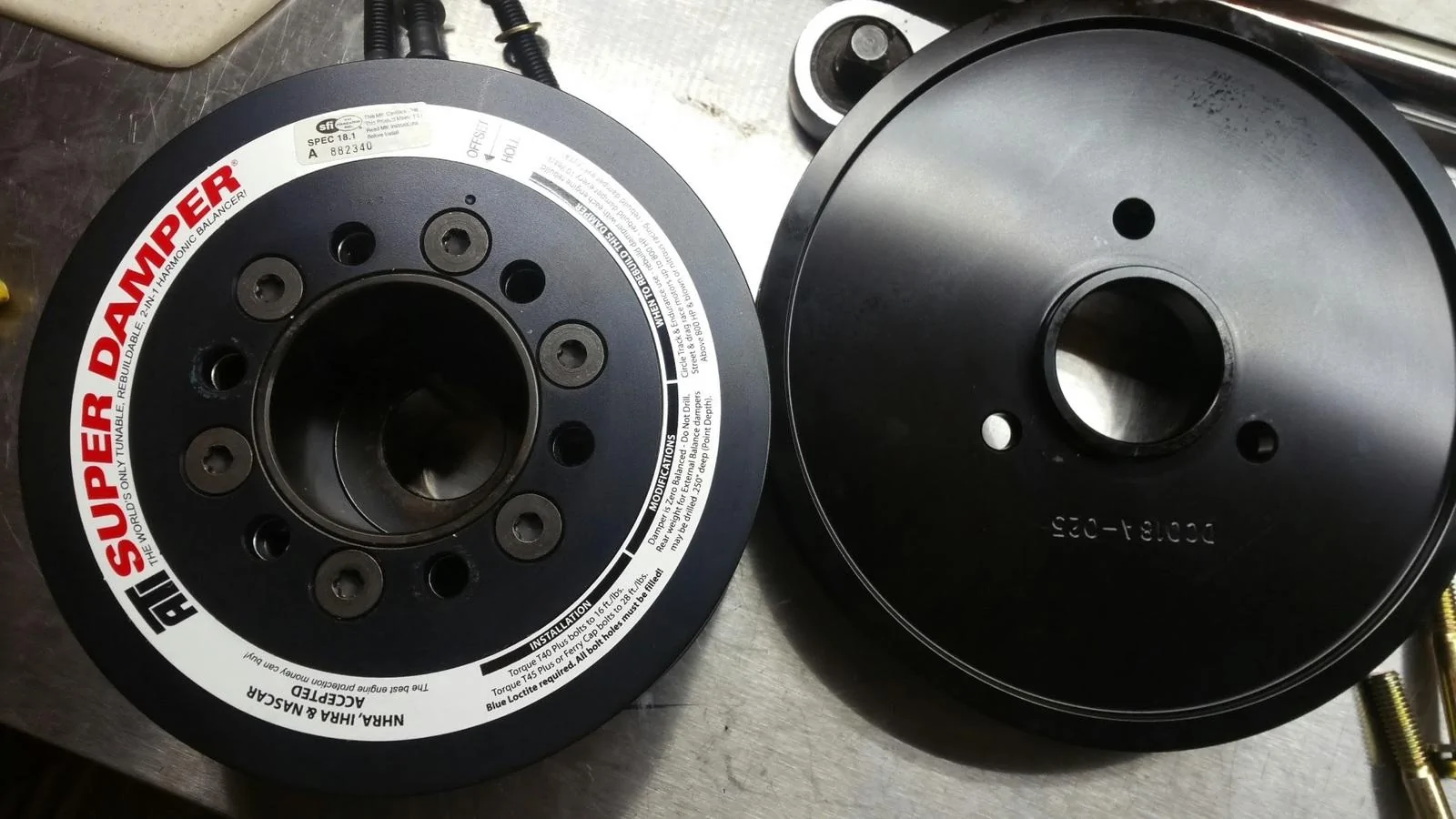

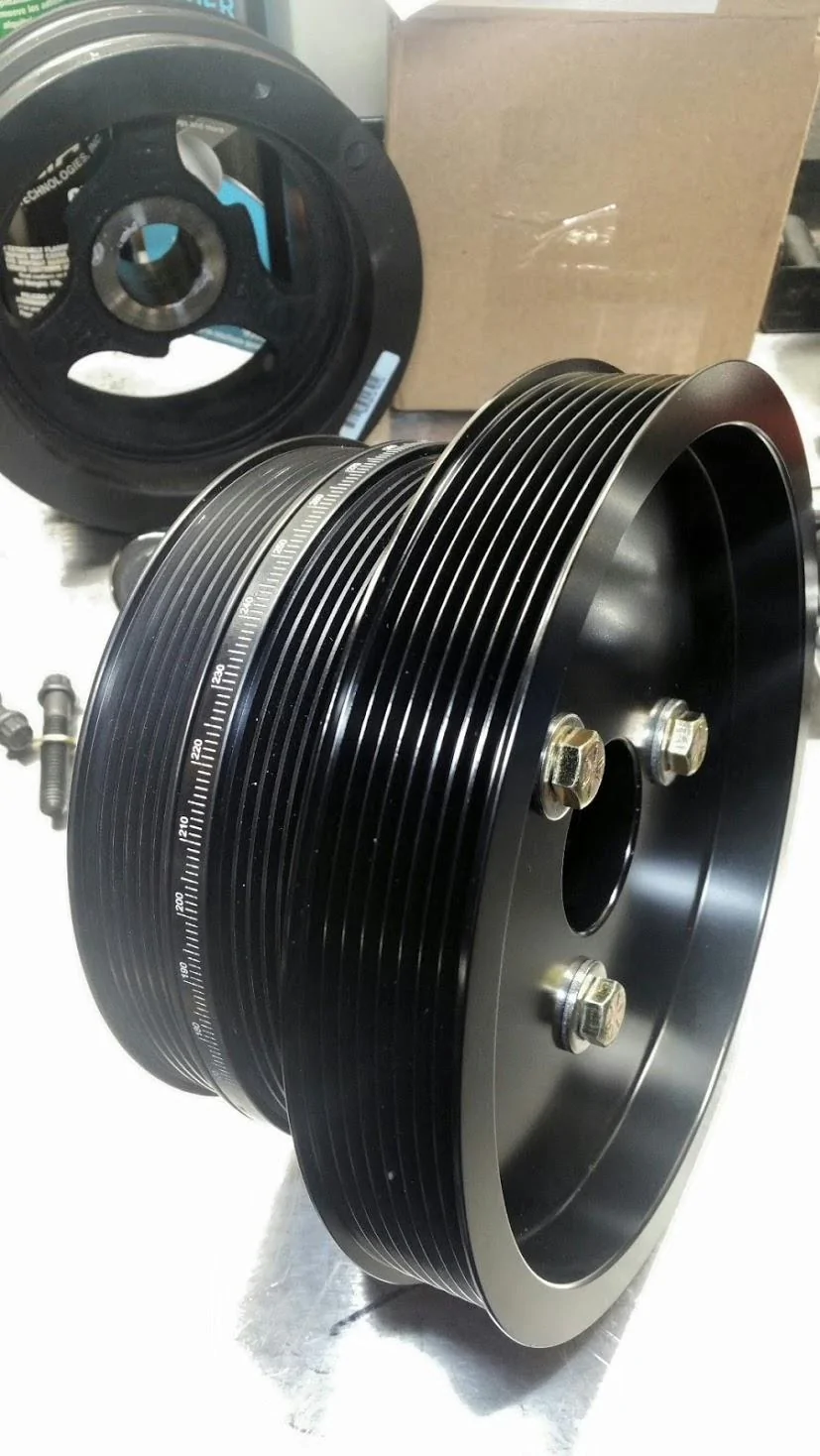

So, I ordered the pulley that goes with the ATI damper from procharger and there is only one way to install it by sandwiching it through the ati damper and the a/c pulley. I was surprised to see that it's not hub-centric with the ati damper and relies on the three bolts to center it? Also, it could have been drilled with 6 holes, so you could use all the bolt holes in the ATI damper? And, it looks like to install it, without moving the front swaybar, I will have to install the damper and a/c pulley first, then lower the procharger pulley into place and bolt it up? Anyone else do this?

How much did all of that run you?
$459 for ati damper (comes with a/c pulley)
$224 for procharger pulley for ati damper. Or it's included in the procharger kit if you specify it.

Hello do you happen to have more pics of how you installed the ati damper and pulley
