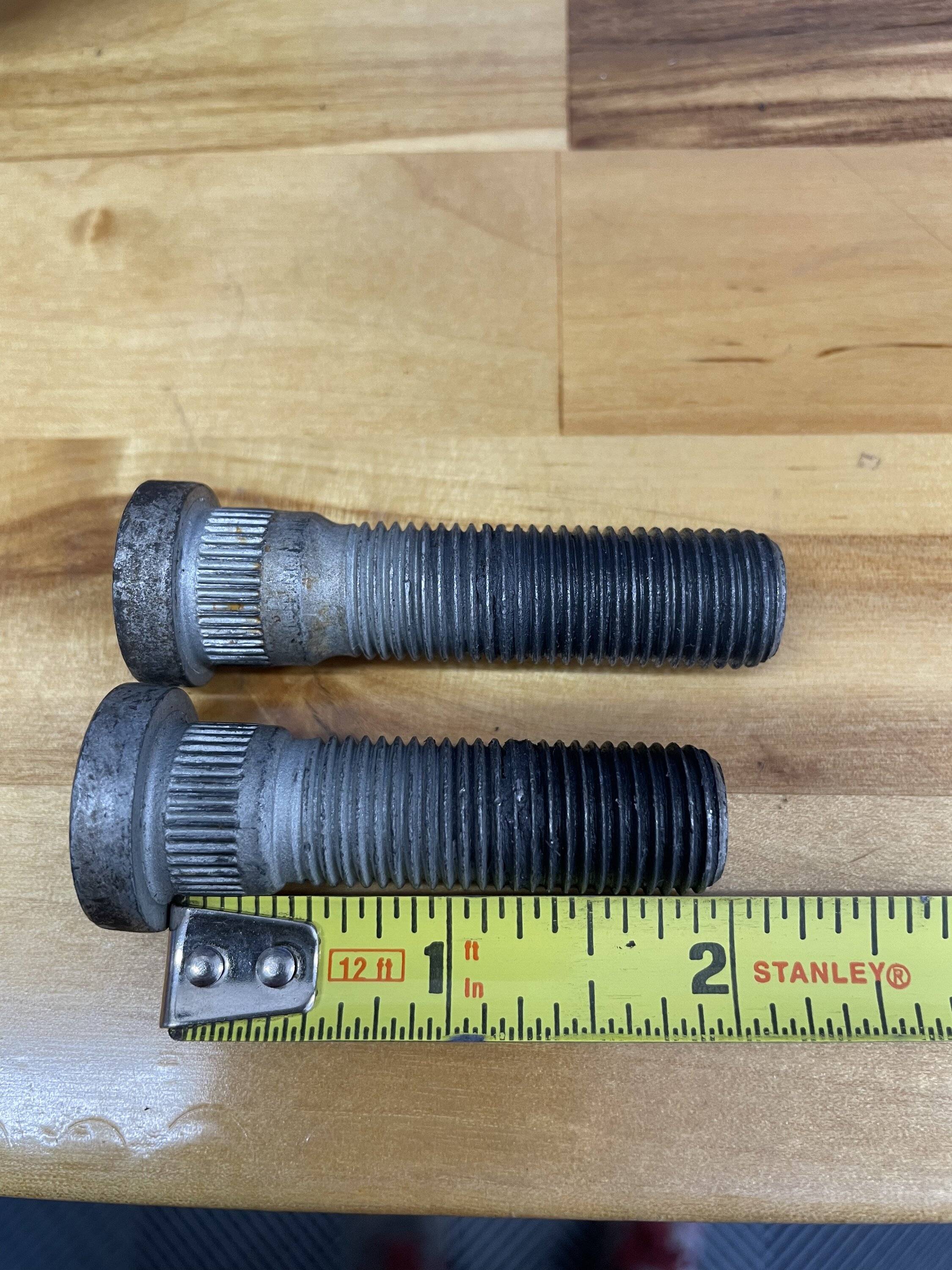

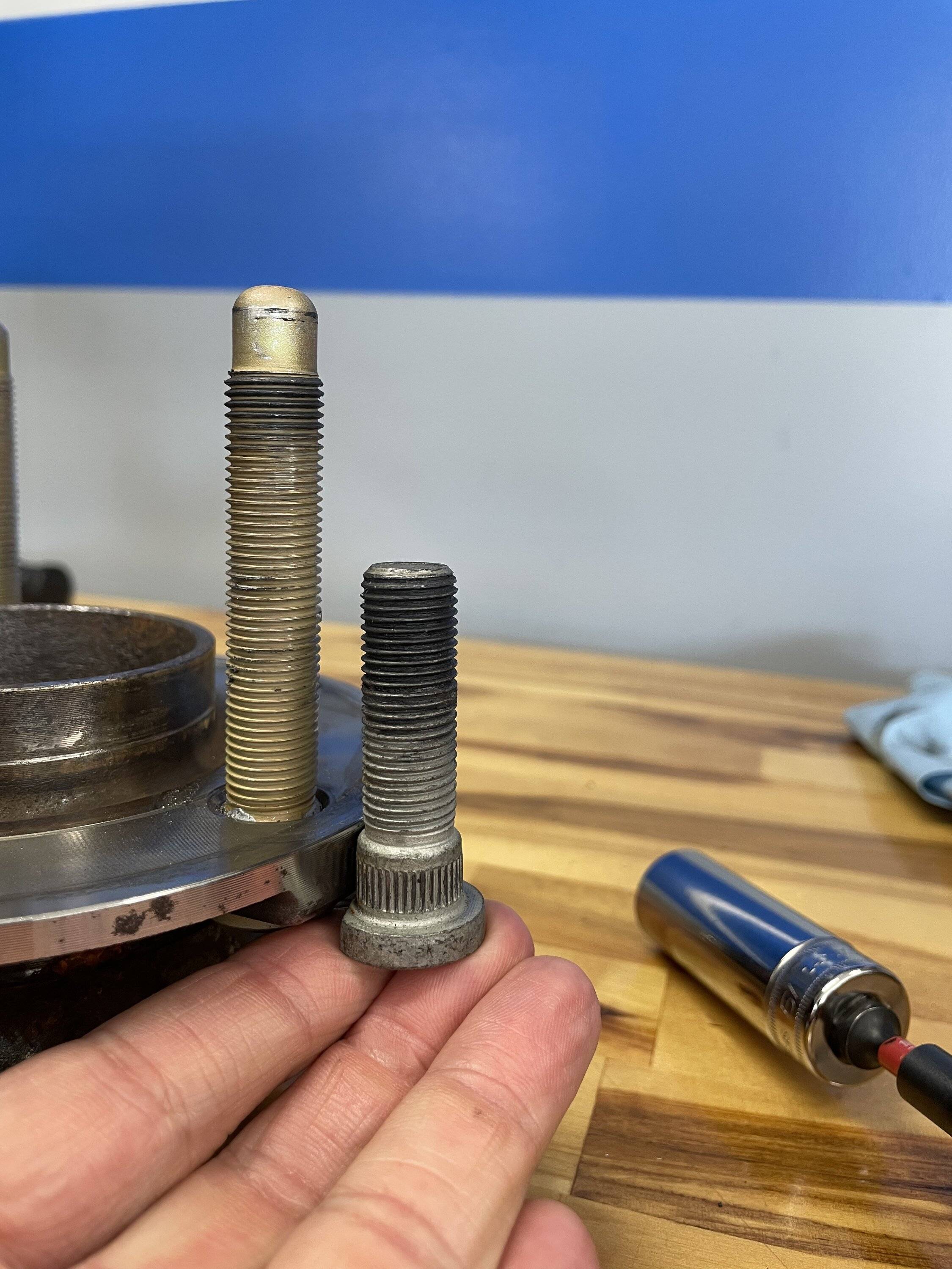

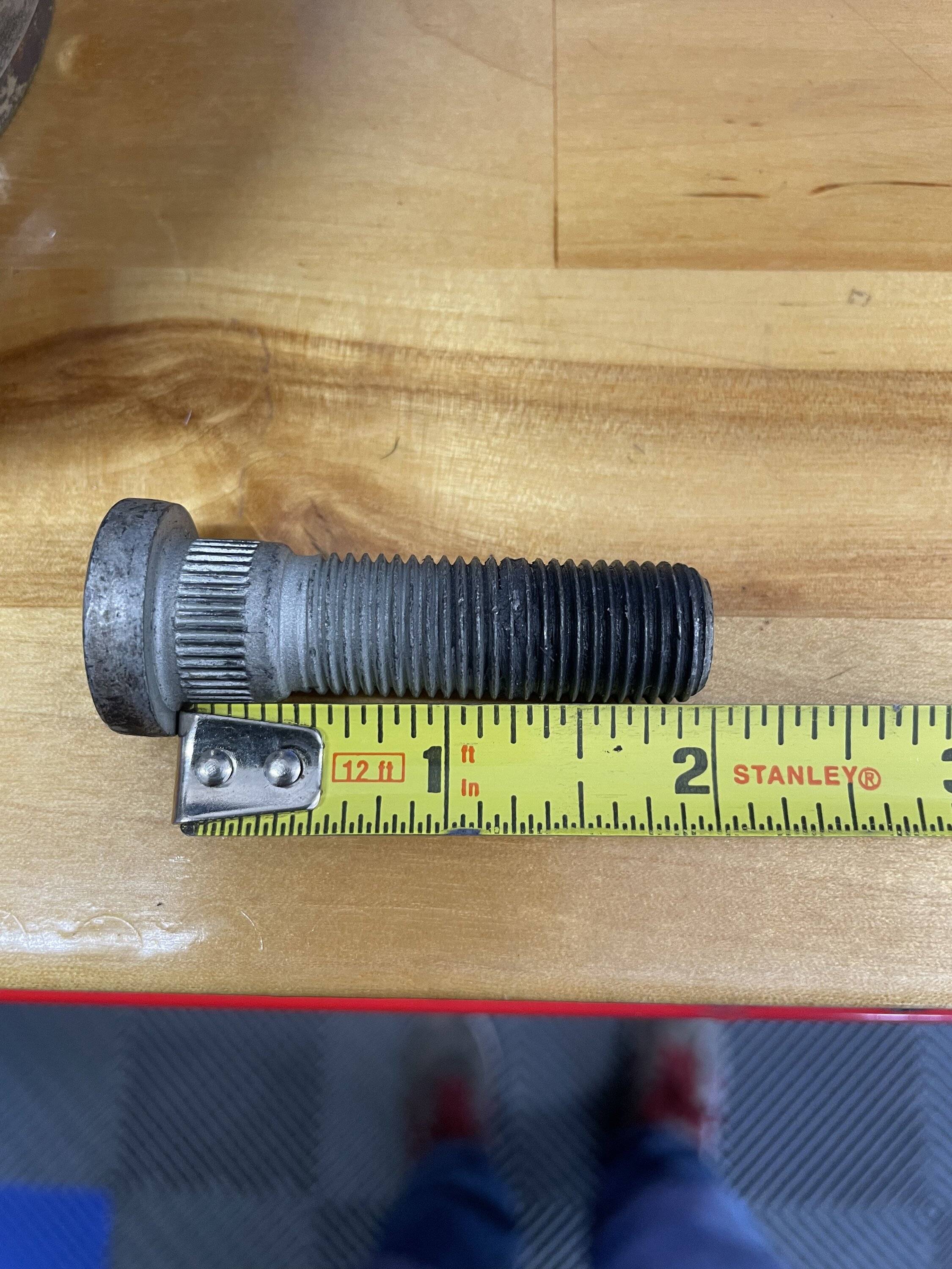

@Angrey While I completely agree figuring out these UHL’s has been confusing, this was not the source of my error. I never checked the length of the stock stud for a comparison. I looked at how much empty lug nut I had (1”) and just went to town. My bad.
Here’s some pics to help out. The stock rear stud vs 7733. I threw in the stock front stud just to show the additional confusion as they also are not the same length.
