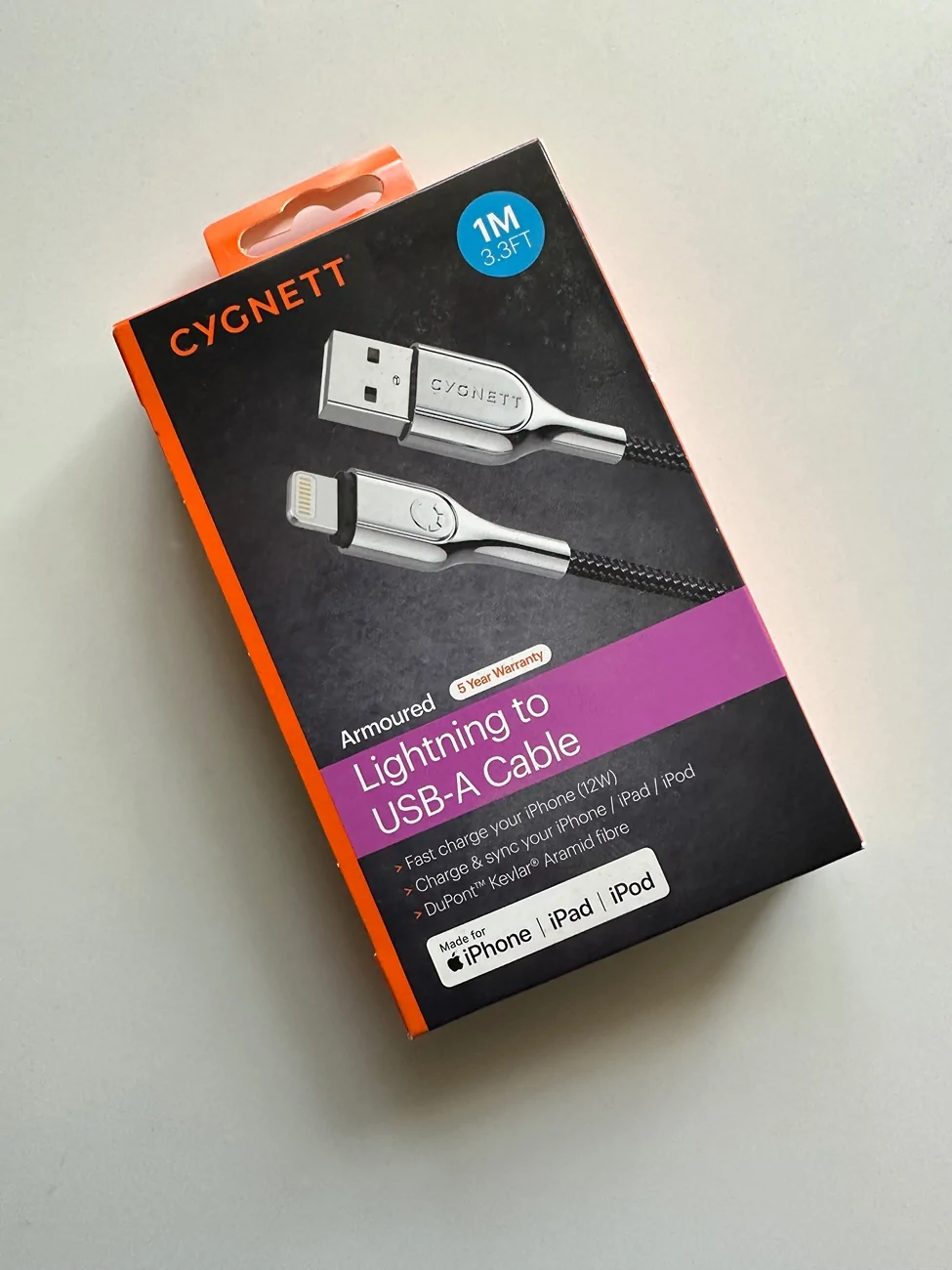

So… I went and bought a brand new aftermarket cable and thought I do some experimenting.
the bass rolls off in the exact place as the original cable, so I’m ruling it out as the cause.
It has to be the Apple CarPlay algorithm, which I have tested as having a 24db at 65hz high pass applied.
so… Apple CarPlay wired in has no bass…
This probably wouldn’t be noticed on OEM systems, but anyone with an aftermarket sub/amp combo would definitely notice.
